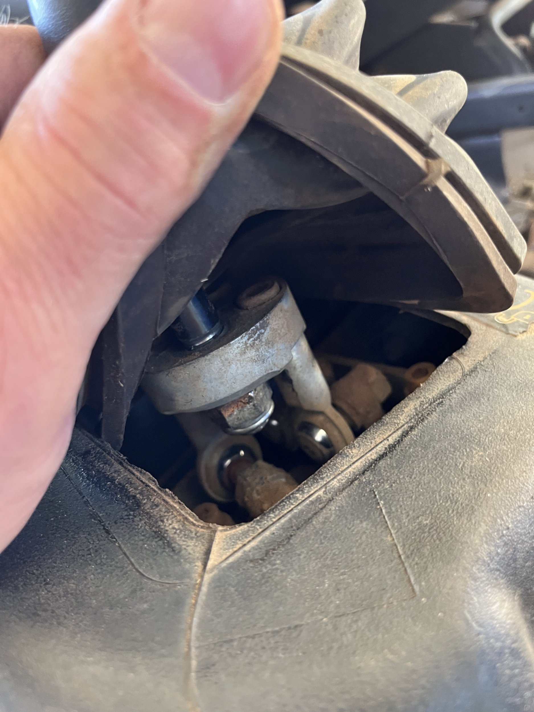

Does anyone know what thread size / pitch the joystick has on a TC series hydrostatic drive tractor?
Mine is loose and I think a jam nut is going to be the best way to fix it rather than loctite.
   / TC45DA Hydro Joystick #2
Ha, I had same problem 8 years ago and just used a bolt that seemed to fit and it has worked flawlessly ever since. Your ‘bush fix’ does work I’m happy yo say!
7/16@ by 20TPI aka NF thread.
