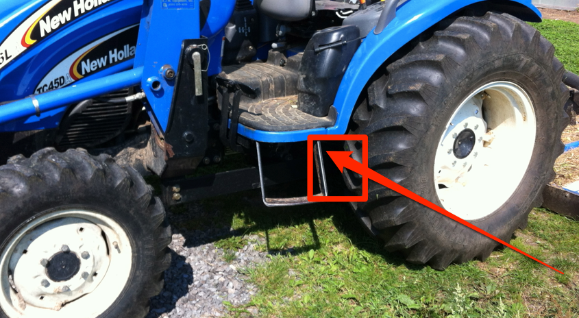

Look under the left side operator's platform for a loose wire going to the rabbit/turtle solenoid. That would give you those results and is something that has happened to me 4 or 5 times.

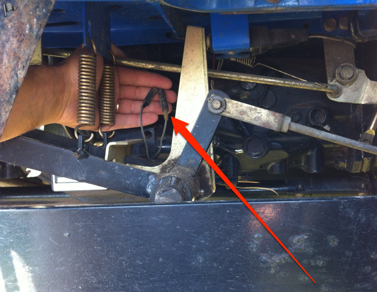

I was a bad community member... I posted for help before I even looked at the tractor (because I was so hot I just sat in the barn with a fan on and used my iPhone)... But I had it fixed as soon as I explored the wires - it was EXACTLY what jinman thought (before he even thought it!). But in the interest of helping future folks who search for the turtle / rabbit lights working but not changing ranges - here's where you look on the tractor and what the offending connection was. They are simply friction fitted plugs on these wires and one got pulled out. I did add a zip tie under there to hold the wires up a bit... they just sort of naturally dangle there and makes me REALLY surprised this hasn't happend before.
