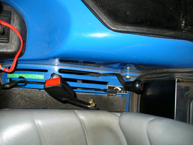

Can those who own a TC55 help me out? Can you tell me if you have a separate lever to engage draft control? I recently purchased a new DX55. The specs listed it as having draft and position control. I'm familiar with draft control when it uses a separate lever, but my DX only has a position control lever. My tractor was built after the 2/2007 changes, and I'm wondering if they cut draft control as an option. My owners manual has one sentence regarding draft control, at the end of the Hydraulic Power Lift section. It simply states "The hydraulic lift system is equipped with draft control". No diagrams or other explainations. I read in another thread reagarding the 2400 searies that draft will not be an option. Maybe they missed that one sentence in my manual when they updated it this year.
I'd like to know if I have it so I can use it.
Thanks for your help.

I have an empty slot next to the position control lever, directly to the rear of my 2 rear remote levers. I thought that slot was for a 3rd remote if I added it. Looks like that's an feature they cut on the new models as of 2/07.
   / TC55 Draft Control? #5
Well... so I went out this morn and took a pic!

   / TC55 Draft Control? #7
My tractor was built in february and it has the draft control and its a TC55DA. Maybe the DX tractors they changed before the TC

   / TC55 Draft Control? #9
My 1987 2120 which basically shares the same chassis as the TC55 also has a 2 lever draft control system To enable draft control you also need to pull the locking pin on the "rocker" arm where the upper link of the 3pt hitch connects so that it can "rock" and sense draft load.
Andy
   / TC55 Draft Control? #10
Andy
Same deal on the TC55
~paul
