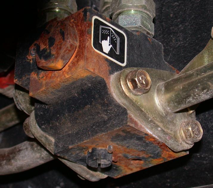

   / TC55DA - Where is 18LA loader hydr. pressure adjusted?
schmism,
Finally got around to taking a picture. Kind of looks like what you described earlier. See pic.
I assume it involves turning the big bolt on the side. Anybody know the details on this? Turn clockwise? counterclockwise? Anybody know what the adjustment on the bottom is for?

   / TC55DA - Where is 18LA loader hydr. pressure adjusted? #6
I am almost positive from looking at it that, that is a relief valve you will need to shim.
Normally a relief valve that you just screw in or out to adjust will have a jam nut or something simular to lock them from loosening.
Pull that big one out and take a pic and post it. (be prepared to catch the oil)
Brian
   / TC55DA - Where is 18LA loader hydr. pressure adjusted? #7
Don't turn that bolt clockwise!! As cobra said, it's not a adjustable knob. It's a cap. Loosen it and there is a spring pack and shims underneath. Add a shim to increase pressure. I'd check the pressure first. My loader has a adjustable relief as well as the same diverter block like yours.
   / TC55DA - Where is 18LA loader hydr. pressure adjusted? #8
Item #12 are the shims.
#9
shaley,
Thanks for the blow-out drawing. The shimms look like nothing more than some flat washers. Anything special about the shimms? Think it's something I should get at the dealer or can I improvise?
Will I only lose the oil in this contraption or will the hydr. lines also get drained?
   / TC55DA - Where is 18LA loader hydr. pressure adjusted? #10
Nothing too special but they are steel about 0.010 thick and soft stuff like brass will get beaten to death. Not much oil comes out when the cap is removed (tractor off of course) just keep the area clean as grit will cut the o-ring. Tell the dealer you want the shim back that he removed.
Also, like Sounguy said, have you checked the loader valve for it's own relief valve?
