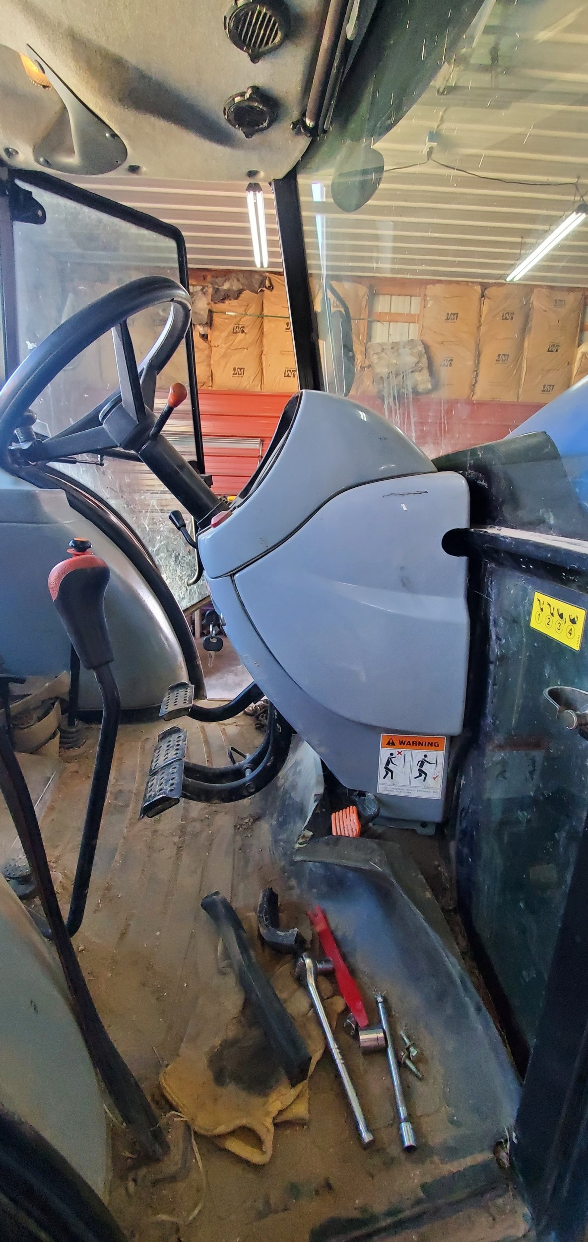

Need to replace master cyl. Can't even find it.
Looks like it may be behind lower right dash panel, can't even get that off. Got 3 bolts out of it and still barely moves.
Any help appreciated

Remove the instrument panel. There are bolts inside there that need removed as well. If you unplug the flashers mark the wires first. Otherwise good luck hooking up correctly. I have had the dash apart on my td95d.

I'm not sure on your tractor but all the recent NH's I worked on there is a pin connecting the master cylinders to the brake pedals. Also many of them will have a cross-over line connecting the two master cylinders. As well as the hard lines going to the actual brakes.
   / TD 5050 brake master cyl #4
Yep, this doesn't show the reservoir lines or the actual hard lines for the brakes;
