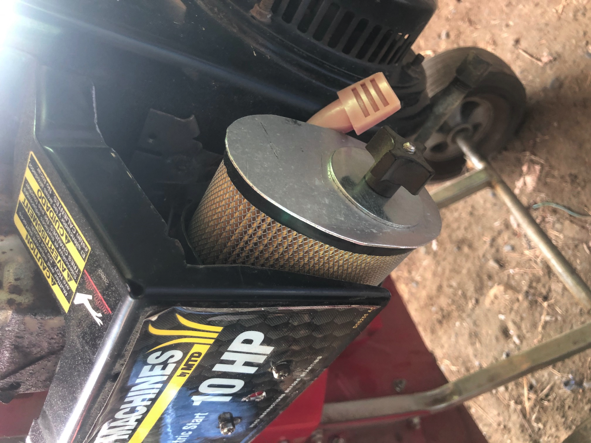

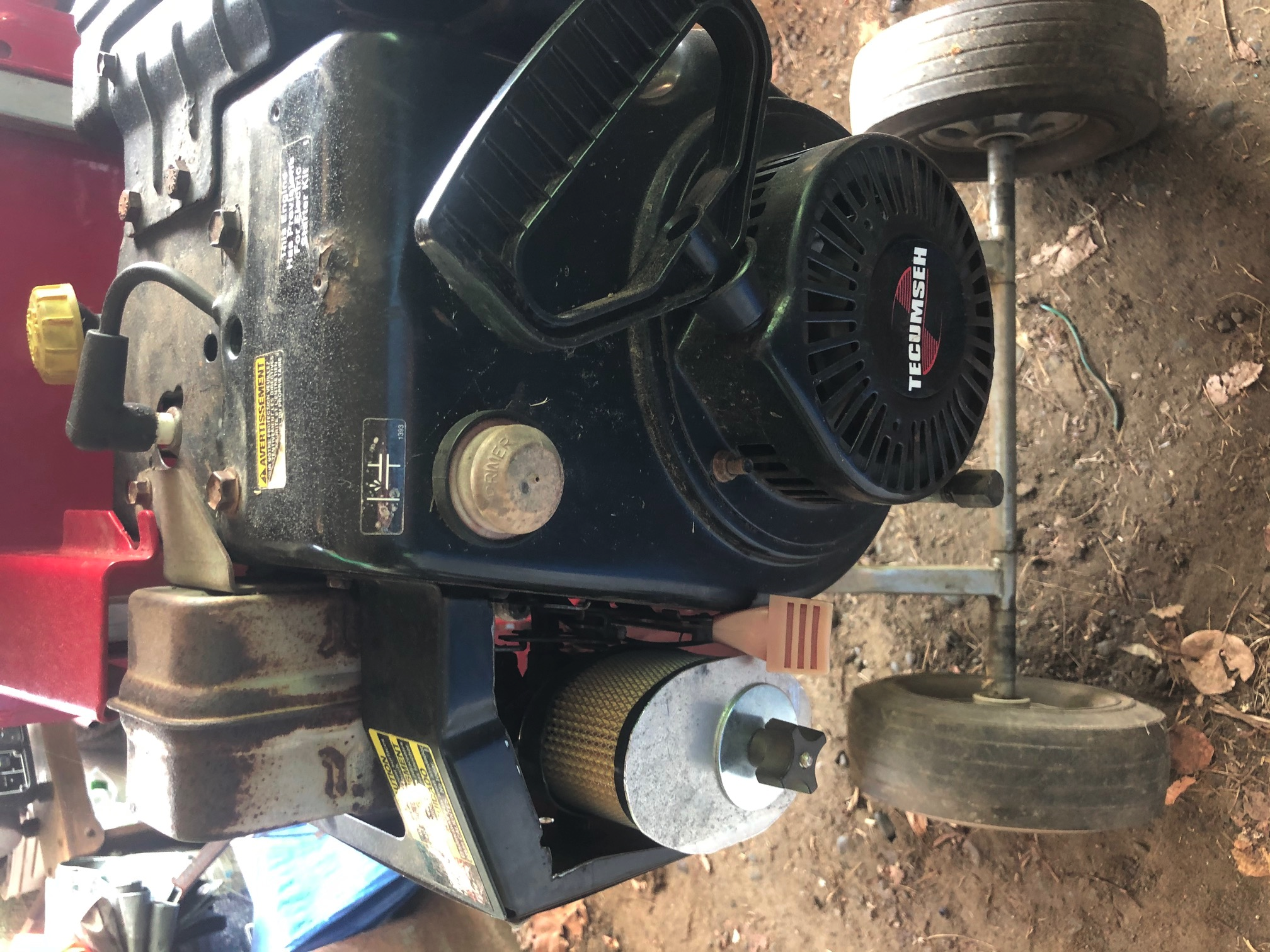

I found one today that I can make work with a little modification.
   / Tecumseh 10 HP air filter #6
OK great. After you get it installed, post a photo. We all like to see what other people are doing.
Richard
#9
Great, looks good.
Nice work.
Wish I could have put the cover on the filter but not enough room because of the throttle lever. I guess for what little I'll be using it I can replace the filter when it gets dirty.
   / Tecumseh 10 HP air filter #10
You could put one of those foam dust covers on it.
