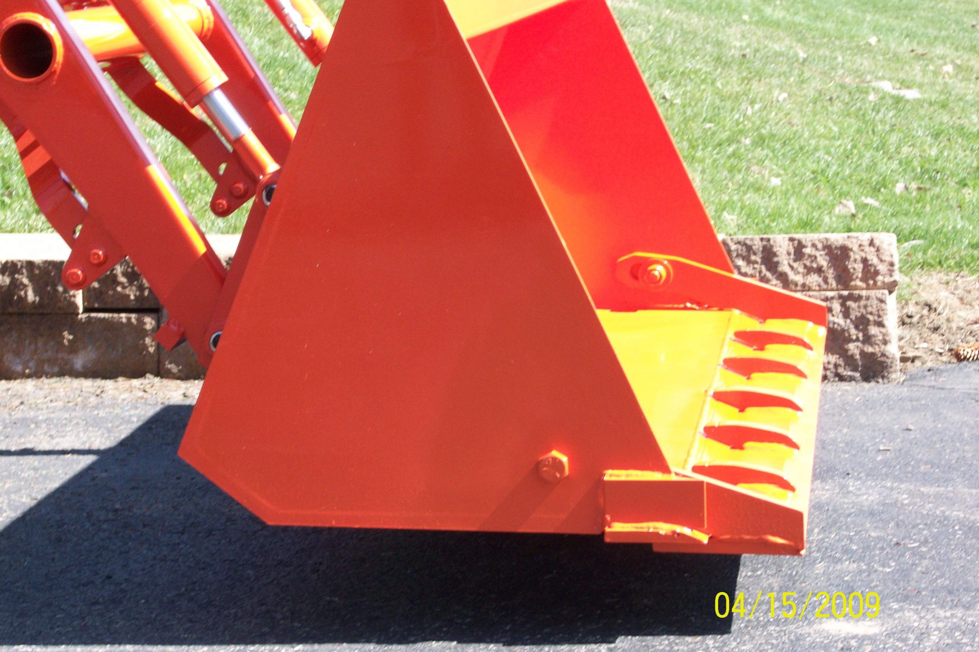

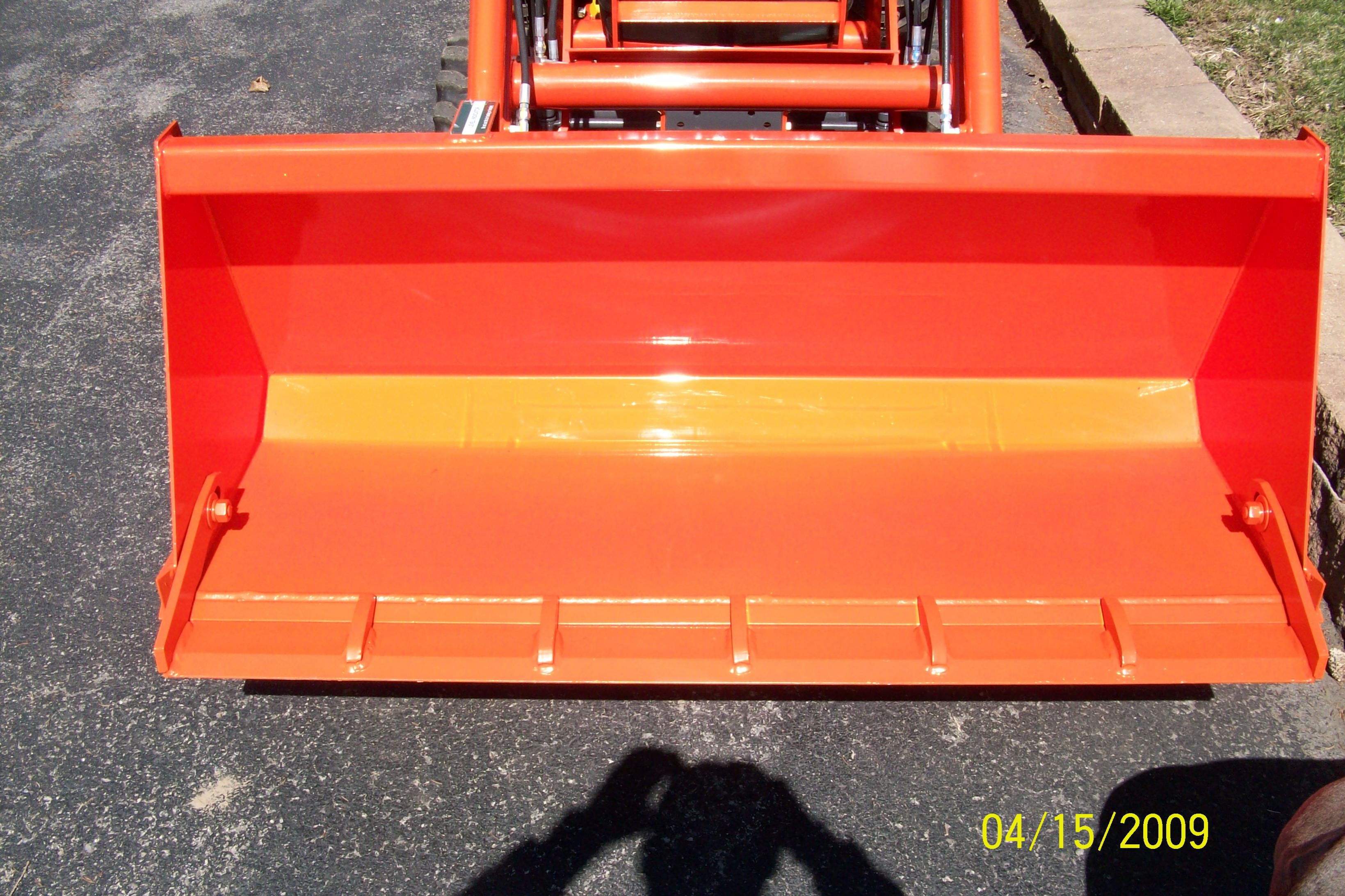

I purchased and installed what is called an bucket edge guard.:D It's kind of like a reverse tooth bar. I had installed one on by BX23 and liked it so well that I just installed and painted one on my new B3200 TLB. It protects your cutting edge of your bucket when plowing snow on blacktop or stone driveways. It also helps when your trying to pop out rocks that seem to grow in lawn. But I really believe it adds strength and about 5" to your buckets edge. If you can see in photos you can too hang items from teeth.:rolleyes:

Wow devildog1...do you WAX that bucket!!! I have not seen one of those edge guards...where did you get it from??
