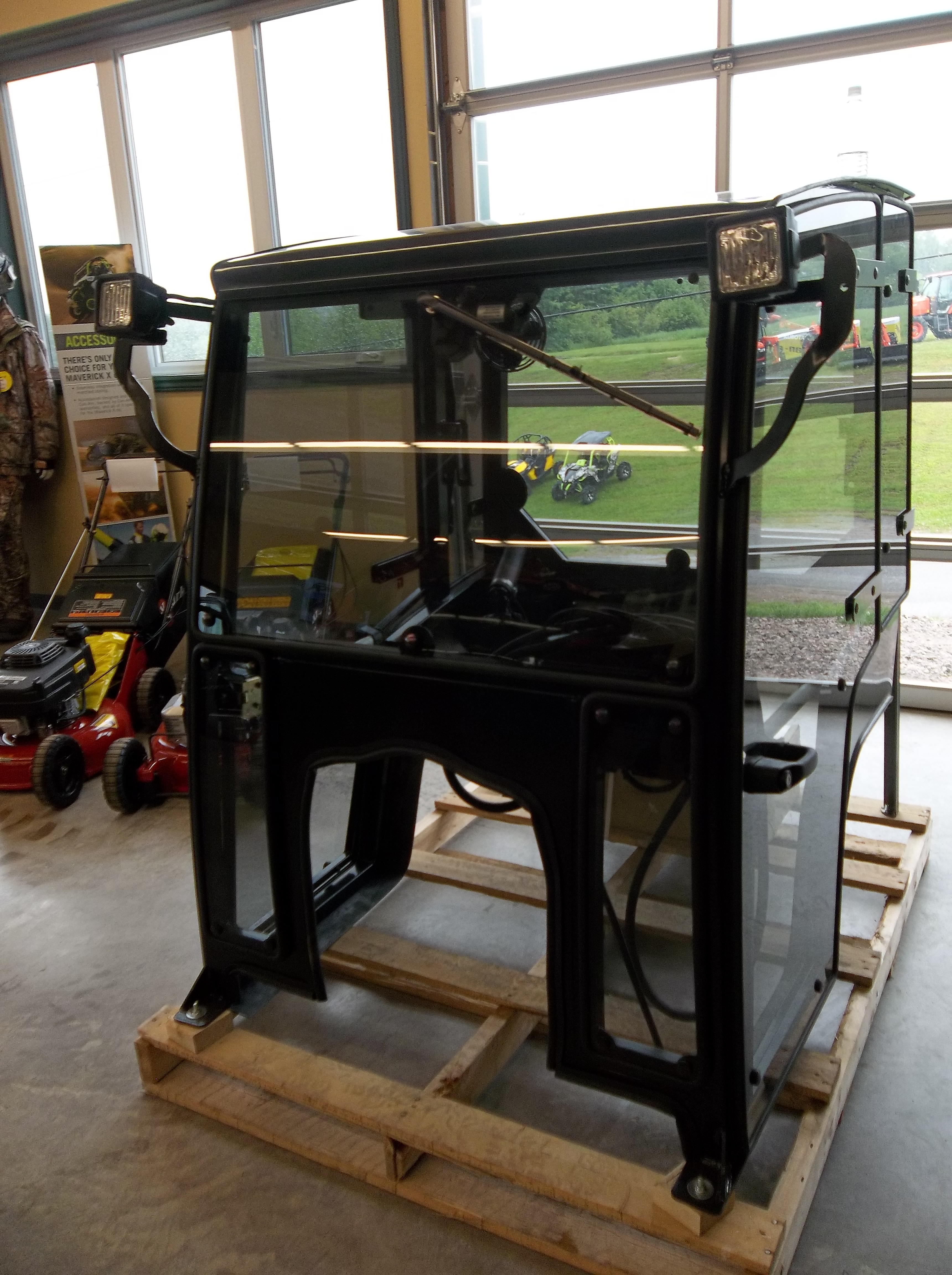

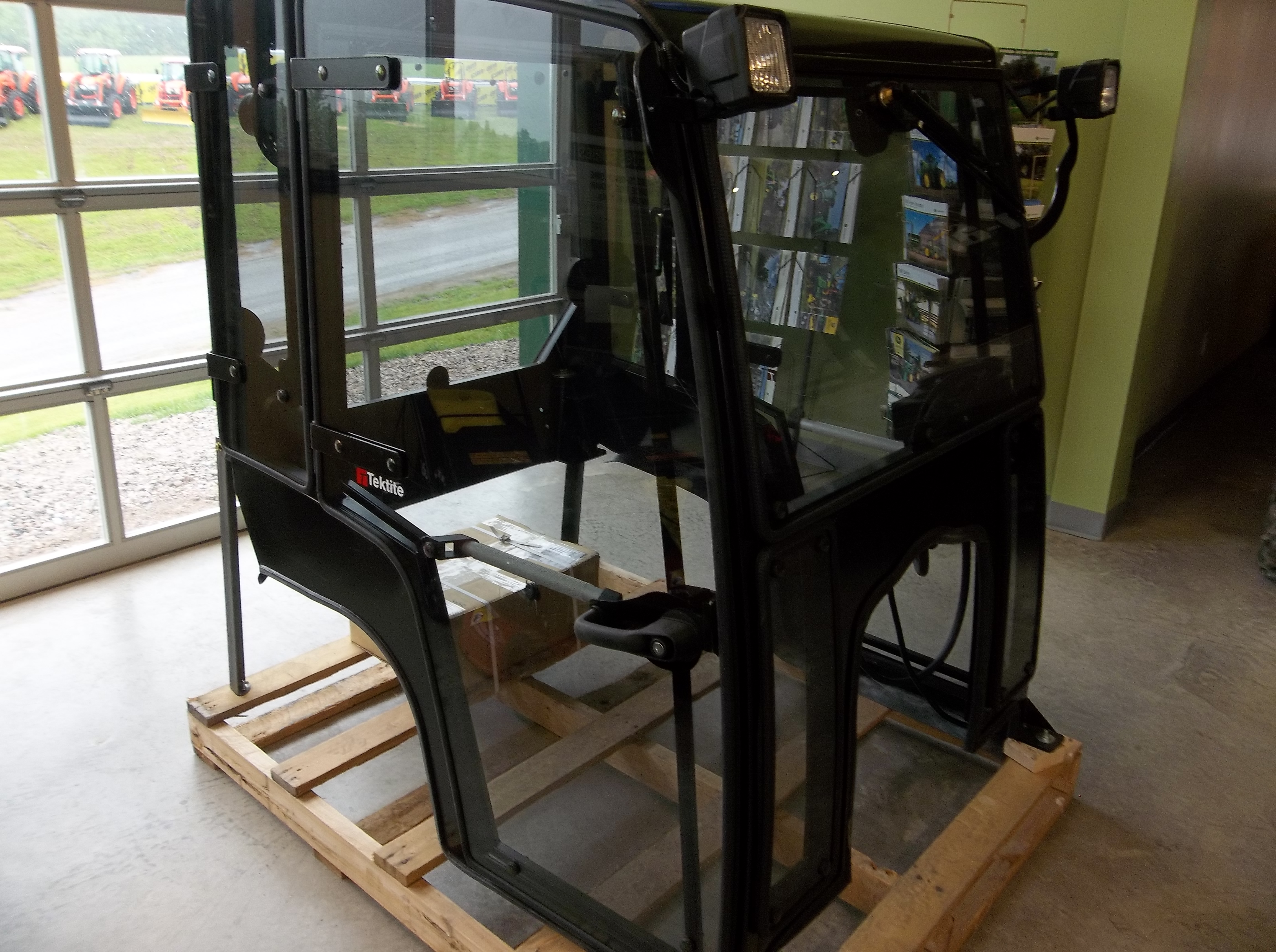

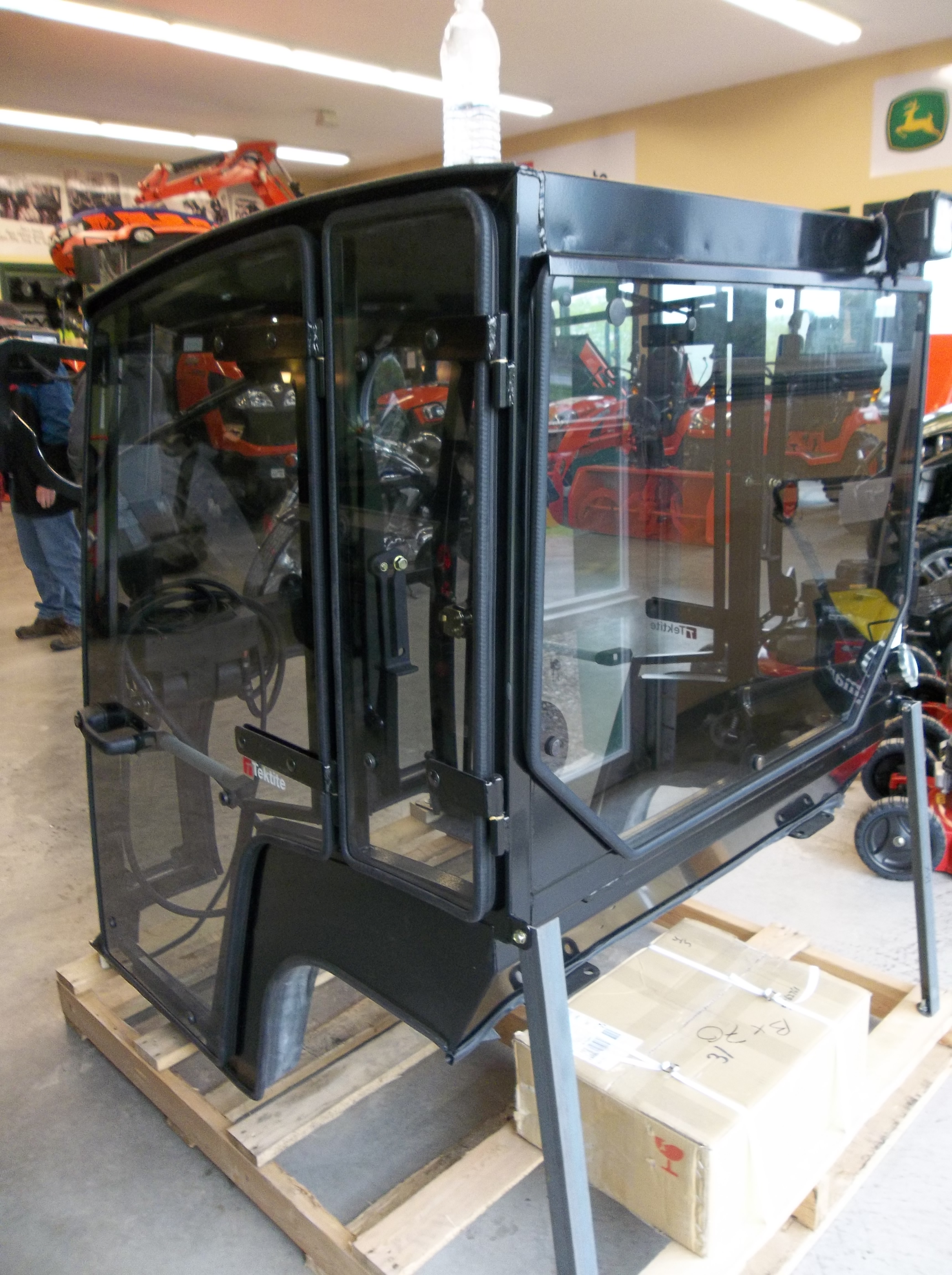

My JD/Kubota dealer used to sell Curtis cabs, but they have now switched to pushing Tek-Tite. They said they really like them and the quality of them.
Here's a basic black one for a BX they had sitting on the floor.
