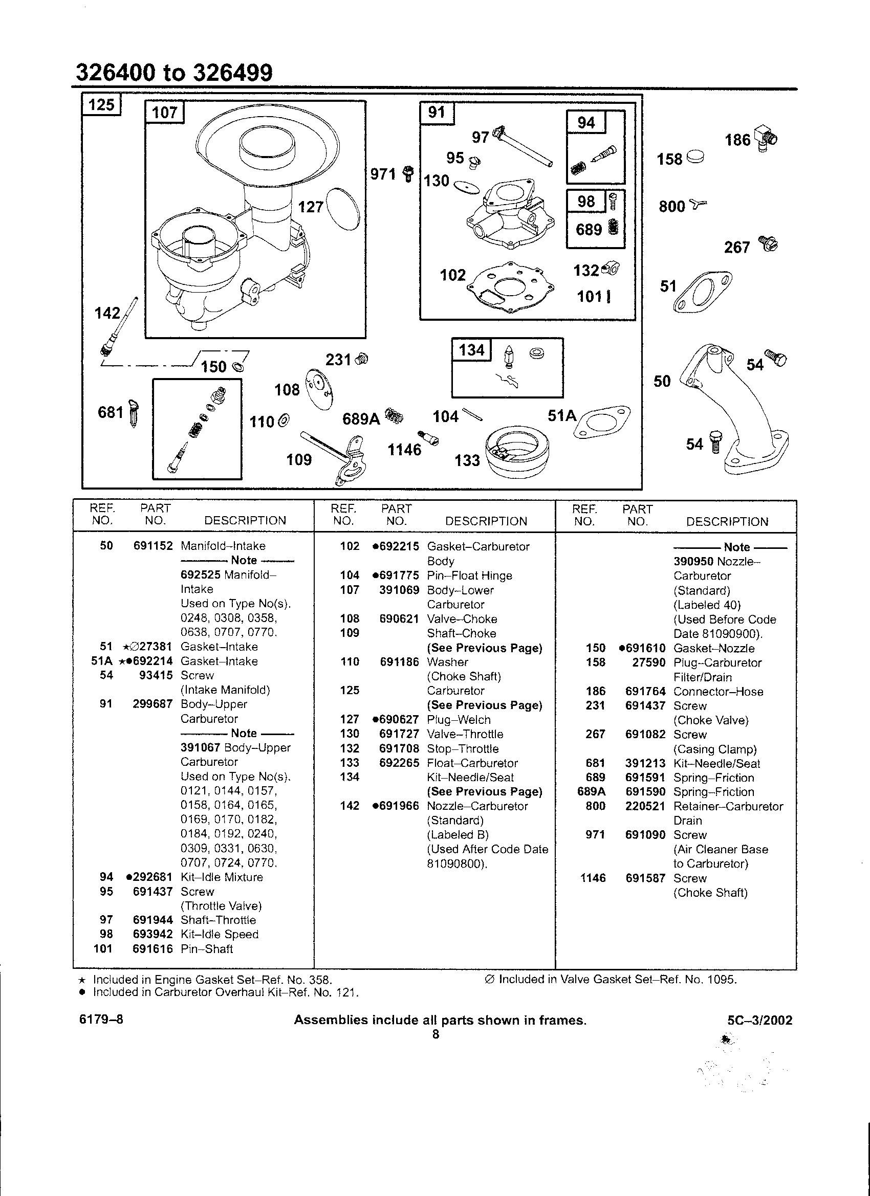

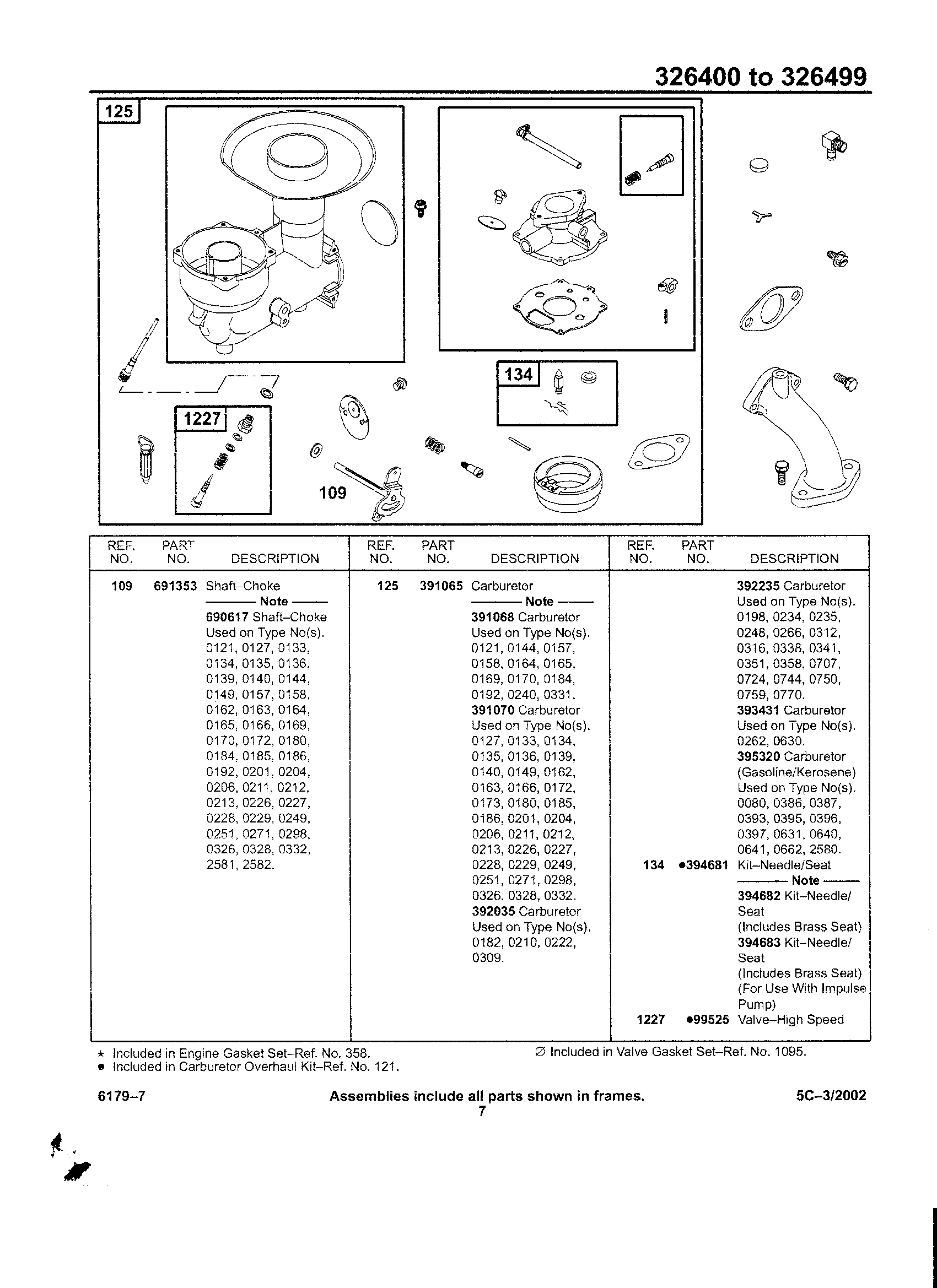

thanks dmace for your help. here is exploded view my carb i work alot on boats 2&4-storke maybe it is idle mixture#94 i just assume it was air mixture screw because it idle is condtrol by the govenor.and the screw for that is #98. #1227 is high speed or fuel screw. let me know if this is the carb you were thinking of.here what I did today lower the float(bent the tang up very little)same thing but the shut off on the tank is a screw in type so if I only open it about half way it good with a few pop at throttle up.note I'm useing 1/4" fuel line

That's definitely a different carb then the norm but all the basics are the same. #94 is your air/fuel mixture screw that determines how much fuel goes in, that should be 2.5 turns out to start with then you can fine tune by plug color. #98 is your idle adjustment screw and should be set so that it is just keeping the throttle stop (#132) open a little. Since it runs good at WOT I say your high speed needle (#1227) is set correctly and you can fine tune that by ear and exhaust smoke if needed.
Bending the tab up on the bowl float will close the needle sooner and keep less gas in the bowl, this would help any flooding problems if that is the problem. Careful though because with little fuel in the bowl, you can run out quicker then the carb can refill at WOT and if this is a mower or something that may be used at steep angles, it could run out of gas also.

Screw on side of carb is your idle (slow speed) adjustment; screw on govenor is idle set; screw on bottom of carb is high speed adjustment.
