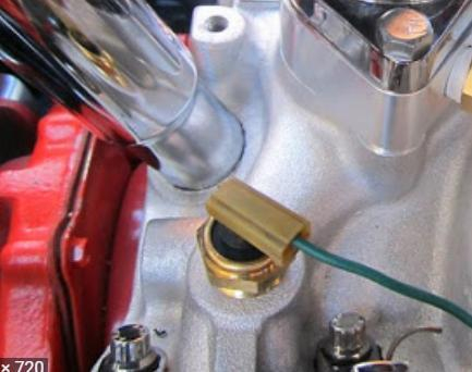

Temp gauge on m5040 quit working
Other gauges working
Where is probe or temp pickup on engine?

I had a problem with my MF GC 1715 temperature gauge and it proved to be loose screw where mechanical gauge mated with printed circuit board....
Most gauges are basically a volt meter, try disconnecting wire at sender in block and grounding it out to block if gauge moves problem is sender if gauge does not move trace wire back to gauge to be sure of it integrity before you just replace gauge.... Check all electrical connection for their integrity along the way...
Look for item that will look similar to this, it can be on thermostat housing or on head or engine block... Varies according to engine manufacture....

The temperature probe will frequently be found in the area of the thermostat. That is the location of the hottest water headed back to the radiator.
