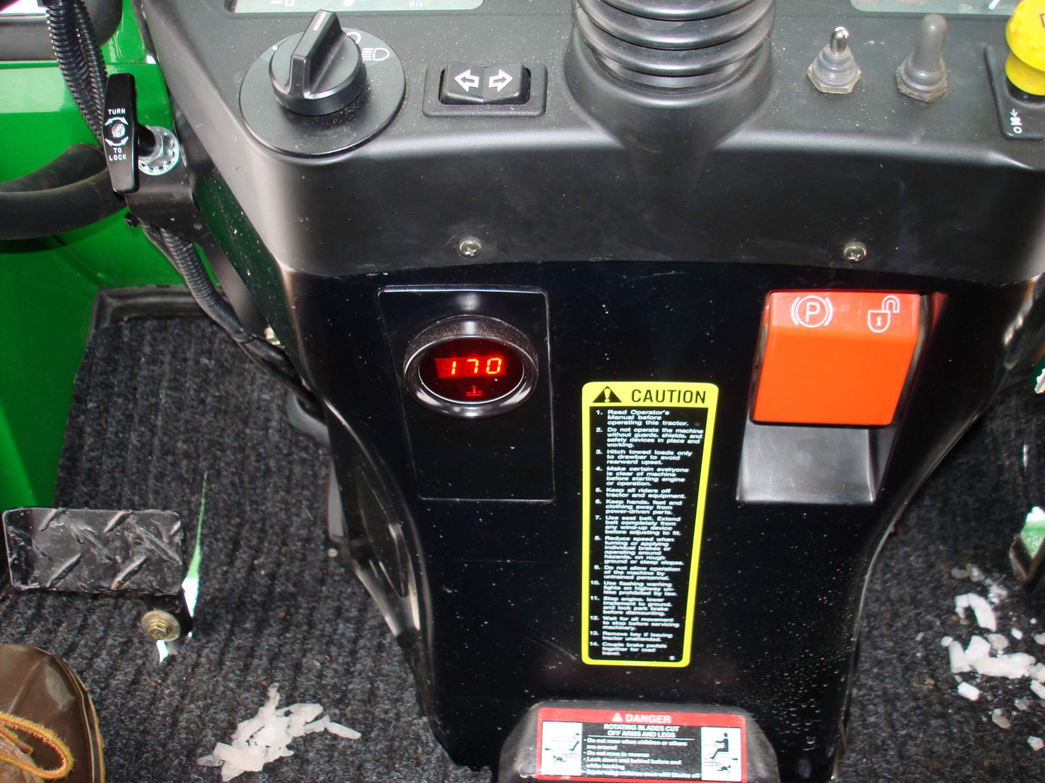

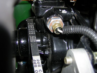

Has anyone put a temperature gauge on a 2210. If so were did you mount the gauge and where did you put the sending unit in the block.
   / Temperature gauge on a 2210 #2
Yes, Drilled and tapped the plug on the opposite side of the T stat housing.

I have been lurking a while here, can you tell me what the cable to left of your temp gauge is

The lever you see is the cable to adjust the chute deflector on the snowblower..
That's a fantastic addition to the tractor LR... thanks for the pics. :)

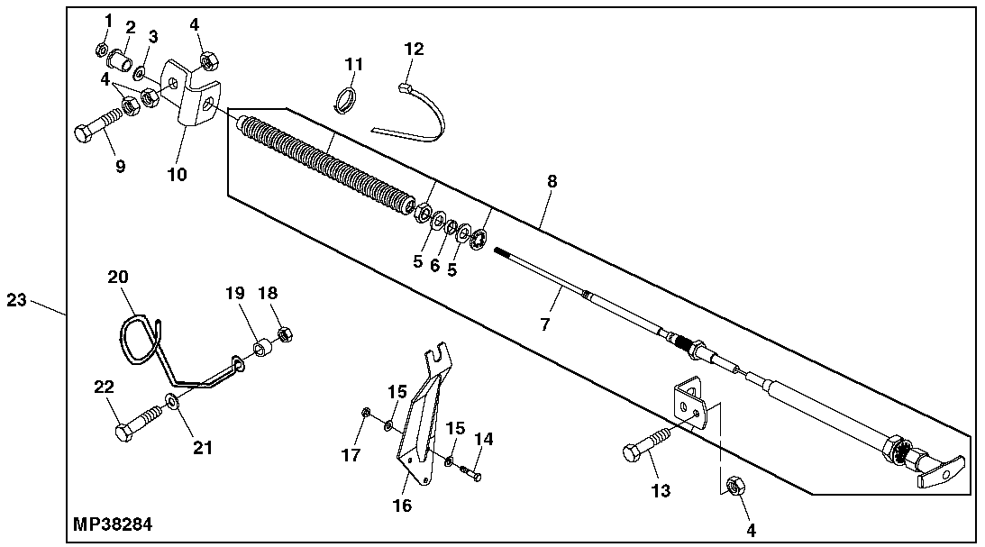

Is that a JD part, if so do you have part #
Thanks
Chris
Here it is:
LVB24958 KIT 1
REMOTE SPOUT CONTROL (ALSO INCLUDES 19M7139, (2) 24H1685, M90887 AND E64256)
You will have to get a price from the dealer though...

If I remember the kit was just over a hundred bucks but that was 5 years ago. I think it consisted of 2 kits. 1 was the kit shown above and the other was the mounting bracket for the side of the dash because the main kit was for a 4110 and the bracket kit was for the 2210. That may have changed by now.
