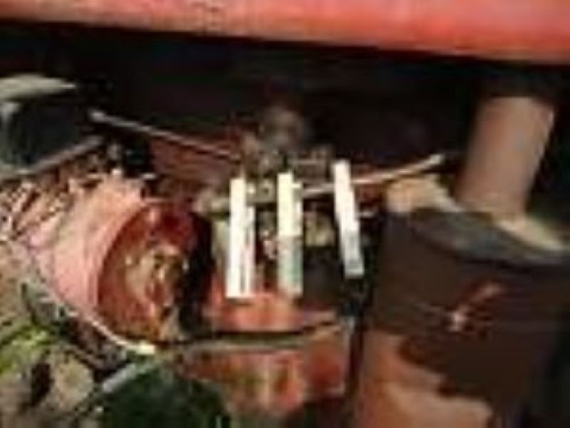

Can you put a temp gauge on a Farmall Super A? If so, how?
   / Temperature gauge #2
I did it by installing the sending unit in the upper radiator hose. Used a piece of metal threaded to match the sending unit inside the hose and a washer on the outside for the unit to tighten up against. Was still working fine when the tractor was sold. I got the idea from a kit I once saw.
   / Temperature gauge #3
I'm not sure it's worth the effort to put a temp gauge on, as the thermosyphon system is quite efficient, as long as the coolant is at the proper level. You'd have to work it very hard on a hot day to even worry about it. But if it makes you feel more comfortable, knock yourself out.
I pulled a 4' rotary cutter mowing 4' tall grass years ago with my Farmall A on a 90º day. It vapor locked before what I would call "overheated". Mainly from heat generated from the exhaust manifold. I remembered an old trick Ford guys used on their cars and trucks from the early to mid 60's. Went to the house and got 3 spring type clothes pins, put them on the fuel line and it ran fine the rest of the day.
