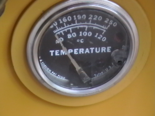

Dash Gauge reads 100 at all times
Is this a sensor or gauge failure ?
Tractor doesn't run hot, but I want to fix

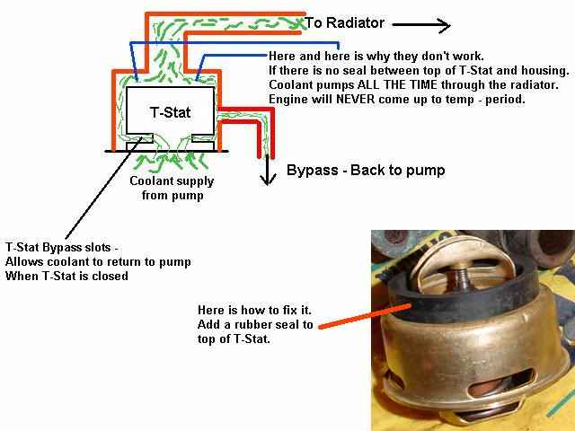

Also, is there a aftermarket thermostat available ?

Is the gauge stuck on 100 all the time, even when the tractor is shut off?
if so then it would be the gauge.

Yes, gauge is on 100 (Left Side) all the time, running or not, or parked, never moves

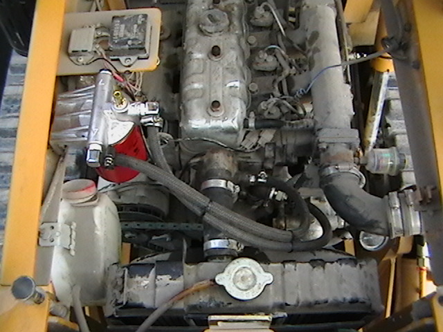

I installed a coolant filter. System is squeaky clean. Also running a furnace air filter in front of the radiator. Also running the NAPA thermostat. I also have the TY395 engine.

Is your coolant filter system installed on a radiator hose or other application ?
Is furnace type air filter suggested if tractor never gets in weeds or brush ?
Tractor has OEM screen in front of radiator, & it's clean

I installed the coolant filter in the thermostat by-pass line. I guess if you never get in any dry brush or lots or heavy dust then the furnace filter is probably not necessary. The rust, scale, and casting sand trapped by the coolant filter greatly improves cooling system efficiency and prolongs coolant pump seal life. To prove my point, weigh the new filter element before you install it, then weigh it again after 30 or so hours of running. You'll be amazed. I had to change mine about every 50 hours at first because it was getting full (cool to the touch).

Neat Install, Bob R

Well, I figured out my gauge is shot, The coil inside is broken & the tiny wire is uncoiled
(Wonder how that happened)
