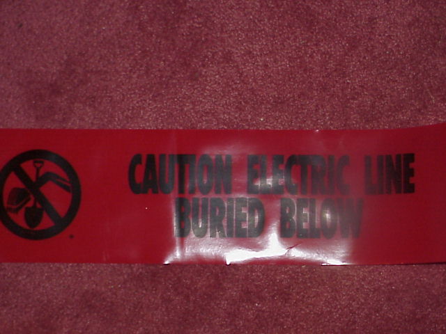

Junkman,
I have never heard of or seen "red buried wire marker tape". Can you tell me a little more about that. It sounds like it makes great sense. I have a neighbor that just put in a couple of ponds with a connecting stream. He has buried more wire and plumbing in his backyard than you can imagine. I dug the ponds and stream and a few of the trenches for him and then a contractor took over. Nothing is marked and he has no markers or photos. I'd be afraid to put a shovel in the ground in his backyard now.
Greg
   / Temporary Electric To Shed Questions #6
a picture is worth a 1000 words....... I bought a 1000 foot roll a few years ago and it is a lifetime supply...... If it isn't electrical, I usually mark it with surveyors tape. I try to always take a measurement from two points and make a small map that I file in a photo album with other pictures of buried things around the house. It also has all my permits in it...

   / Temporary Electric To Shed Questions #7
I am going to get some of that tape to have on hand. That's a great idea. When I built my home 20+ years ago I took a lot of pictures of all the trenches. I even took closeups of critical locations with a tape measure in the trench. I have had to use those photos several times and they have saved me a lot of grief. But it sure would be nice to be able to dig into a piece of tape like that to know exactly where your lines are. There's no reason not to use similar tape over plumbing as well. Thanks for idea.

   / Temporary Electric To Shed Questions #8
If you don't care about the tape lettering to meet code, then you can buy the caution tape less expensively. I have used some that a friend gave me that said "crime scene - do not cross" to mark out some water lines.... the important thing is to have it marked. I also only back fill with either stone dust or sand.... that way, you will know when you hit that stuff that something is buried below even if it isn't marked......
