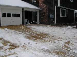

I've been building a shelter using 3/4 PVC pipe and lot's of "T" to create a shelter. I figure or hope to have it complete by tomorrow late. Will be 12' wide, 30' long, and 10' high. I have a 20 X 30 for the roof and some old tarps that I will wrap the sides with. Total investment will be around $150.00 This is the start of my roof system. I'll take a few more pics as I progress.

Larry,
I know your yearly snow fall isn't as much as we get further North but my first question and concern has to be.
Do you feel that the PVC pipe is going to hold up safely under the weight of a good snow fall ?
I know from experiance the stress of walking out in the AM to find my old 1 5/8 " (thin wall) pipe and tarp canopy collapsed around my new truck due to snow load. It took me a couple of hours to dig the snow off and find my truck with a few minr dents.
I would hate to see anything similar happen to you.

I have a 4/12 pitch, which really isn't quite enough, however, I have a lot of cross bracing that will hopefully be done tomorrow. I guess time will tell, I want to do something and kind of in a hurry

Only problem now is, it is 3 degrees below zero wind chill factor. My thermometer reads an even ten degrees. Everything now is frozen stiff, including me that just came in. I went to Lowe's down in Hartford Ct, and bought 8 one inch pipe and adapters, 3/4 to 1.. The one inch will hold up the 3/4 roof system which I am adding 10 more lengths too for snow support. Hopefully, it will work.

I hope I'm wrong, but I'm thinking; wind, cold, snow, snap, crackle, pop.

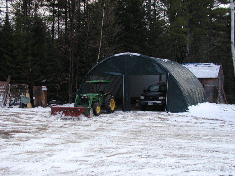

   / temporary shelter #10
Mosey,
The canopy that Ranchman posted pictures of in that post is exactly like the ones I had used. In fact I had two of them placed end to end, securely anchored with side and end tarps.
The rear one was for junk and storage and I parked my truck in the front one. They were only $200 a piece and although they solved the problem temporarily, they Are Most Definatly a Fair Weather type shelter.
There lack of strength and inability to hold any more then a couple of inches of wet snow, without going out to clean it off is the very reason I gave up on them and invested in a better product.
