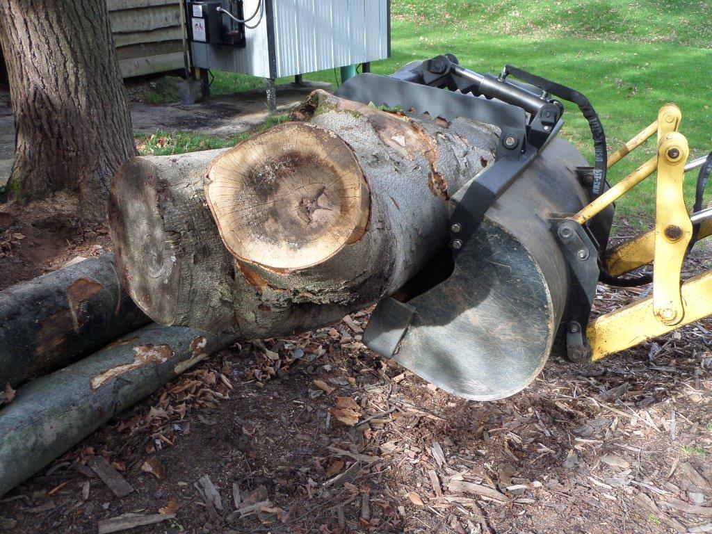

/ Terramite Ripper #11
I think I finally figured how to upload photos. Lzlounge, here's my thumb.
/ Terramite Ripper #12
Hi noteu!
Can you show us how you hooked it up to the hydraulics? Thank you very much.....Dean
/ Terramite Ripper #14
I used a electric controlled solenoid valve. Chief Stackable Solenoid & Manual Operated Circuit Selector Valves. It is controlled via a switch I mounted on the front bucket control valve. It is tied into the load/dump valve so when the button isn't pressed the loader valve works as normal, but when it is pressed the hydraulic flow from the loader dump/curl is transferred to the thumb. I used a 1/4 inch hydraulic quick disconnect fitting to cut the flow down to around 3 gpm. The thumb itself is home built.
