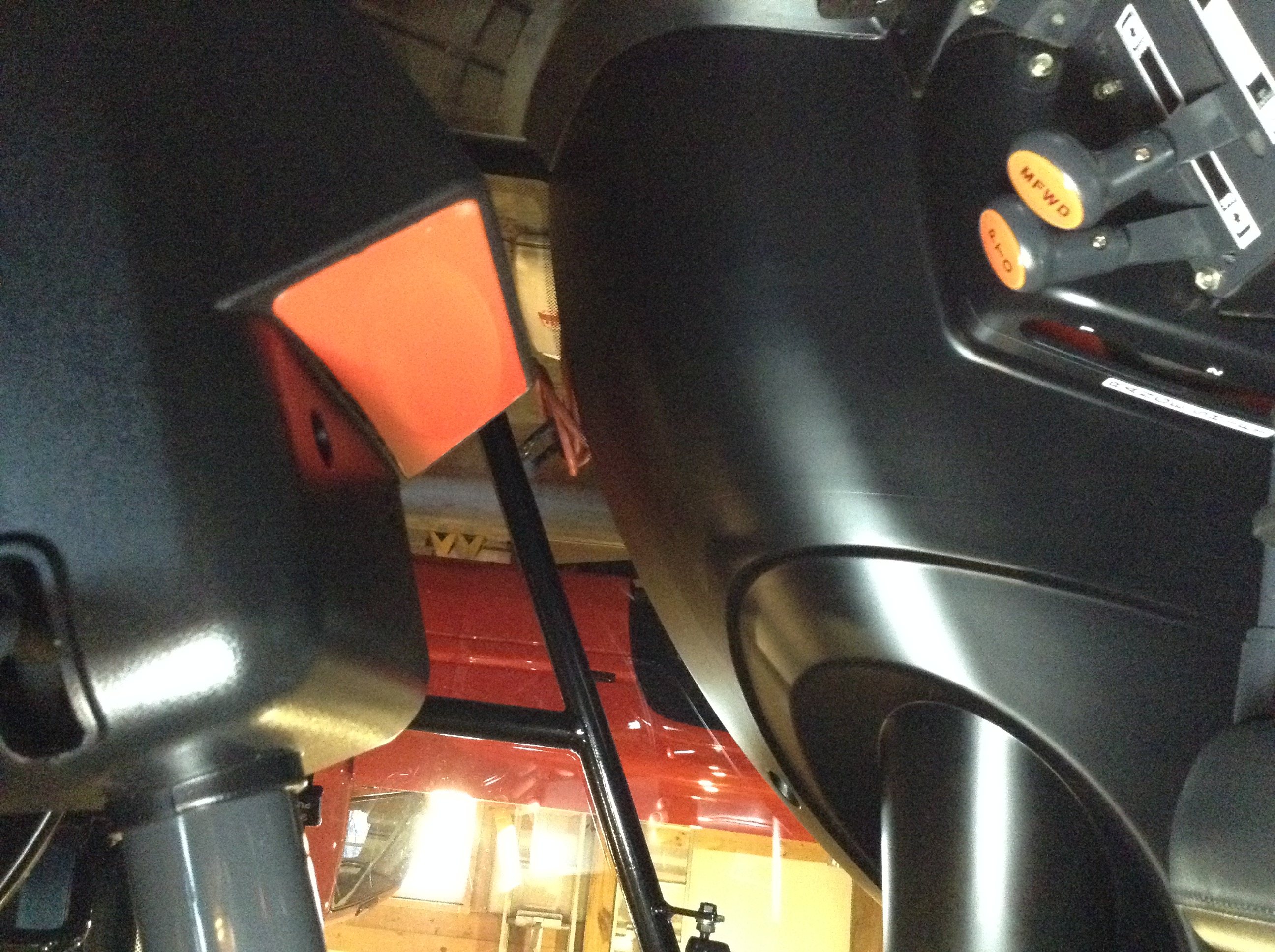

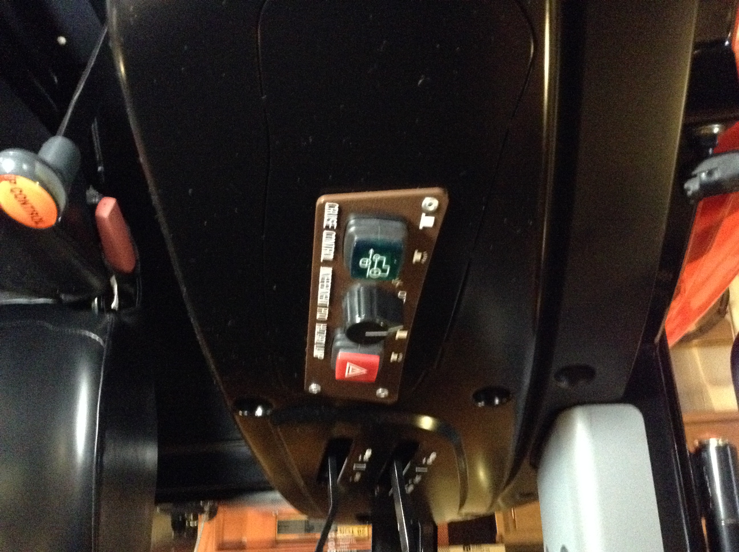

Here you go. Would I do anything different. No it's pretty handy where I moved them and much easier not having to look down and bend down to do things.

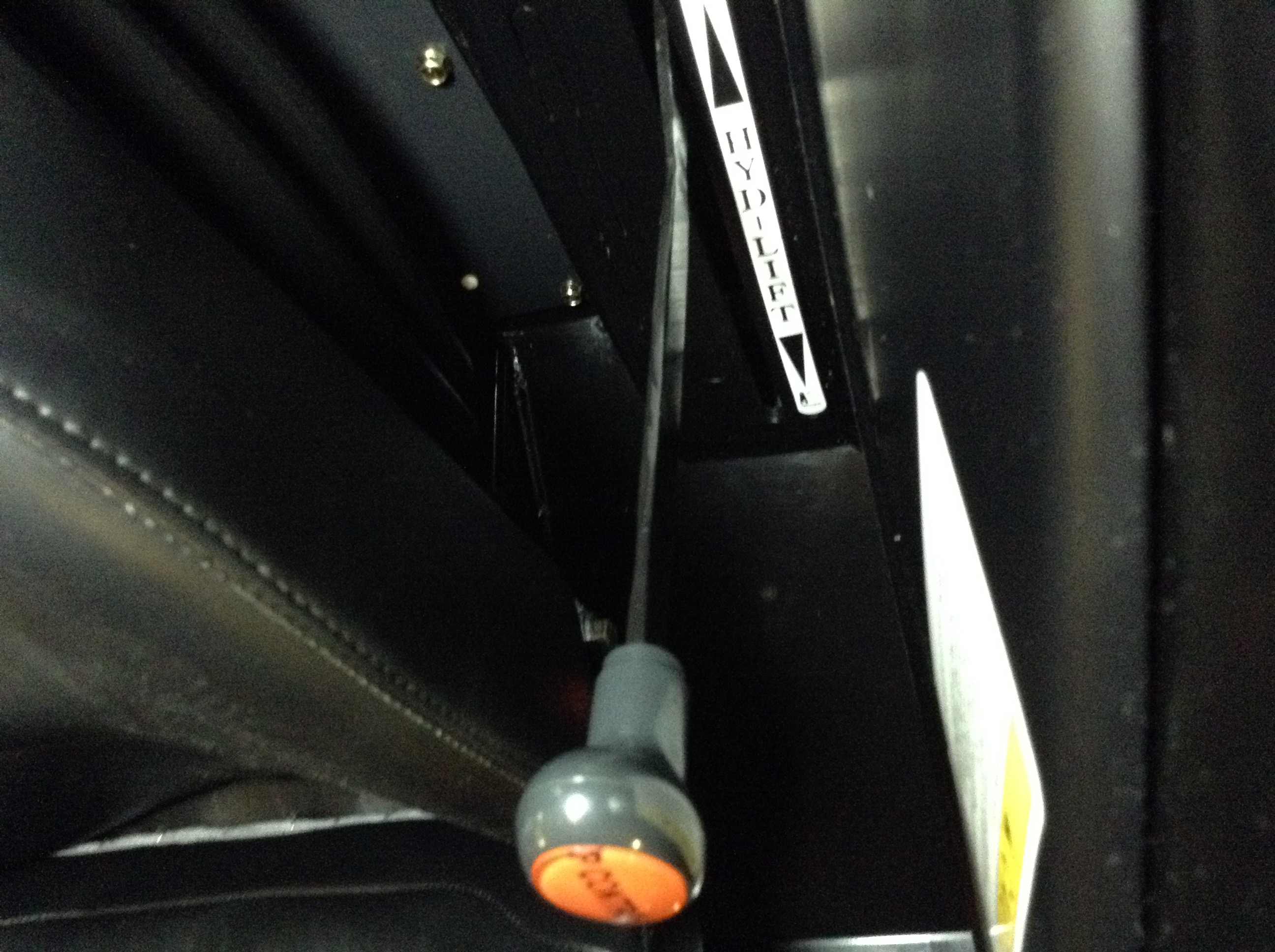

That pto handle is perfect ! What did you use for it?
Did you use anything to cover up the area under the steering wheel since you moved the entire switch plate?

I just had a piece of scrap metal. Removed the three point handle completely and cut where the handle attached and welded a piece between. Welded at a small angle toward the front at the bottom otherwise it would be to far back. As far as a cover.

Looks like you put the switches up where they normally sit on the 25 series. I like the location up there, except I have to mind that I don't press the hazard light button while moving around and working the FEL. Lol. I do wish my 3 pt lever was higher like you modded yours. That was a good idea and looks handy. Do you think you might snag it if wearing a big jacket or something?
