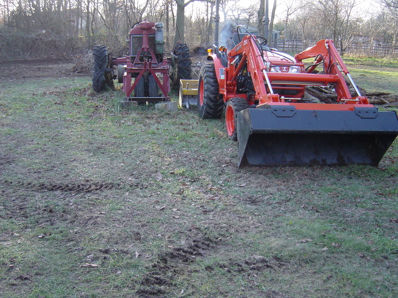

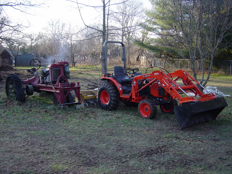

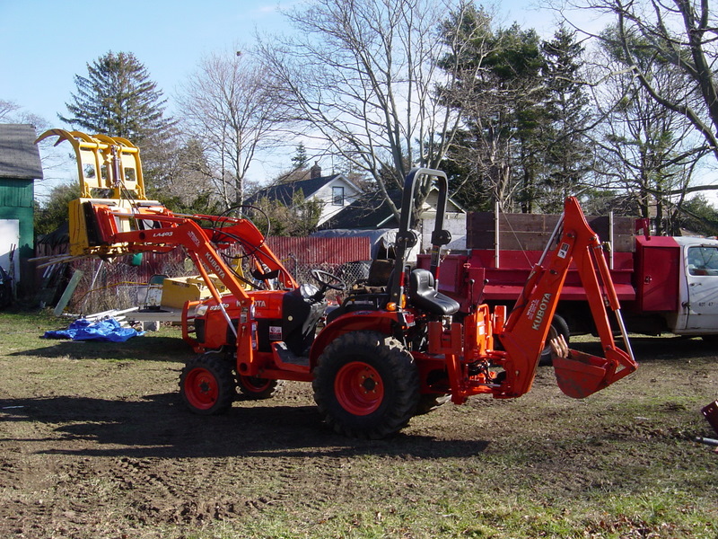

I see you already decided on the bucket but here are a couple of pics of my B2630 with the ATI QA and the Case bucket Art mentions.
