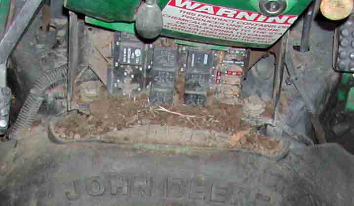

I have a JD 4300 and I suspect that there may be a bad relay preventing the engine starting (
Karl, here is a photo of your fuse panel. Hopefully yours is cleaner. Most
if not all of your relays are the same kind (well-described by LD1). You
can swap the relays around to test them, as well as using an Ohm meter
and a battery. I do suggest that you look at the electrical diagram to see
what each one is for. Also the various safety switches are more likely
your problem, vs the relays.
Since these are standard plug-in automotive relays, you don't have to
get them from Deere. I used Bosch units for my replacements.
