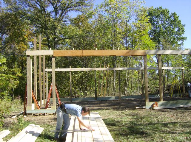

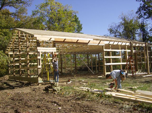

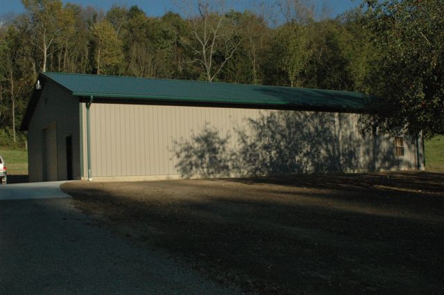

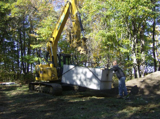

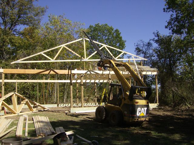

Been reading with interest here for the past 2 years about pole barn projects, cabins, etc-- looking for ideas & knowledge on what to do. Everyone who has been posting here has been very helpful and this has been a great source of information.
finally, after over a year of planning-- we're on our way! Last week, the site was leveled, the bldg framed, septic system installed, and the steel went on! Concrete is being poured this week, the well get drilled this week as well-- looks like power will come next week.

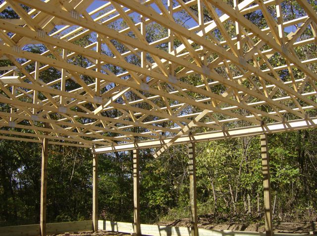

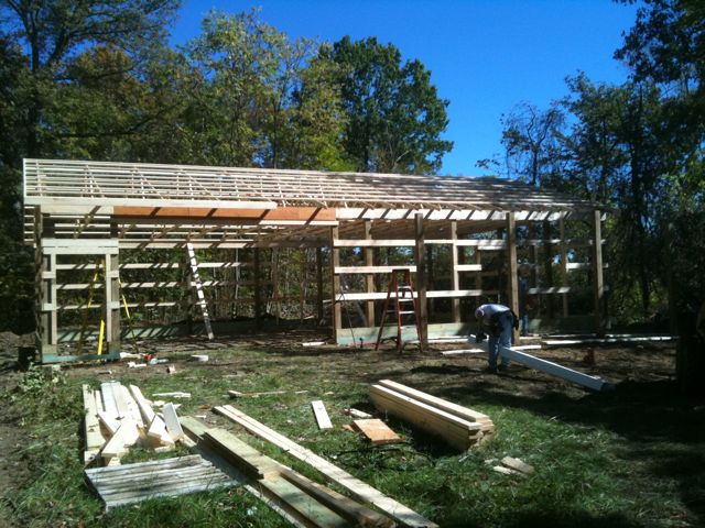

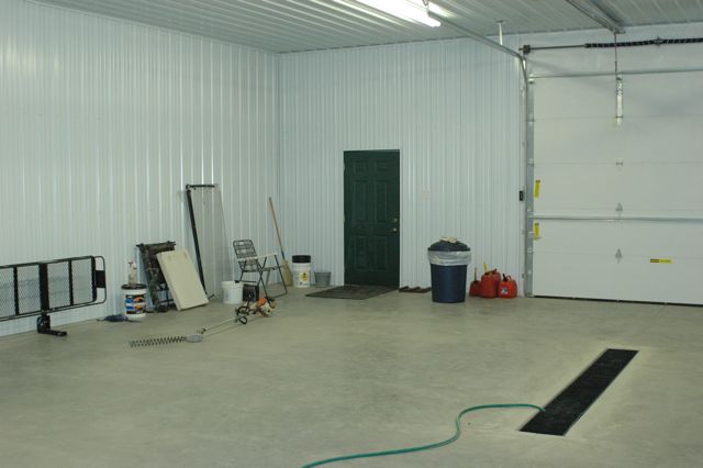

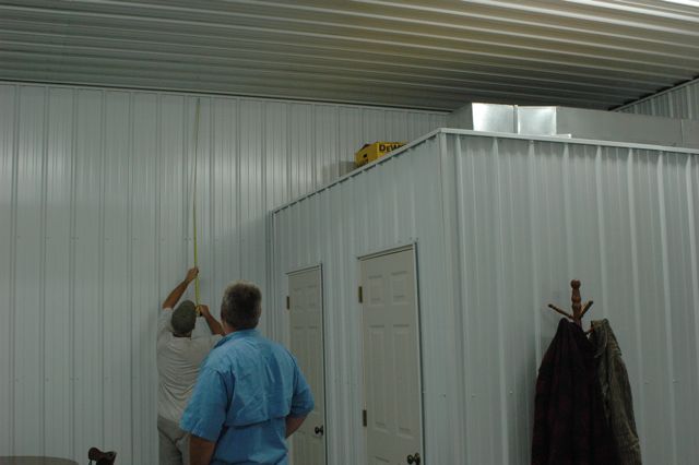

Here's some shots of the progress....

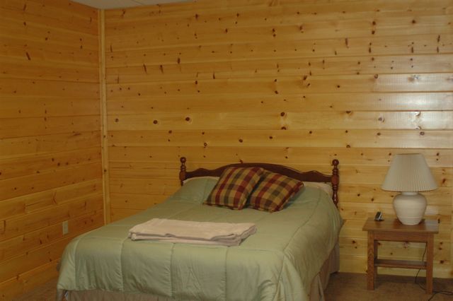

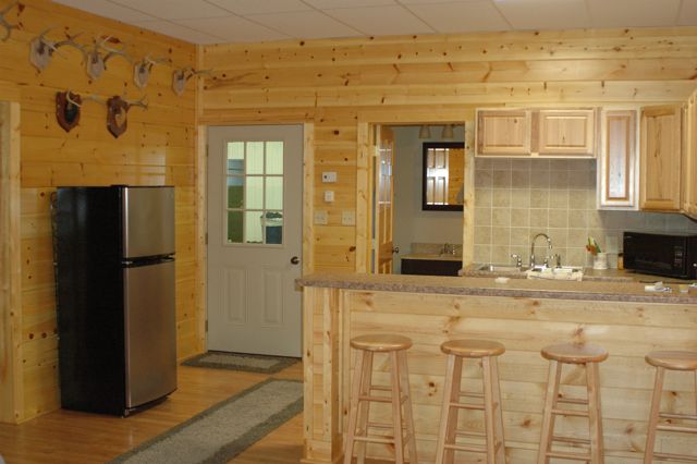

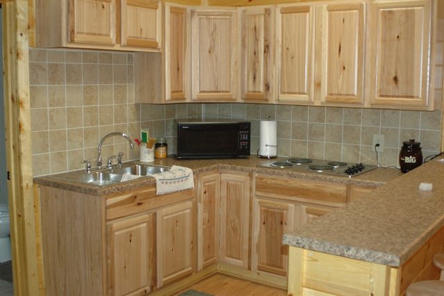

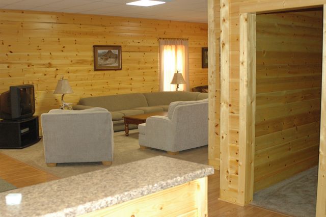

Goal is to have a barn-- to house tractor, ATV,s equipment-- and room to process deer! This is going up on property we bought for recreational use-- about 50 acres of great MidWestern deer hunting, and close to a state park with a beautiful lake. Recognized early on that this has to be a place that TheOneWhoMustBeObeyed would appreciate and be willing to hang out when the overly indulgent deer hunter wants to go to the woods.
Here's some shots of the design goal: courtesy of another client my realtor has-- it served as my inspiration
