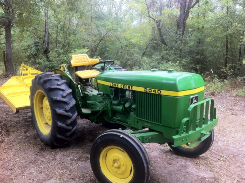

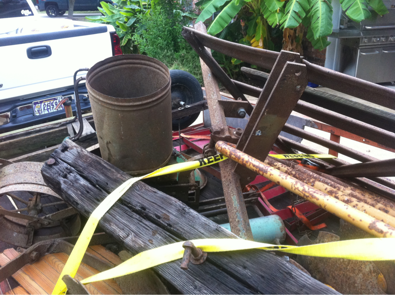

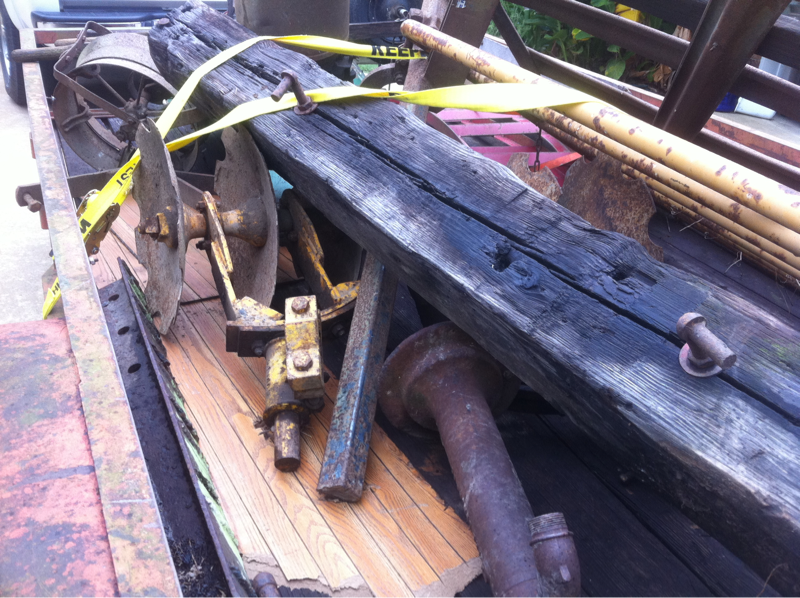

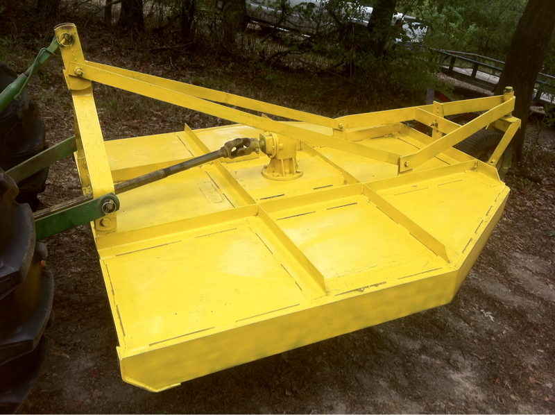

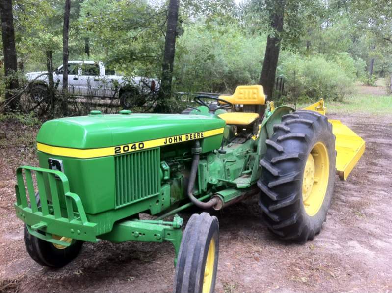

Man it makes a difference with them installed!! I got my used IM600 mower painted up too! Also some pics of some old implements I picked up this weekend from back home too- a 105 Ford tiller, an old 1 row planter, and some heavy row disks! Those last 3 were free, hard to beat that!

The Deere, she's a beauty!!
And for the mower deck, I replaced the long steel straps that run between the tower and the rear of the mower deck with chains. That makes adjusting the mowing height much much easier and takes a lot of compression stress off the tower when the rear wheel traverses a raise in the ground.
   / The 2040 with new decals, and some "new" toys
Thanks Beenthere! I'll keep that in mind on the mower too, good idea. My only issue with it so far is when I hit a hidden stump it knocked the blades into the deck and put a ring shaped dent in it. I'm surprised to see that, I figured it would just shear the pin. There is just a little play where the blades bolt on, nothing excessive though. I know, just don't hit stumps lol!

Dang, that looks real good.:laughing::thumbsup::thumbsup:
   / The 2040 with new decals, and some "new" toys #9
What year is the 2040? My father in-law has a 1983 2040. I think I'll share your pictures with him and suggest he spend a little time and money to beautify it. Looks great.
   / The 2040 with new decals, and some "new" toys #10
You done good! Great lookin' tractor!
