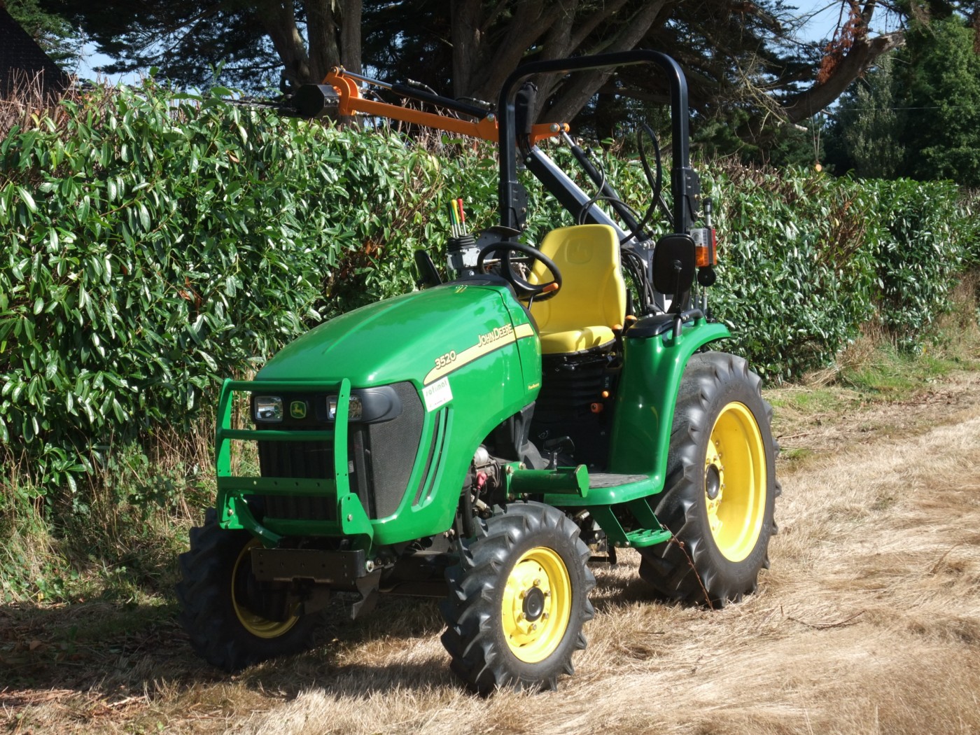

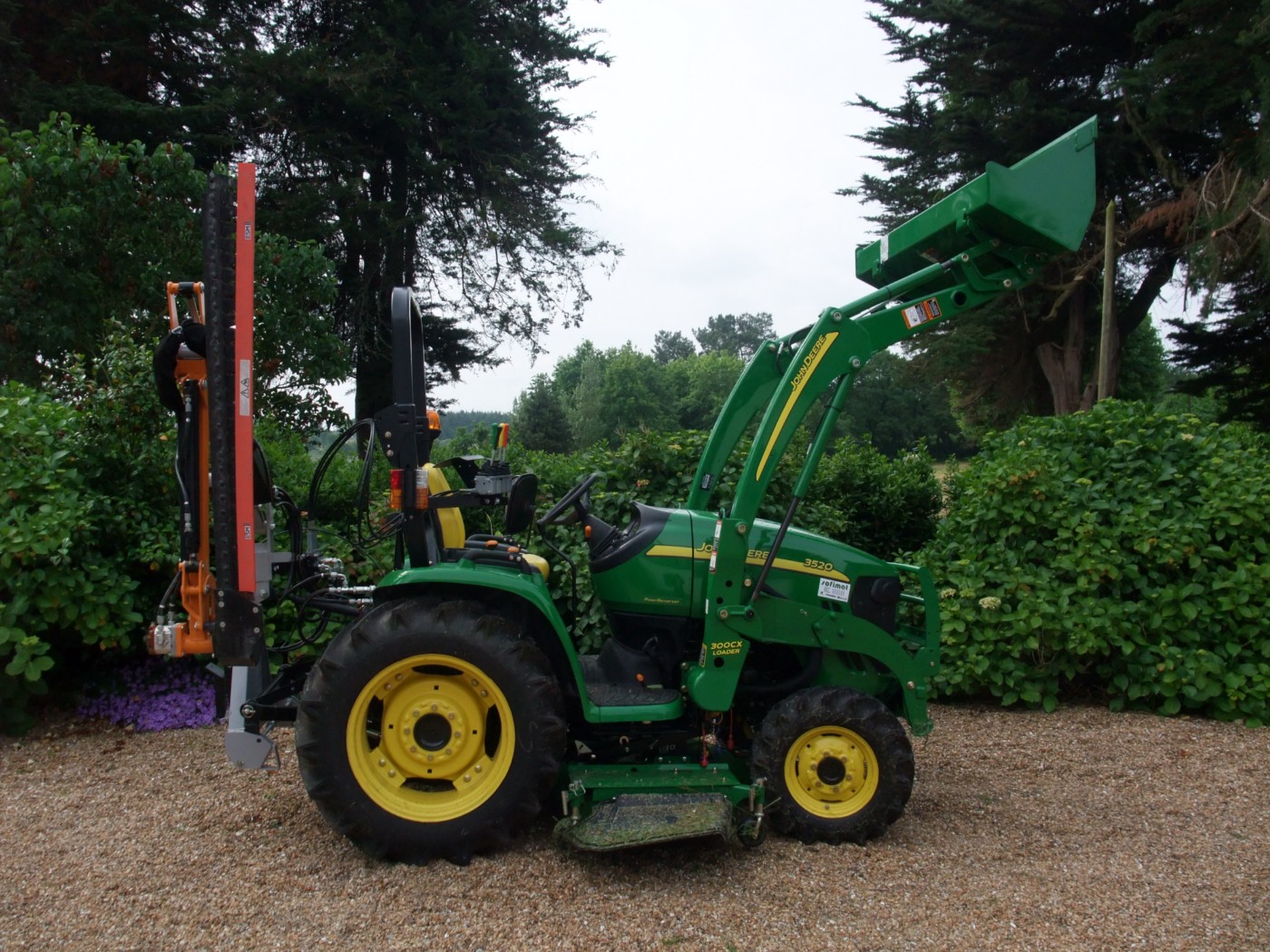

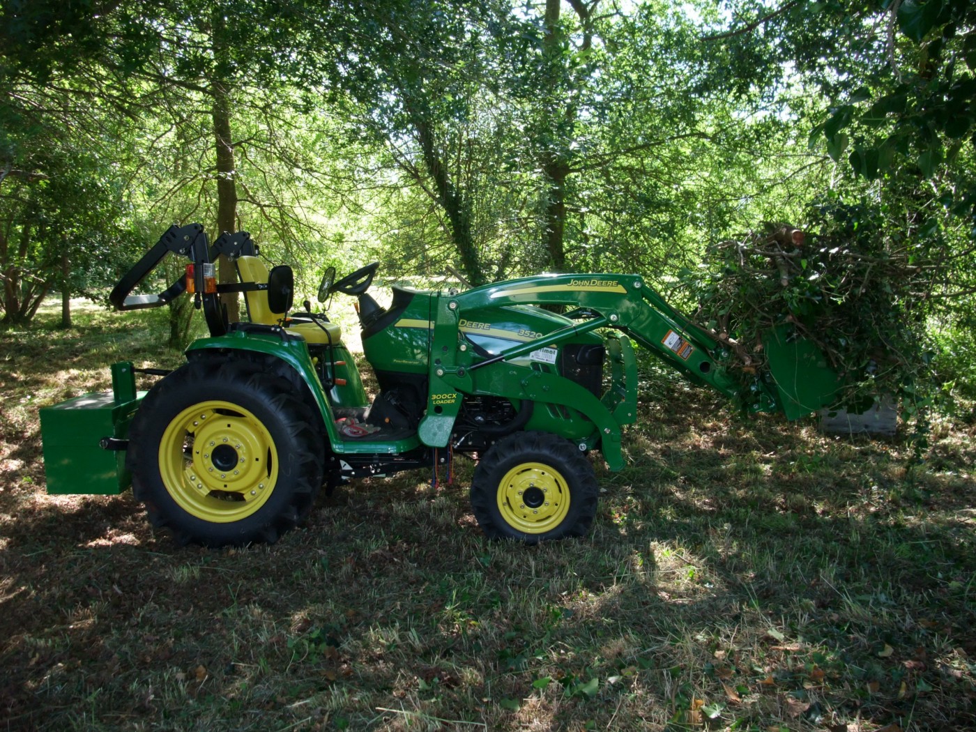

Extremely pleased with my 3520 Power-reverser. Lots of power. Forward or backwards at the same speed and RPM at the flip of a finger. Dual break pedals on the right side. Very strong loader (300CX) that does not reach far enough forward for my taste. Not much noise and little smoke. Narrow for that size tractor, which is a plus as it covers its tracks with a 5 foot implement, but also a liability as it feels unstable on slopes (after getting used to it I think it's more an impression than anything else as I've never been in trouble on the many slopes I have to mow).
