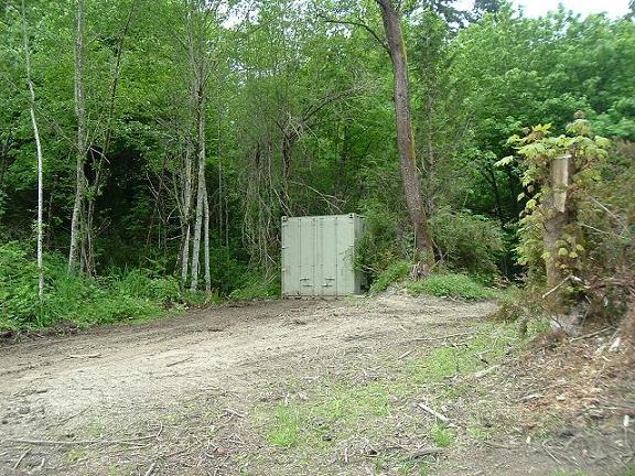

I am a little paranoid by nature, I don't trust strangers by default, I even carry a concealed weapon lots of times. My wife thought I was a little nuts for buying a 20' steel shipping container for use as a secure garage on my vacant 15 acre property out in the boonies. I use it to park my bulldozer inside and store fuel, rigging, and floodlights.
I lock 3 of the four handles with three different types of locks. The container is out of sight from the road and the driveway has a locked gate.
Well the crooks managed to come in on foot around the gate and then popped off a plain masterlock, then a padlock with the stainless steel shrouds that cover most of the lock bar. The third lock was one of those rotary style locks that looks round and the bar rotates around the center to lock, they couldn't get that off and it had to come off to open either door of the container. It looks like they then took a wedge and sledge hammer and drove a wedge between the container and the locking door handle until the assembly was pried from the container. The rotary lock was still hanging from the handle when I got there, completely reusable.
The crooks must have been looking for good pawn shop stuff since they took nothing and didn't even vandalize the dozer. I thought they would at least take the floodlights.
I relocked the unbroken door handle with the surviving rotary lock and wrote a note on the door with my black magic marker. "No tools, fuel cans, or generators inside, please stay away." This is the first attempted break in in the year it has been there.
The crooks spent a lot of effort to get inside, the oppurtunity thief would have walked away. I highly recommend the rotary style locks unless you want to intentionally make it "sort of" easy to get inside.

Thanks for the suggestions. I have already made an open bottomed box of 3/16" plate and hadn't put it on yet... doesn't that figure.
I still think the container is the best solution. I have no regrets since anything else would have made it even easier.
The question I have is do you make it harder to break in or do you make it easier? I can certainly fortify the snot out of it to prevent all but the most determined crooks from getting in but when they do I will have a heavily damaged non-lockable container. Replacing cut locks is easy. The best I can ever hope for is to keep out the less determined crooks, agreed?
I left the note in hopes of reminding them about their last experience of wasted break-in effort. Just like no-trespassing signs, they only work as a mental/moral deterent. No harm done.
I have certainly pondered the camera idea for animals and crooks. My problem is the flash, if a crook sees the flash then I loose the camera. If I get a picture of the crook then I have a nice picture of a stranger, police aren't much help. I suppose I could tape the crook's picture to the container for the next time.
I have decided that I will not be putting a tractor in the container until I live out there. Instead I will tow it back and forth the 40 miles. This was a relatively nice reminder of the risk in vacant land.
   / The crooks broke into my shipping container
To get in they had to bypass the lock and break the linkage off of the door. The vertical crank bar stayed put but the tab that holds the crank lever in the lock position was ripped off of the door and the crank lever was bent pretty good. Anybody have any good pictures of a lock box used on a container? I have a welder, steel, and an attitude.
