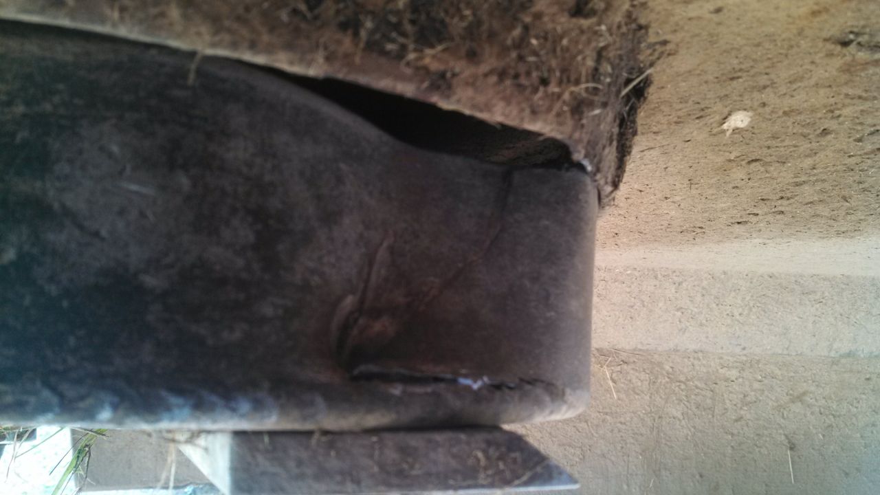

I am not sure you you guys with normal blades fare, but I remember little dents and dings on the hub when a blade let go going the wrong way.
Well, this happened to me today. After some bending I am still able to continue mowing, but this fall the mower is getting torn down and rebuilt. Given all my abuse I have dished out on it over the past 6 years (jeez, it feels like yesterday), probably not a bad idea.

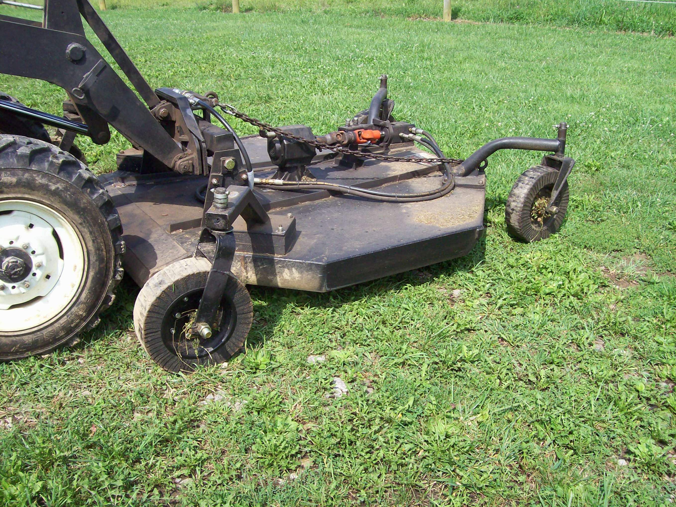

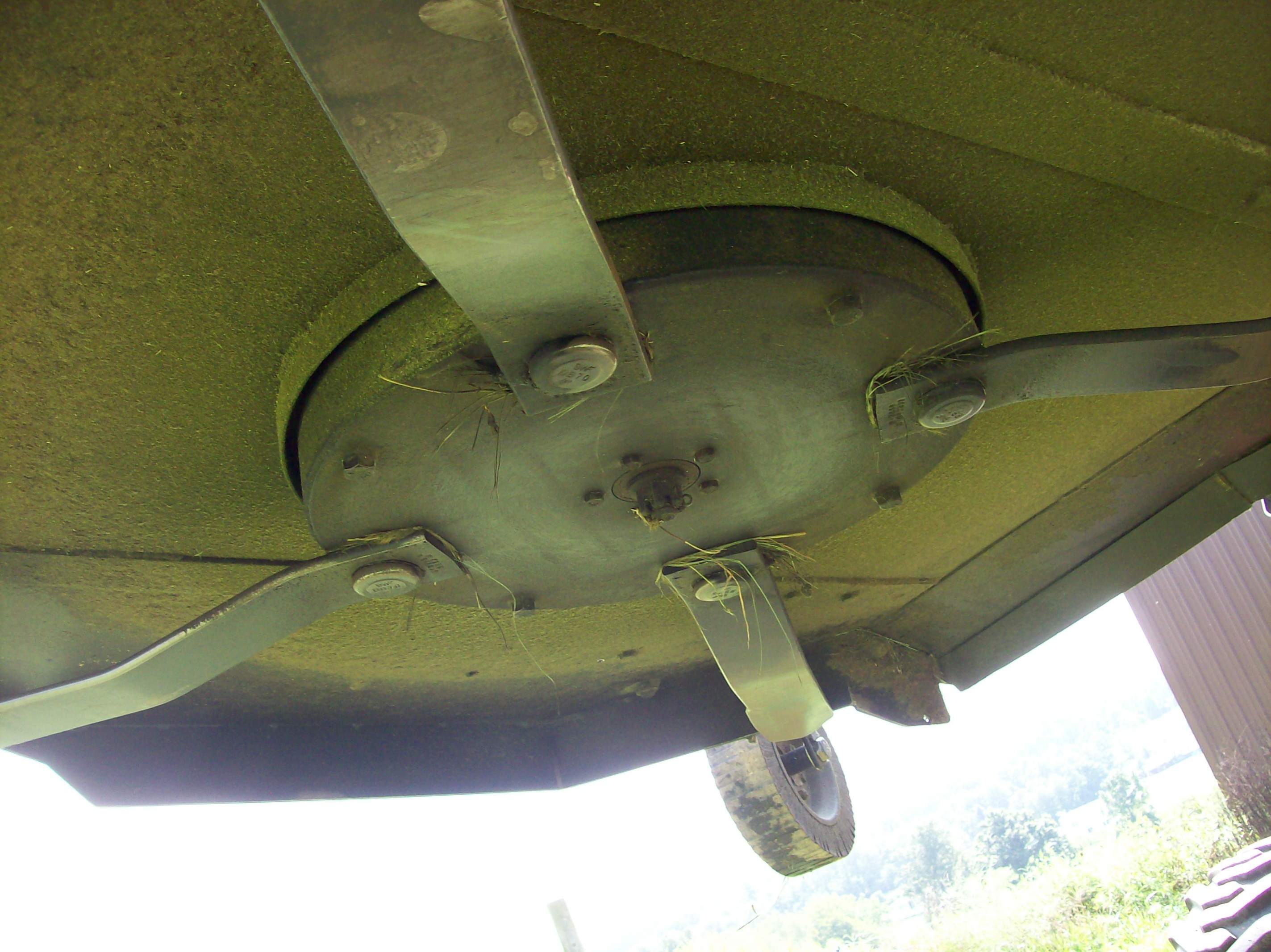

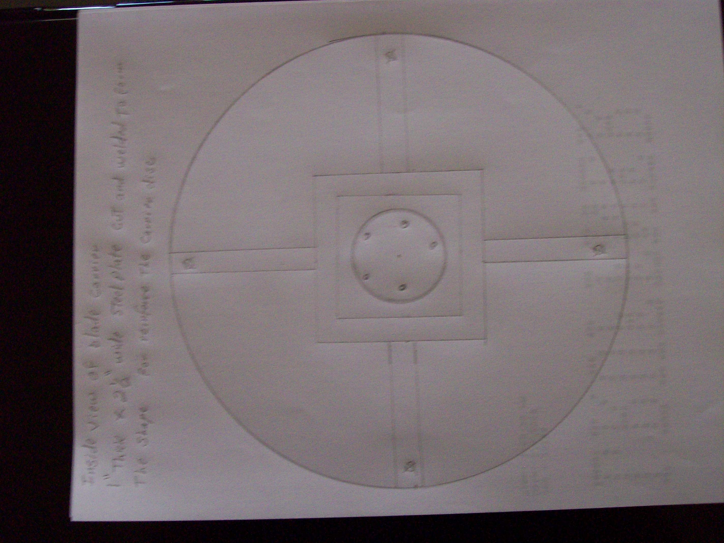

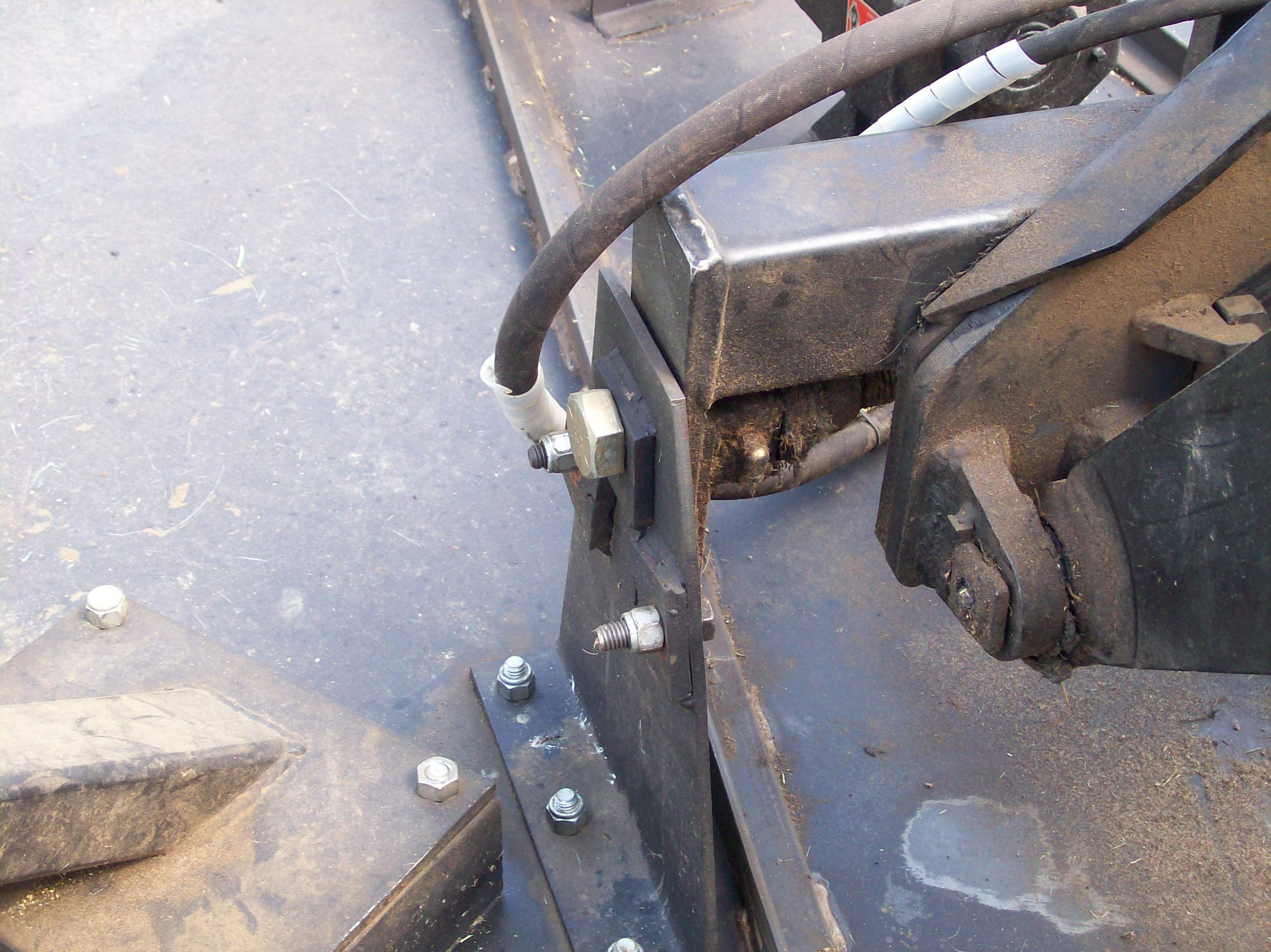

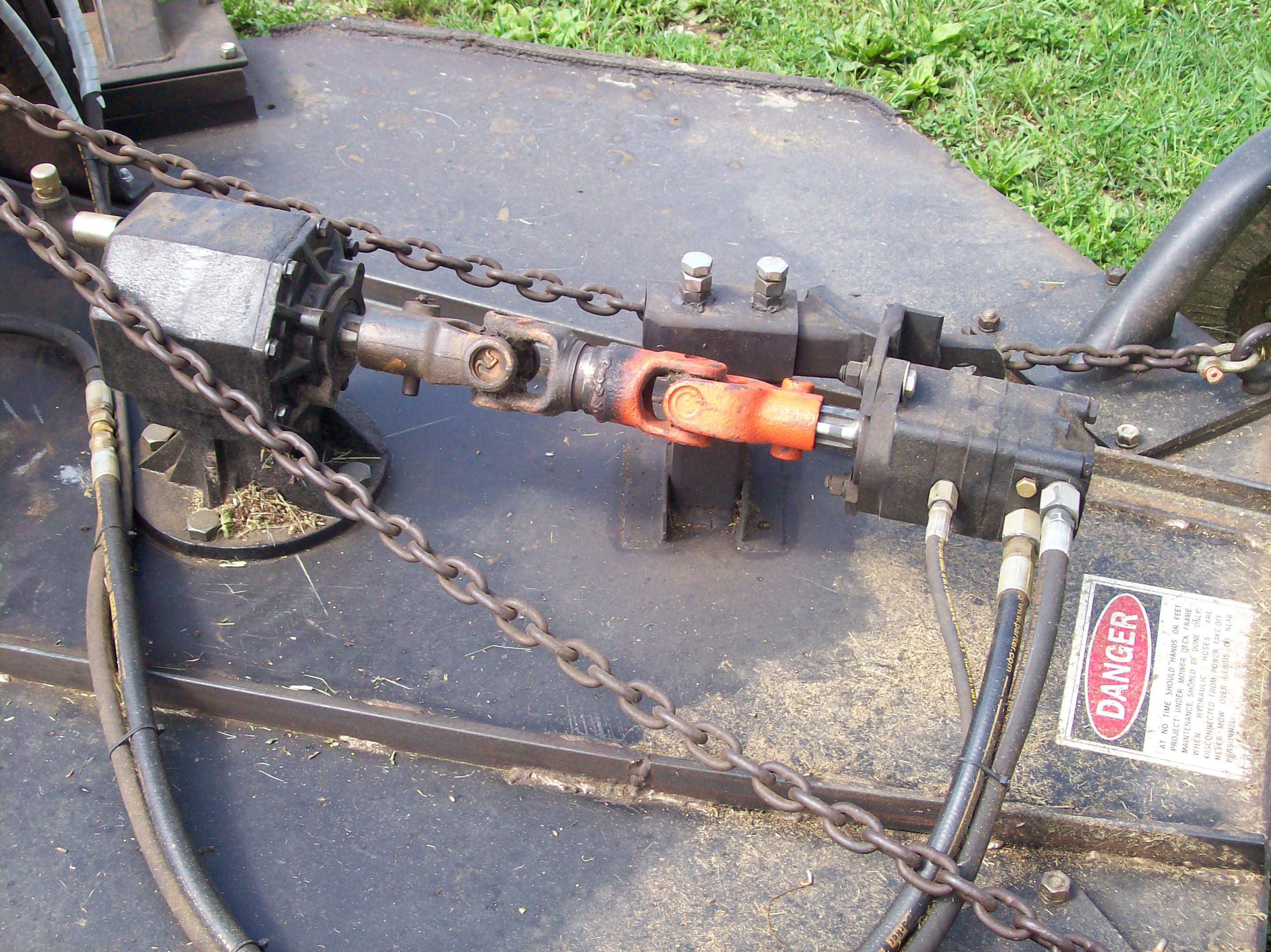

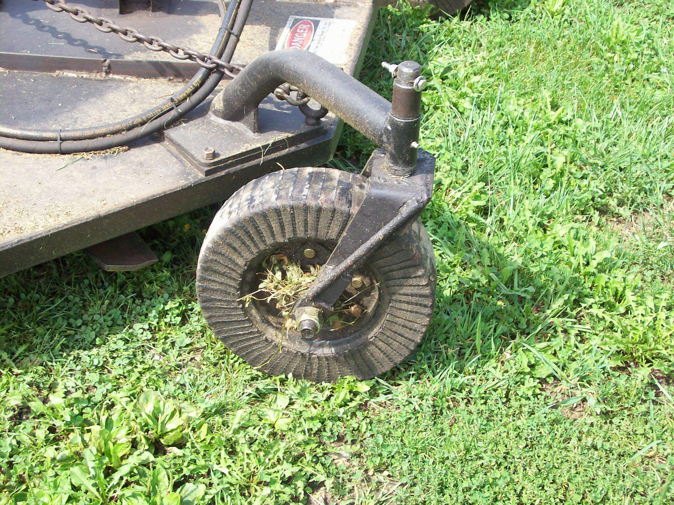

I have been using 4 standard brush hog blades installed in a "+" pattern on my 72 inch mower for 3 or 4 years now , however before installing them I reinforced the blade carrier with 1 inch thick steel plate as I was afraid that my carrier would end up like yours. I have had to make quite a few modifications to my mower over the years. Two major problems were the wheels and the hydro-motor. I have installed laminated brush hog tail wheels on all 4 corners. The entire blade drive system has been replaced as the 7 cu in wheel motor only turned at about 300 rpm and the bearings went out from the extra weight and impacts from hitting hidden objects. I installed a 75 horsepower speed increasing gear box (1:1.47) and a 6 cu in pto motor. The blades now turn at about 800 rpm, comparable with other brush mowers. I use this mower for cutting hay and for occasional brush mowing. The performance is drastically improved over PT's design. It mows hay from 2 feet down to 3 inches with no problem and my hydro oil temps are lower during operation.
   / The downside of heavier blades
You got some pix to share? All the stuff you write is is quite intriguing.
   / The downside of heavier blades #8
Pix of mods and sketch of the under side of the blade carrier showing the 1" X 2 1/2"steel reinforcements

   / The downside of heavier blades #10
I use them as tail wheels on 3 pt bush hogs. They are not cheap! If anyone knows of an inexpensive source of them, please let me know. I am going to try some cheap wheels with tubes for the rear wheels and and tubes in my existing front wheels and see how that works.
