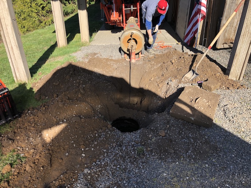

:mur: One day after removing my backhoe and properly storing it, and hooking up and adjusting my box blade, the basement toilet and shower backed up. :thumbdown:
Ended up putting the backhoe back on and digging a couple holes to get to the clean outs on top of my septic tank. At least that was more fun than a shovel. Just went through this a year and a half ago. Holes dug and septic guy trying to unplug it.
From a borescope camera, it seems that a tree root is the culprit and now after spending a couple hours trying to unplug it, he will back tomorrow to jackhammer my back patio and cut out and replace a section of the main drain line.
Really not excited about this repair bill.

Distribution box? This is in my main line exiting the house to the septic. The root (from a Sequia tree) likely followed the foundation wall and attacked the drain once it cleared the foundation. Hope to have it solved with pics to prove it tomorrow.

He tried clearing the clog with the snake from the clean out by the washing machine near by the toilet. Couldn't get past the roots. He then tried to clear it with the snake going upstream from the baffle port where the drain is tied to the tank. Neither worked. Then tried a bladder pressure hose several times and that didn't work either from both ends.
A year and a half ago same guy confirmed with a camera it was a root. I passed on getting fixed after he was able to unclog it. No luck this time. Open to suggestions... especially from you 'head' engineers.

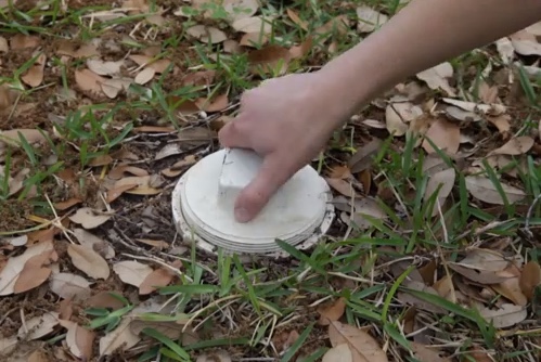

Second, do you not have an external clean out port?? Looks like this in the picture. Usually on the side of the house? I’d try every water jet and/or snake I could find before tearing up a patio. IMG_2539.JPG
