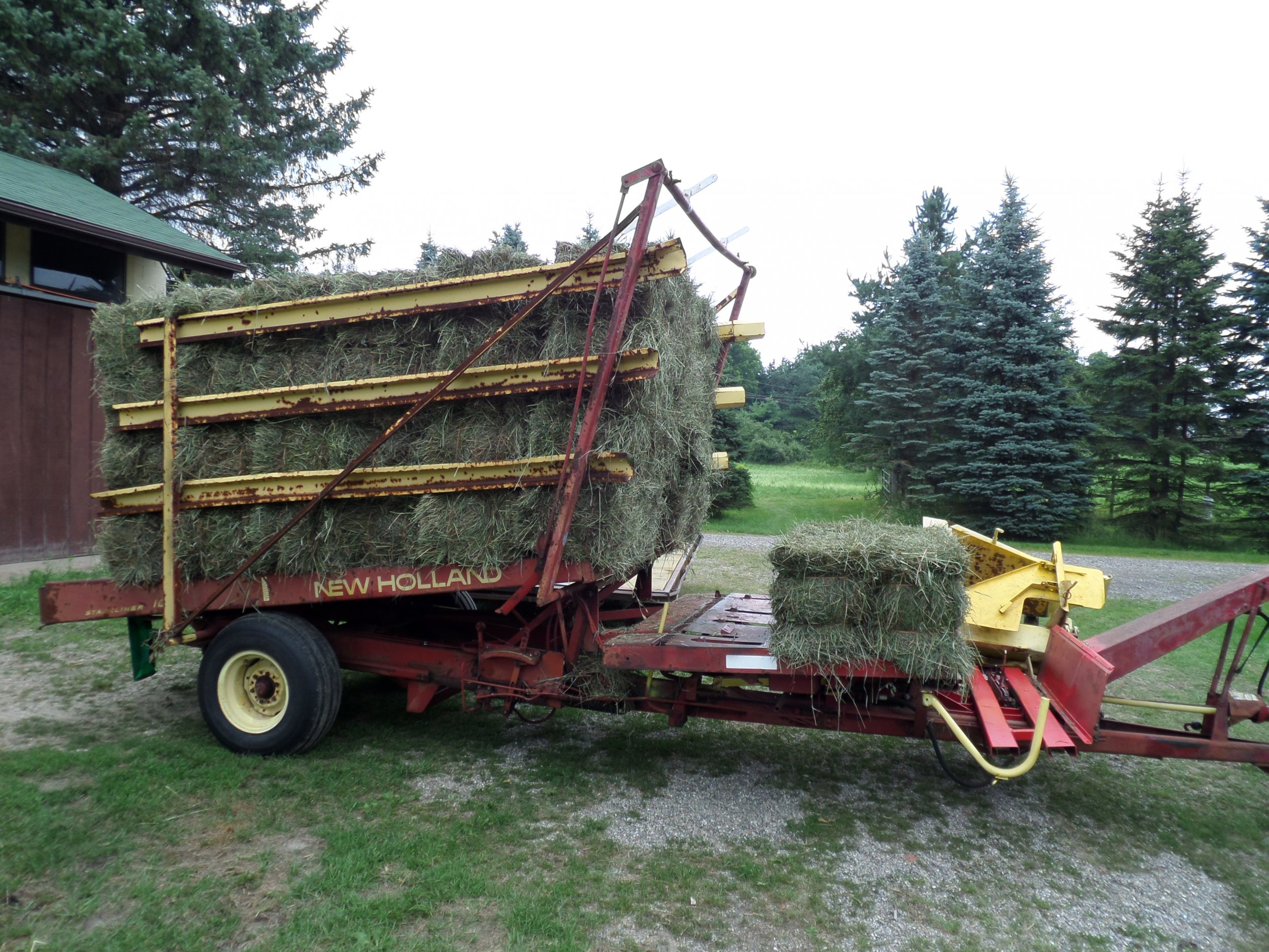

I would wait until you have running machinery & have succeeded in producing hay bales from it before you address the field contents. I cut & bale 'weeds' (no extra special plantings) with great success & happy customers. The vets say it's the best for horses (unless heavily worked). Customer horses eat every tiny single piece.
Then when you know how it all goes, you have the weather, help, transport, breakdowns, drying time, and storage needs all figured out, then incrementally add acreage, fertilizer, and new plants.
First thing I would suggest this spring is to mow down all the old weed plants, saplings, ant hills, and remove rocks, tree limbs and trash from your fields. You don't want a mower to see junk and your horses to eat wild rose bushes, etc. I use a finish mower to do this on a new field. I've even controlled burned a field on occasion. I use a leaf blower to control (i.e.stop) the burn front. But be careful, some fertilizers or PH modifiers don't taste good to horses. Cows, OK. Not horses.
Machinery is found on FB Marketplace, Craigslist, auctions, and can even be borrowed if you get along with neighbors. Most of my stuff is almost as old as I am (except for the tractor, which has to run NOW, not when it needs a new starter or a tire blew out.. I get parts from TSC, Rural King, and my New Holland & John Deere dealer(s) as necessary.
A decent set of battery powered tools is recommended to change broken knives, rake teeth, loose bolts, on the fly in case there is a breakdown. This means sockets, extra nuts & bolts (do not reuse old rusty or stretched ones.
I get help from customers: They need hay ? I need it picked up because I don't store it anymore. They get a break on price.
