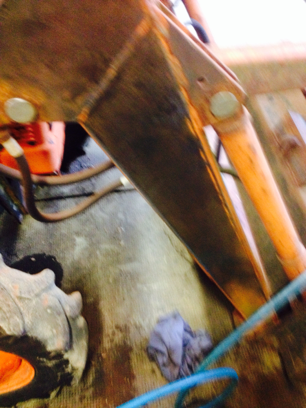

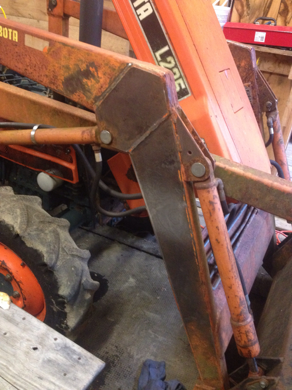

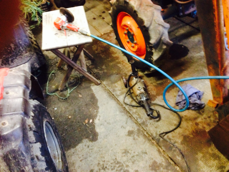

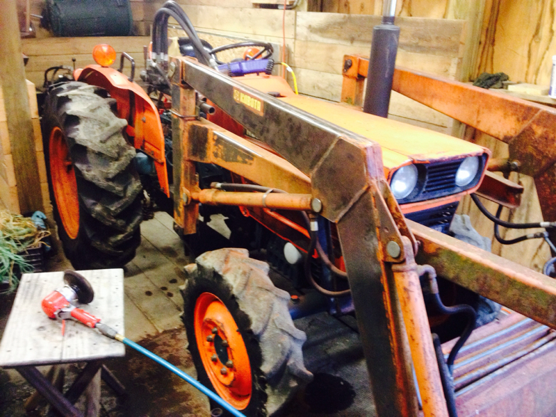

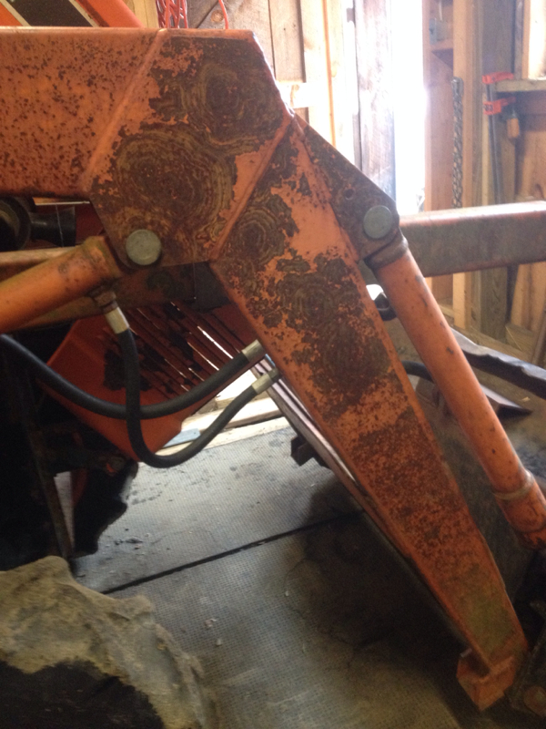

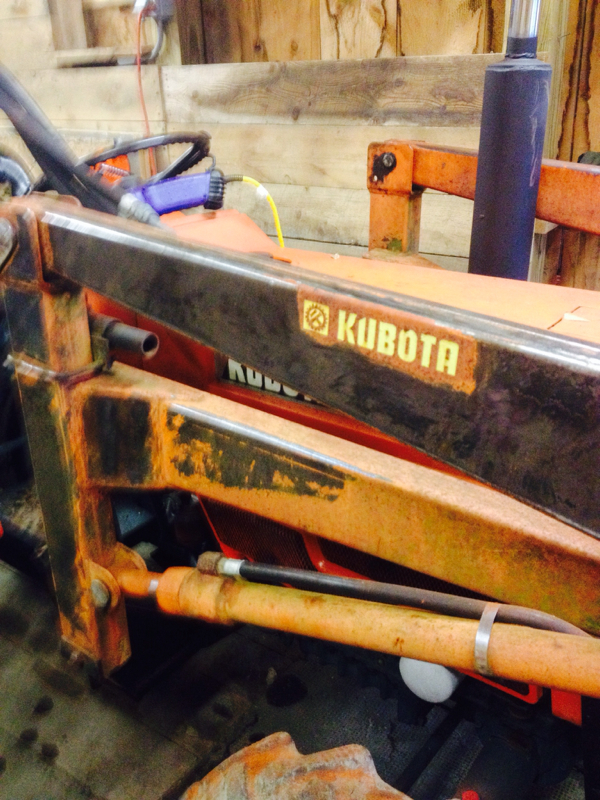

So I finally started getting tHe old paint off the tractor
This project will probably take up most of spring Amanda summer do to am off and on schedule of working on the tractor
A wire wheel and da was what I was using to strip the old rusty paint
Please comment and share your thoughts

I see your right front tire is going in reverse. Why?
I painted my B6200. I took off all the orange parts and sandec and painted them. It didnt have a loader. But I also recommend some disassembly. You can still drive it and use it with no hood and no fenders. Just be careful you dont get caught in the rear tire.
