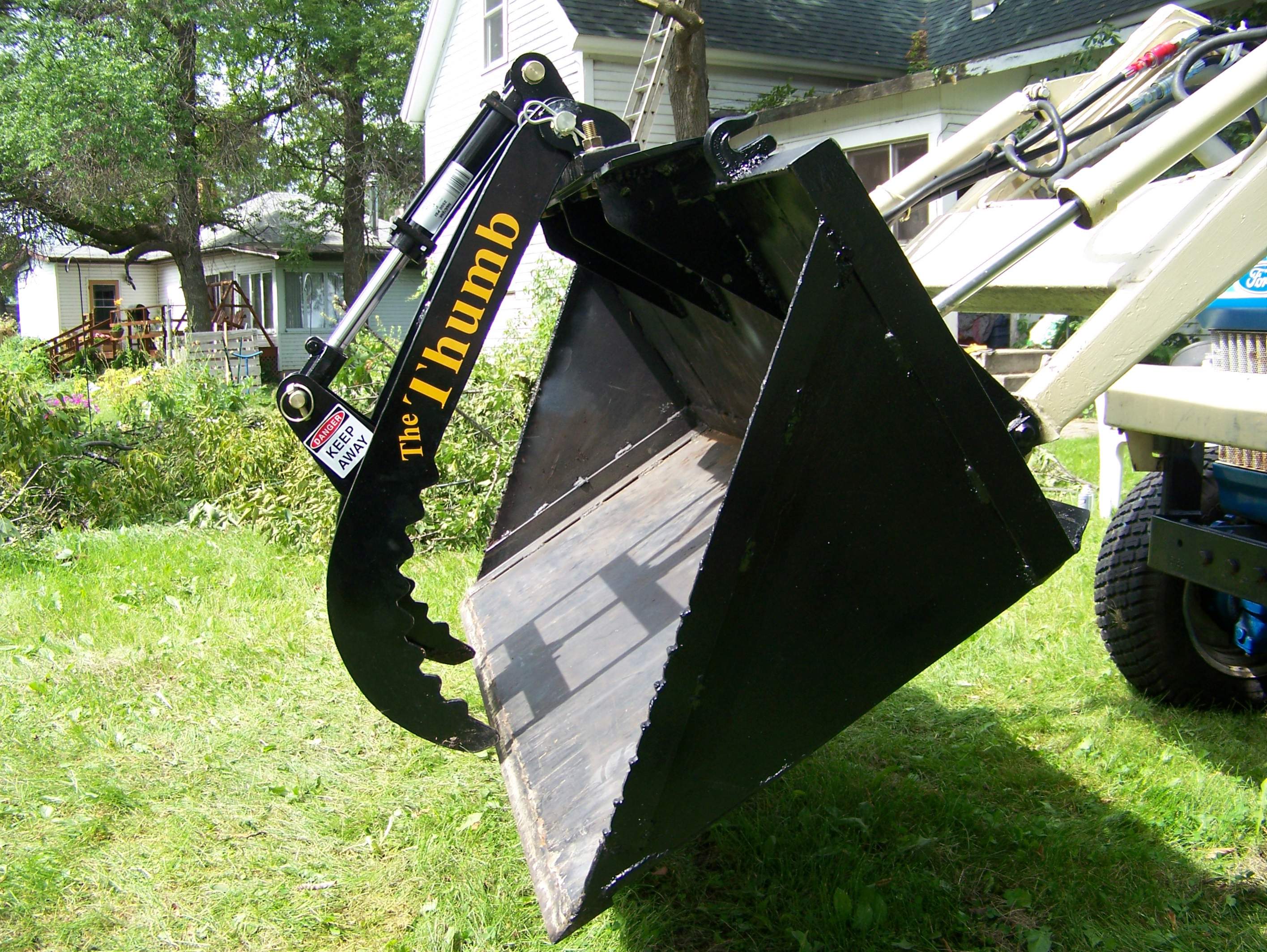

   / The ""THUMB""? #2
Thumb mounting base
Looks like you just buy more base plates for swapping to different units.
I know adding a thumb to the back hoe was most useful add on ever purchased.
   / The ""THUMB""? #3
It looks like it is designed to be welded on, but by drilling some holes on each side of the swivel points, I believe that it could be bolted on. I think I would add some angle or channel to the top of the FEL bucket prior to attaching it just for extra strength. If you dont have a welding machine, I think that could also be bolted in several spots also. Use large thick washers on the underside.

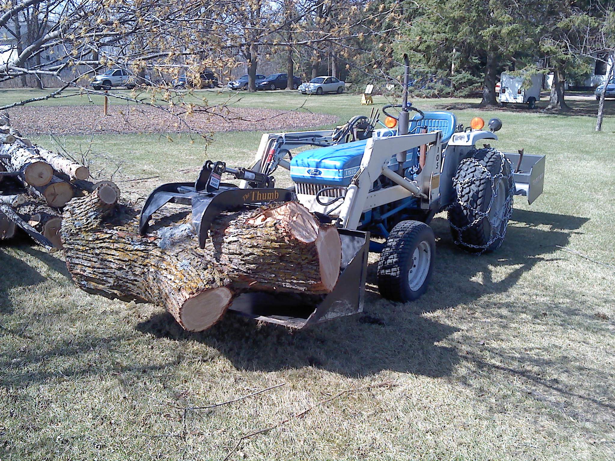

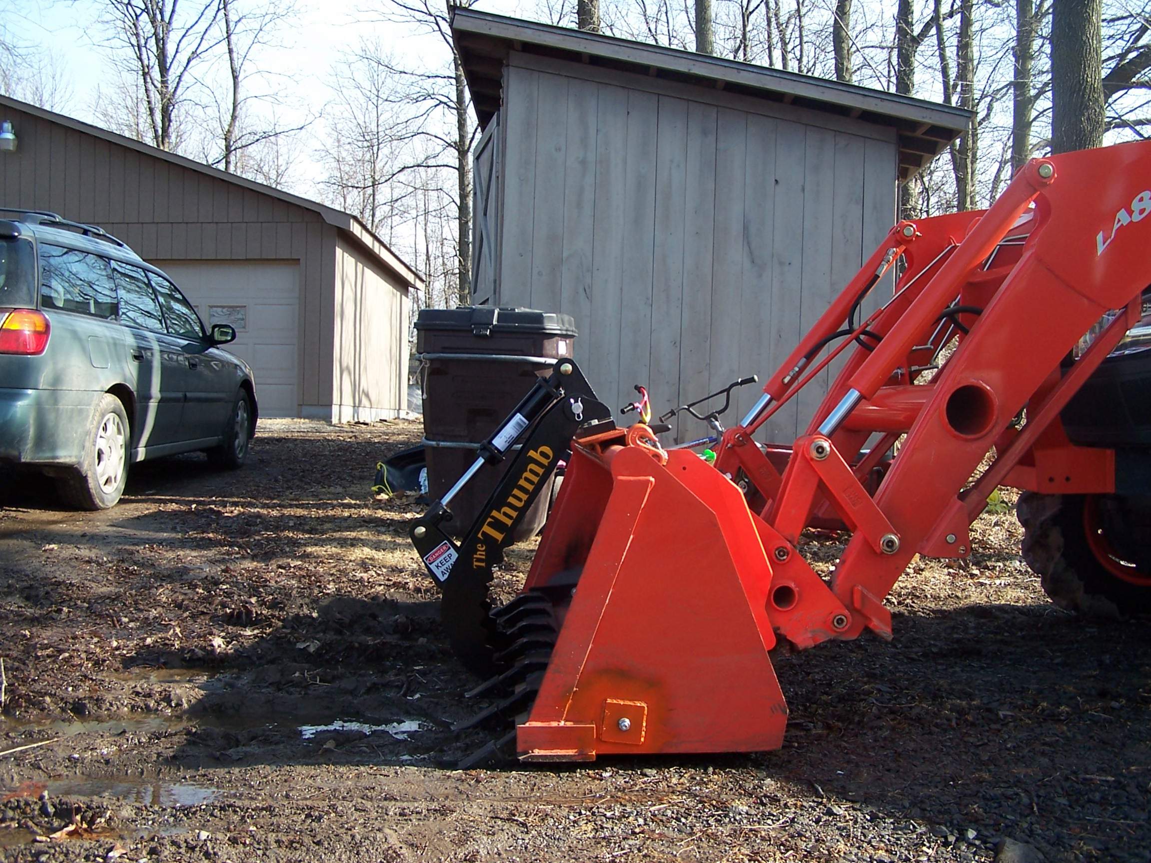

   / The ""THUMB""? #5
I have one.I welded an angle iron to the top of my HD bucket and tacked the nuts to the underside.The Green Machine's Thumb has bolt holes.I can easily remove the whole thing if required.
   / The ""THUMB""? #6
Is it electric operated? Their web site said they were now black power coated. Looks very nice the way you mounted it.
   / The ""THUMB""? #7
I had the Kubota "third function" installed on my tractor.About $1,000.So it's hydraulic operated by a additional electric valve.

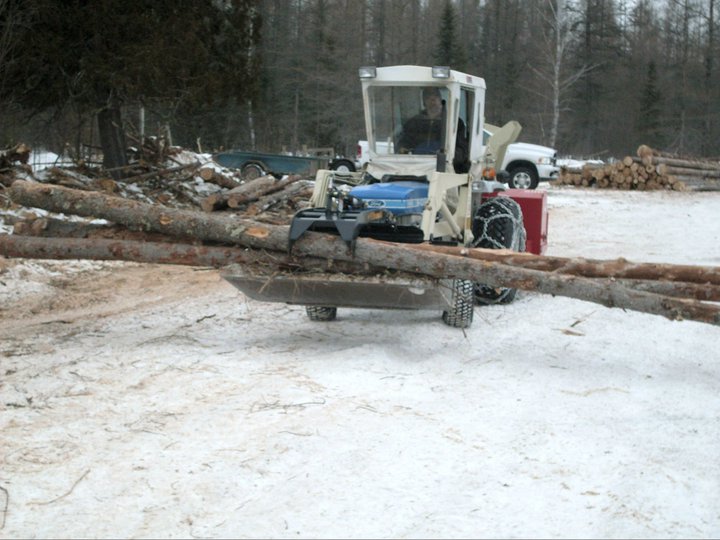

   / The ""THUMB""? #9
I also have The Thumb. I built up a base to bolt the mounting plate on, as I have a homemade bucket and it's not a standard size. The Thumb is very sturdy and has performed every bit as well as I have hoped it would. I think I can safely say I'm not babying it, and it has never even hinted at bending or breaking.
Joe
