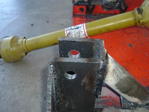

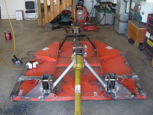

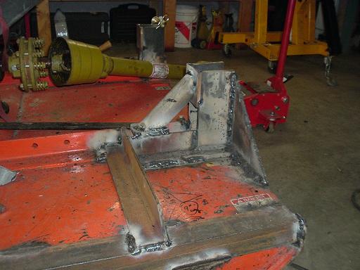

   / The ultimate bush hog #3
I bought a cheaper mower and then after the uprights failed from backing into brush I went ahead and improved the uprights to an HD captive pin design. I see this as a major improvement over the OEM. Don't drop it on your fingers when you're fabricating, I crushed one of mine into bone soup.
