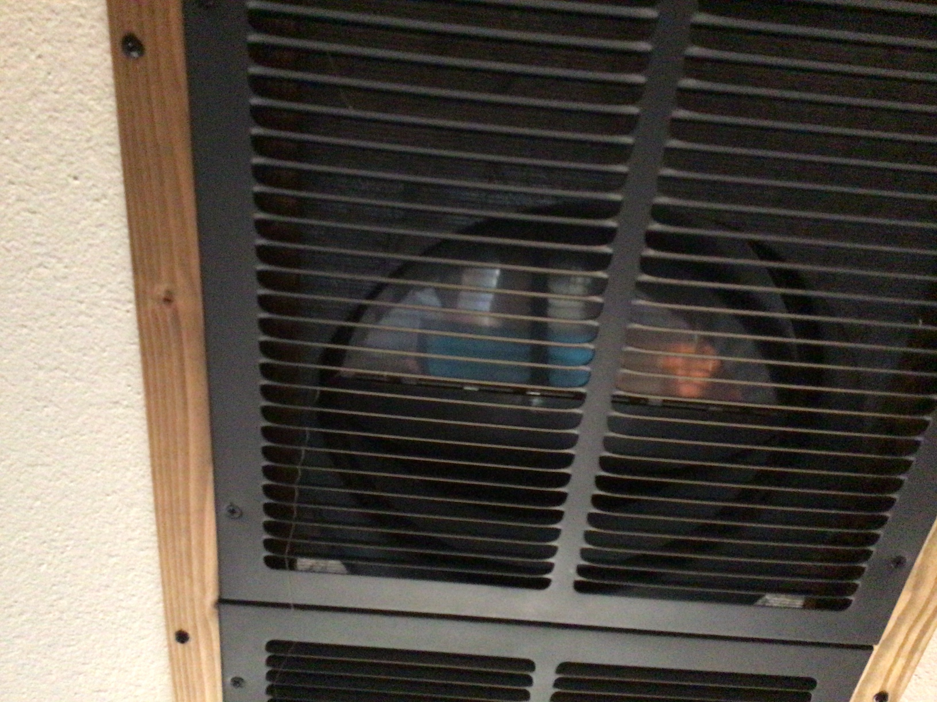

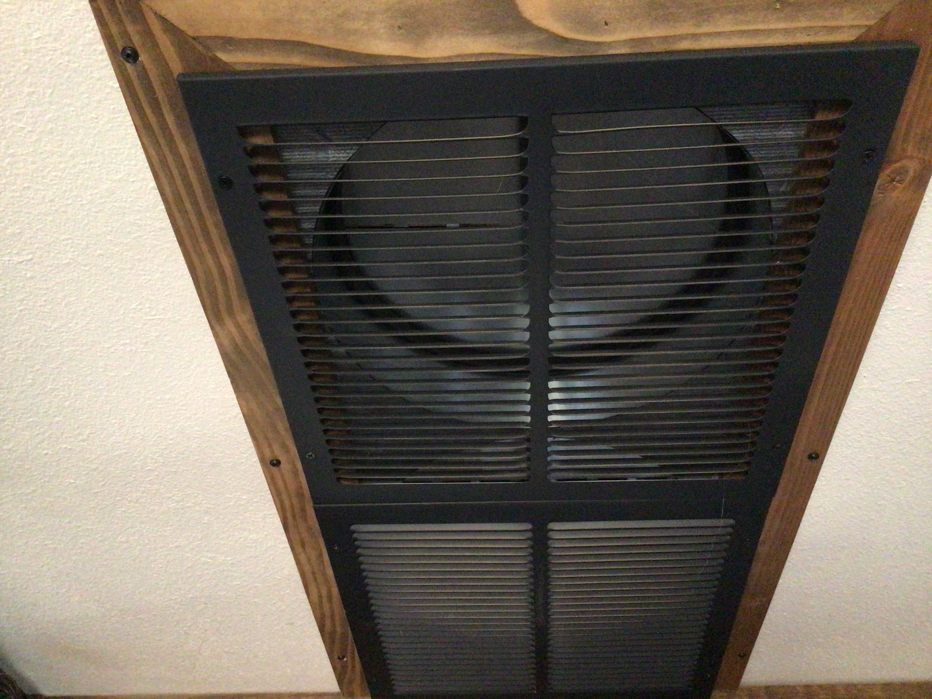

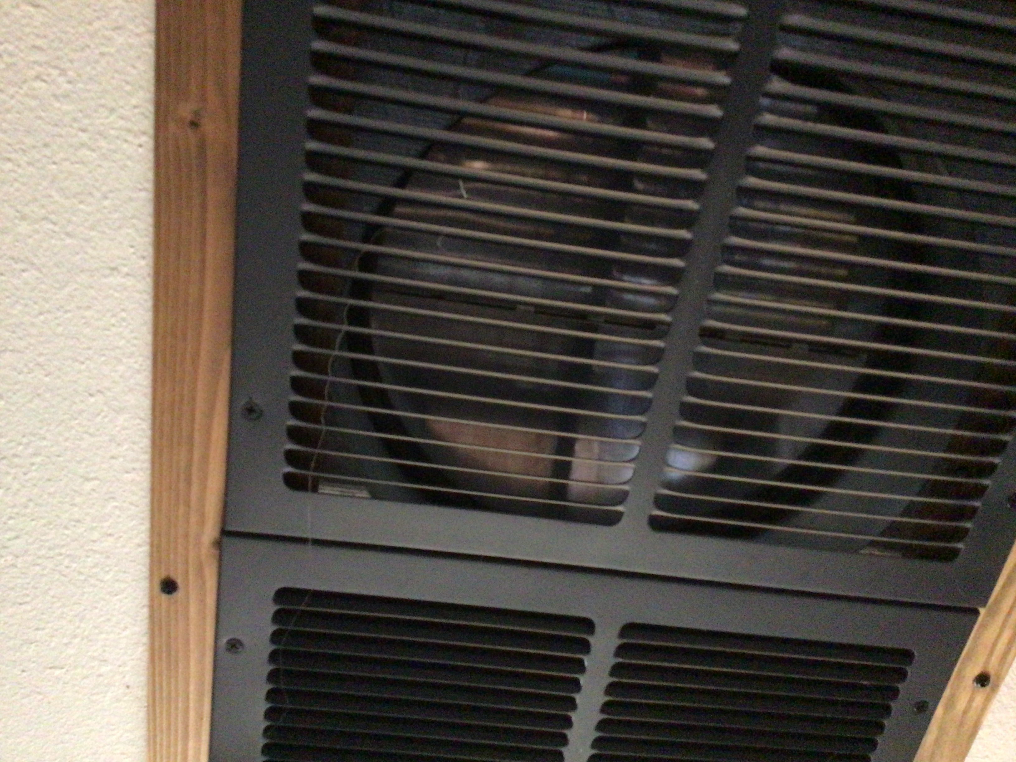

I basically made a "plenum box" out of 1" thick foam insulation board. The fan got mounted to some 2x4 bracing I installed to the rafters and ceiling joists. When I mounted the fan to those braces, I used 1/2" thick rubber grommets between the wood and the fan and between the screw/washer and the fan.
I also found 2--12.5" self closing backdraft dampers and mounted them horizontally between the ceiling joist. Then just made a pine "picture frame" around that opening and mounted some simple return air grills to finish it off.
Soler & Palau CAR315 Steel Duct Backdraft Damper - 12.4-Inch
Something that I found with this fan unexpectedly, was that it is actually 2speed. It comes with a thermostat in which you can select either the high or low speeds by just changing the connection of one wire. COOL! .... I got a 2 speed whole house fan switch, connected up both wires and BINGO! Two speed fan!
During my extensive research, I found that this is the same exact fan, motor, and housing that is used in the whole house set up.... I just couldn't see spending $3-400 more for a short piece of flexable duct and a grill....
We have 2 minisplit units that we use when it gets really hot during the day, but being in the high desert mountains, it cools off quickly at sunset. We may use the fan on high for a short time, but then turn it to low for all night. By morning it is sometimes plain chilly....
Here are some pics of the finished ceiling cover, you can barely see the dampers. Unfortunately I had full build / mounting pics, but I deleted them
My whole cost for the project was under $200. I did use the higher volume red 3.0 version. I was able to find it elsewhere for $140.
