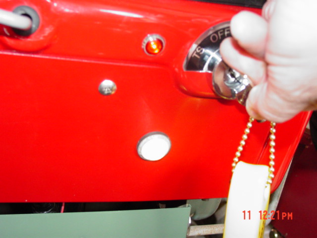

On my 1602D, the thermostart has a timer - so I usually leave the switch in the TS position till the light goes out, then crank her up. The manual says the throttle should be wide open, and I always crank it back immediately to a high idle when it starts - which it always does, easily BTW.

Dave,
which light goes out? I don't think that 1601 has something like this, is this unique to the 1602?
   / Thermostart #9
In this pic, it's the red light just left of the ign switch........
I couldn't tell you if it's unique to the 1602 vs the 1601. I would think they'd be the same..........

Thanks. I don't have one of those lights on my 1601... Looks nice thou..
