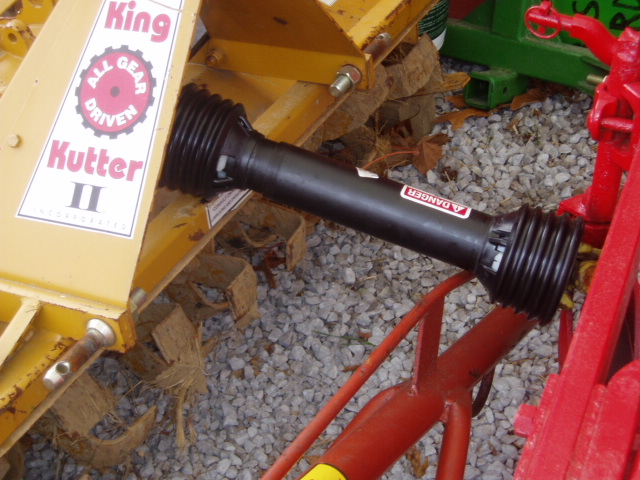

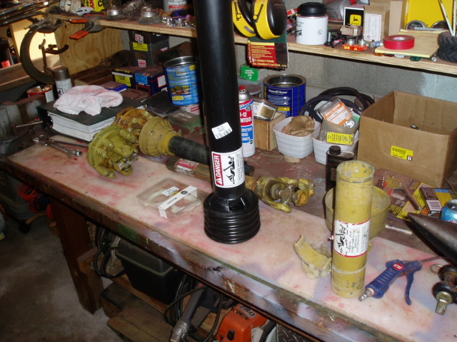

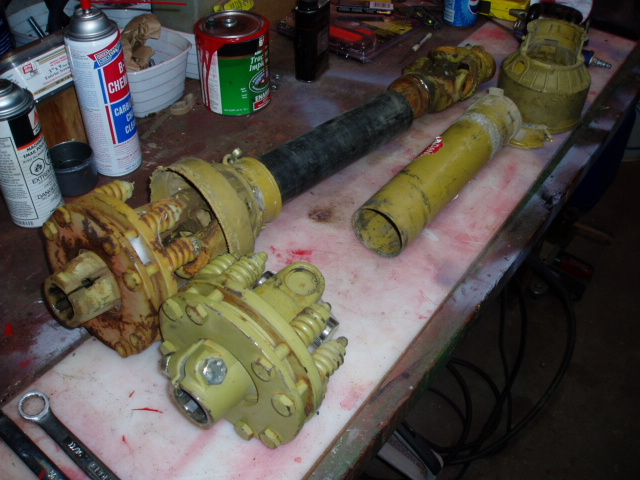

Where do I begin.....
Well, THIS SHAFT doesn't involve Richard Roundtree OR Issac Hayes. (Good ol' movie!)
Todays project. Restore the PTO shaft from my KK tiller to its former glory. The slip clutch is just about ready for retirement. Too many hours with too much HP being applied. The replacement came from Ebay. First stop will be the John Deere dealer just up the road. They've got a selection of "generic" pto shaft guards. The old one is toast.
All parts included, I can revamp this one for around $85. New shaft is $189 (cheapest I found locally)
Let's get started!

hey.. i almost forgot JD sells generic repalcement covers... I need to check on some for my batwing.

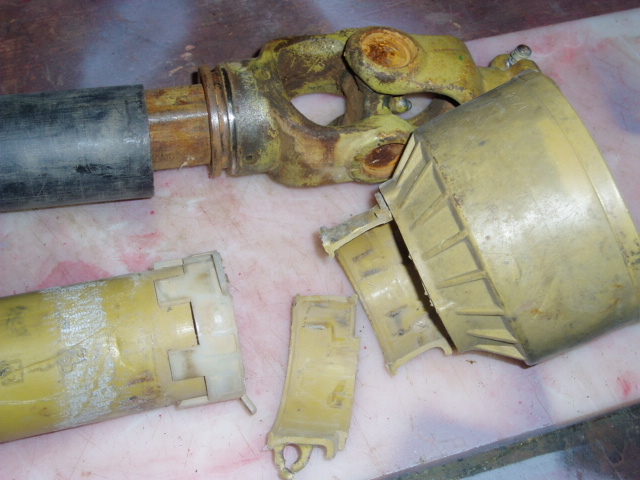

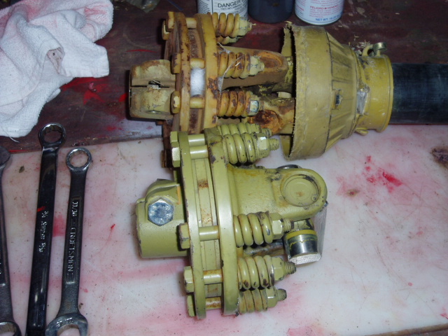

I aughtta work for the government! WAY over budget before I ever FIXED a blasted thing! Deere dealer had plastic shield. Didn't have plastic "bearing". TSC 9 miles further on did. NEW, the shaft sells for $189 and change. I'm up to $112.
But it's fixed ;)
I was planning on a couple more pictures, but this wasn't the cleanest job I've done in a while. Old, BLACK grease, dirt, and some scattered rust. No place for a camera.

To be honest, I didn't think the old one looked that bad. Yeah, the plastic cover was broken, but I problably would have taken that off anyhow. Maybe some new u-joints and clutch discs, paint, would have been good as new.
   / They say that cat Shaft is a BAD mother.....
A new friction disc for the slip clutch and one u-joint was over 1/2 what I paid for the entire assembly. Now I have spare parts too. The old clutch had been smoked. Mating surface turned blue on front casting.
My insurance agent is sorta nit-picky about safey shields and guards.
