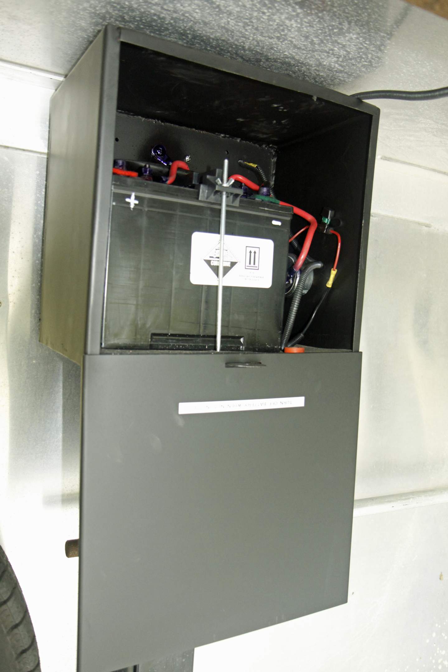

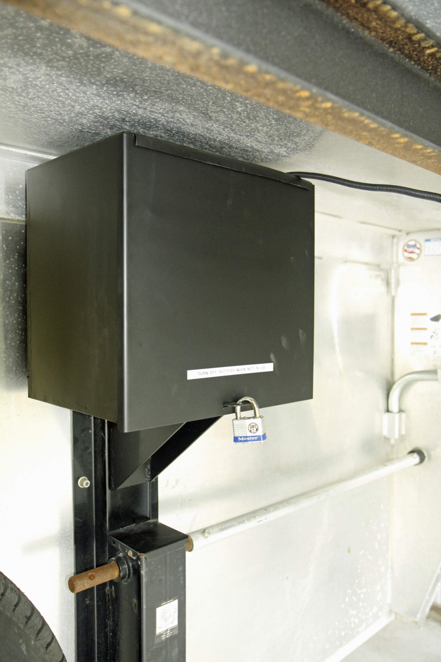

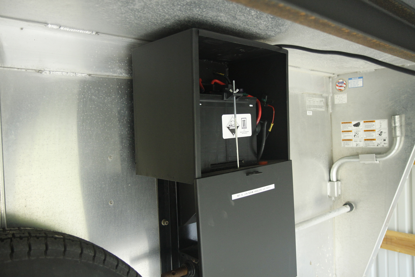

you can also build your own :). I needed a locking battery box for my new gooseneck trailer. The company wanted $300.00 for it. I build one for about $20 in 16 gage steel.

i made mine using a box brake, but you can just as easily make all the sides independent and MIG weld them. The one i made also had a heavier duty (3/16") rear plate and support plate to support the weight of the battery in a moving trailer situation. you wouldn't need to do that
