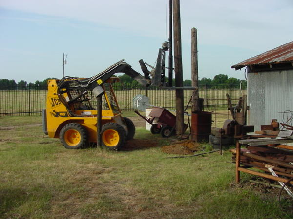

Iris, my tractor, is quite a lady.
Here's one of my attachments I've made for her.
Can you guess what it is?

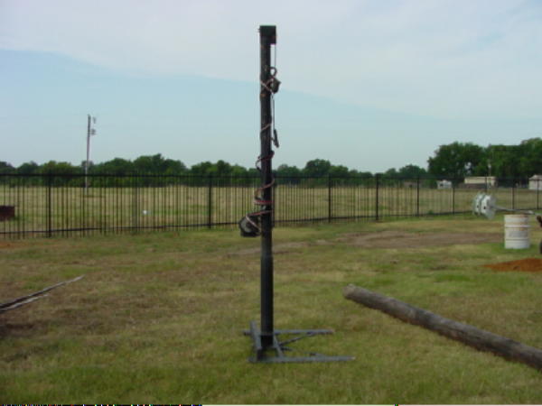

Here it is stretched out a bit and she's wearing it.

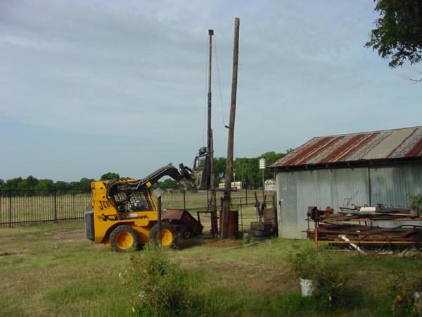

Before she put on this outfit she wore her auger to the dance and did a twelve inch hole seven feet deep.
Now there's this pole...........

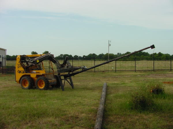

She should be in pictures.
When the boom is fully extended and the forks are lifted to maximum height the shiv is twenty six feet off the ground. She can set a forty foot blackjack safely.
The reason I made this attachment was because I got tired of the butterflies tearing up my gut when I'd crotch a pole between the forks and then drive up it trying to put the butt into the hole.
The winch is a three thousand pound electric with a remote and runs off the tractor battery.
With this set up I've done six inch pipe overheads twenty four feet long by myself.
BTW the reason I know she is a she is two fold. One of course is as long as I'm healthy I'm not gonna crawl in some guy's lap like I do in hers. And I've never seen a butt like that on a boy.
