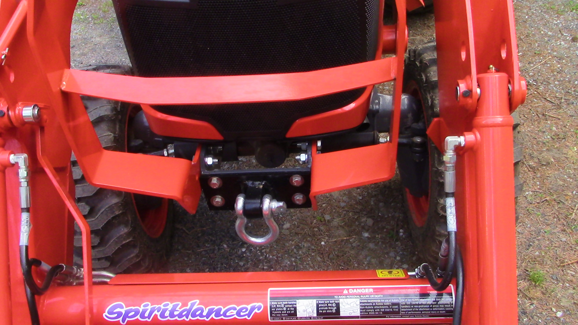

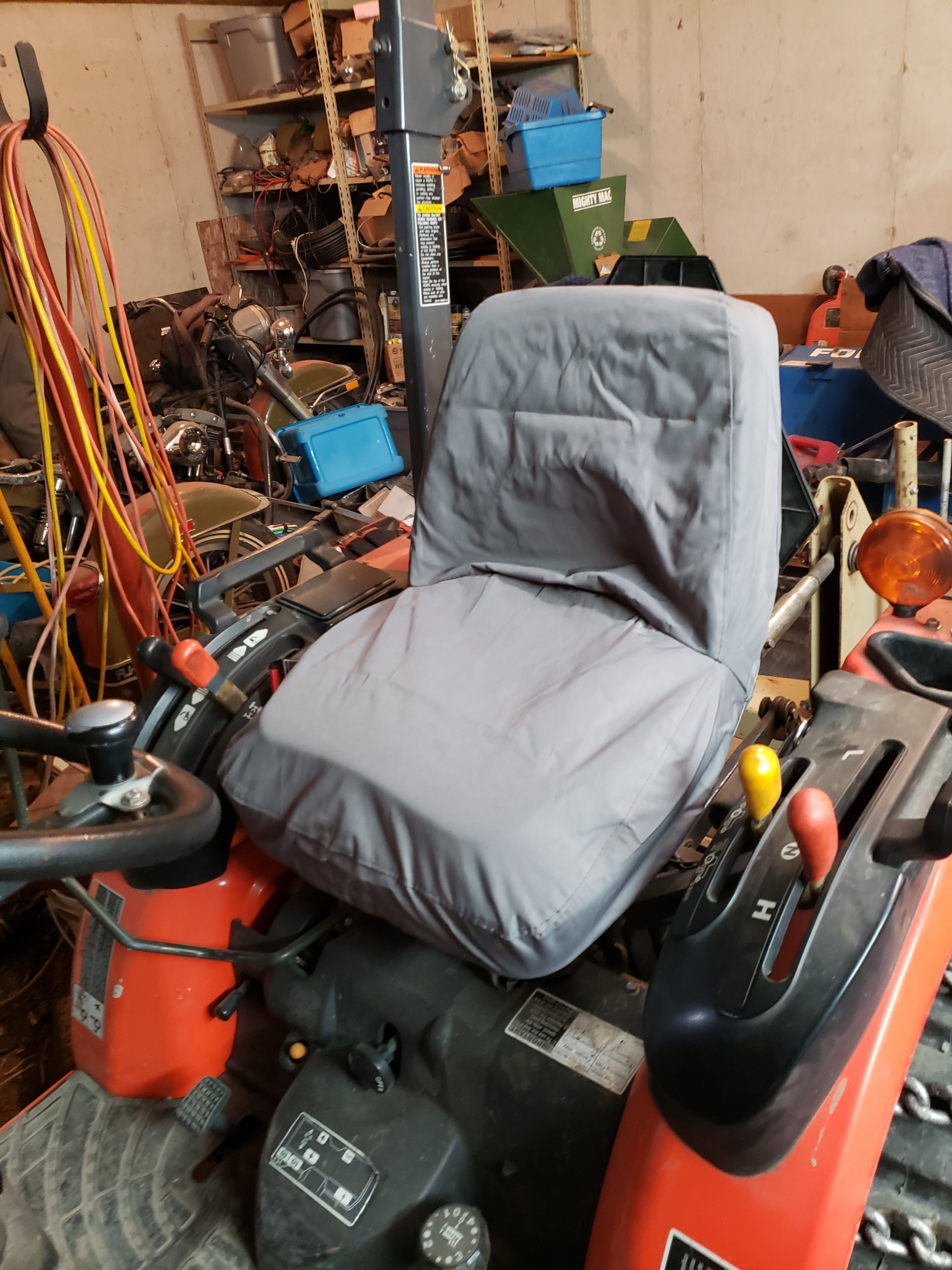

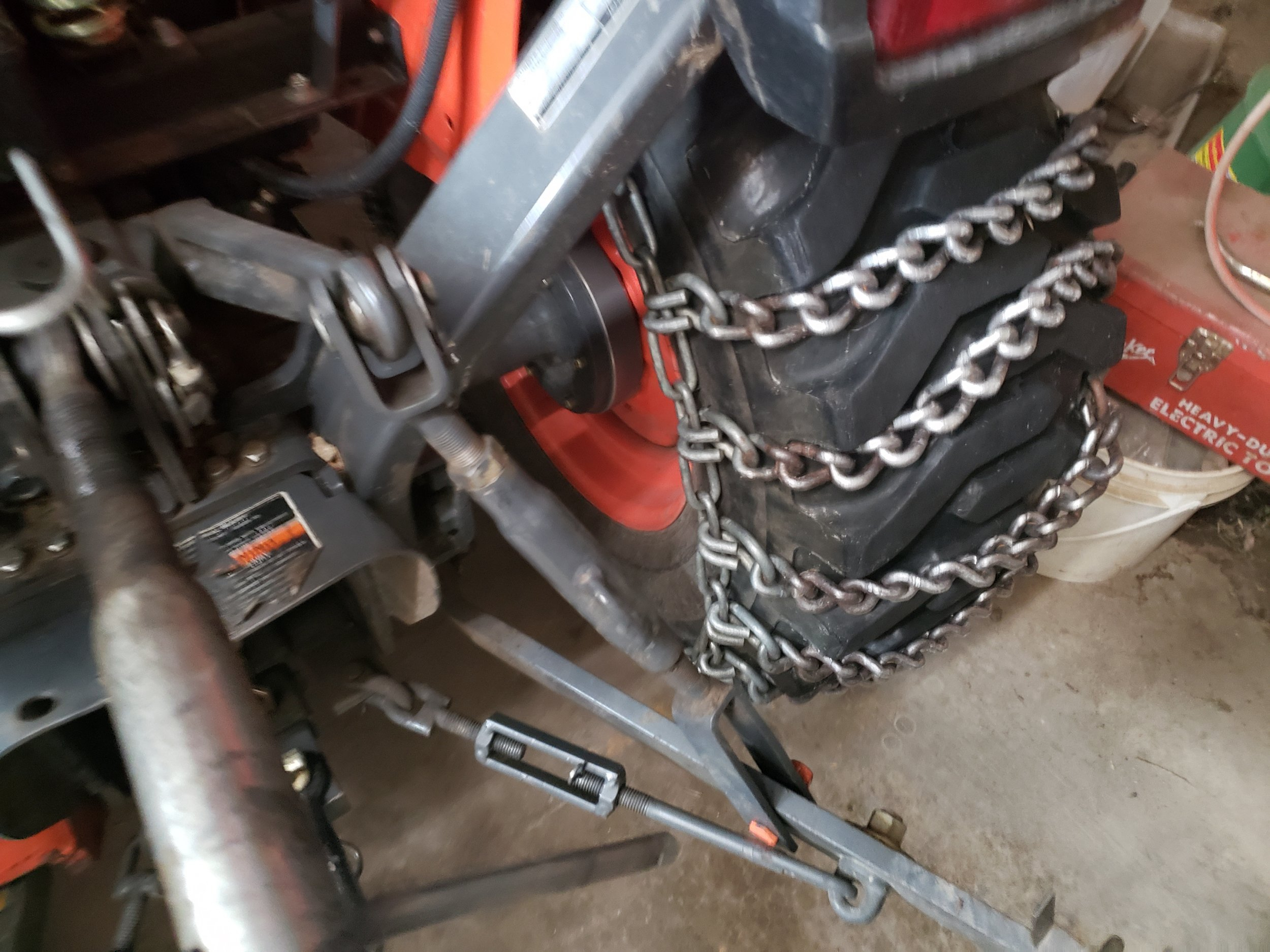

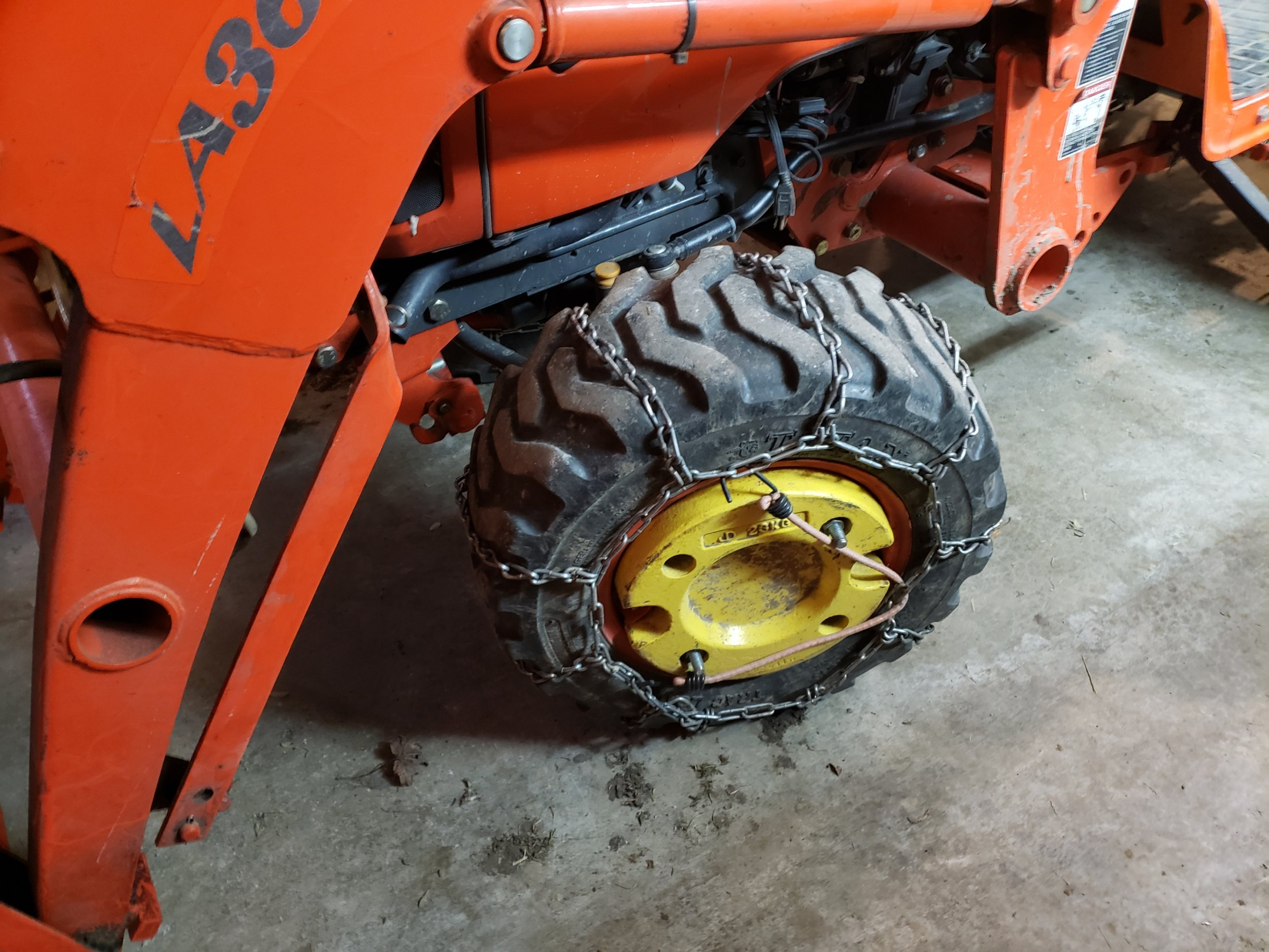

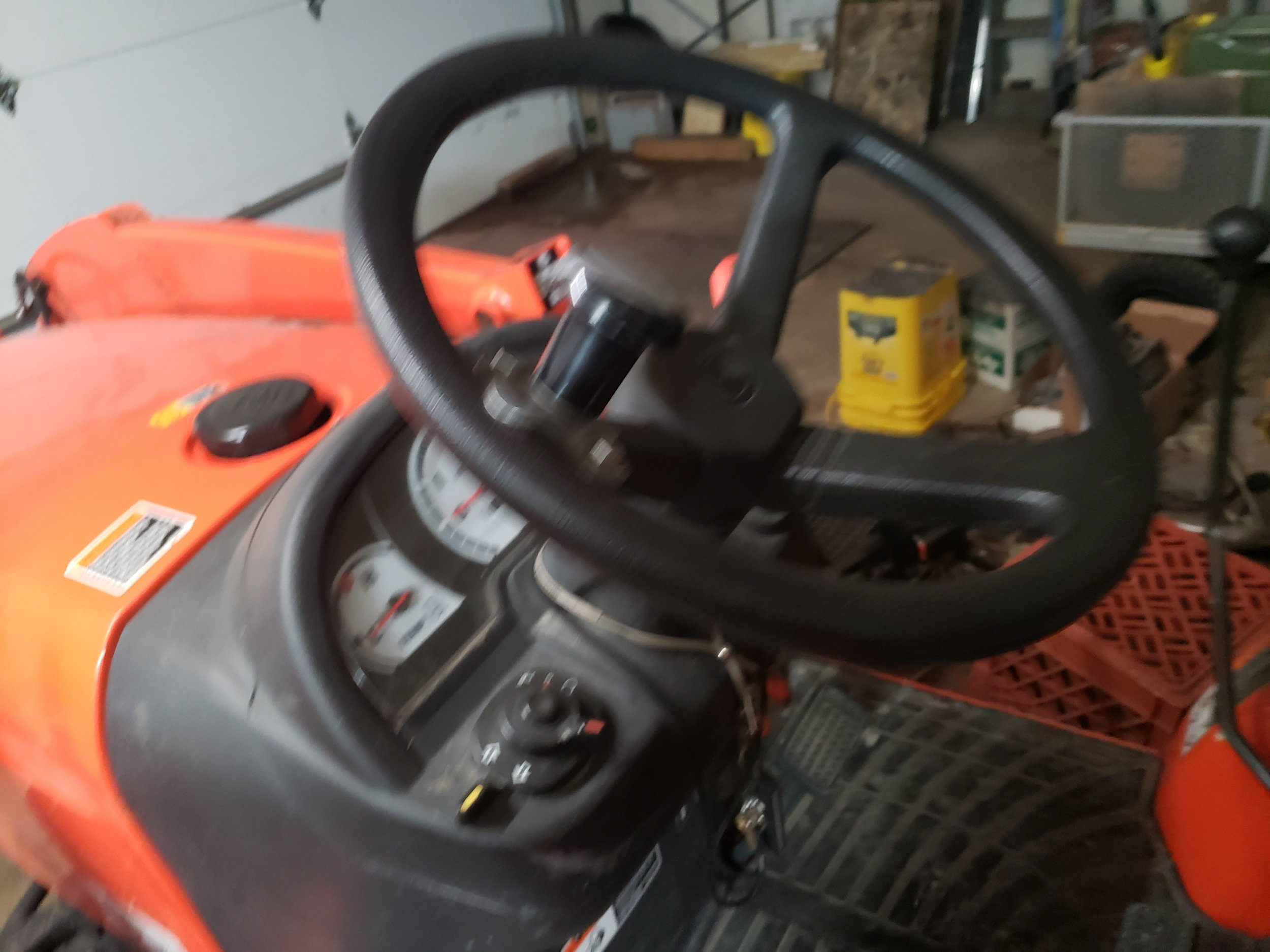

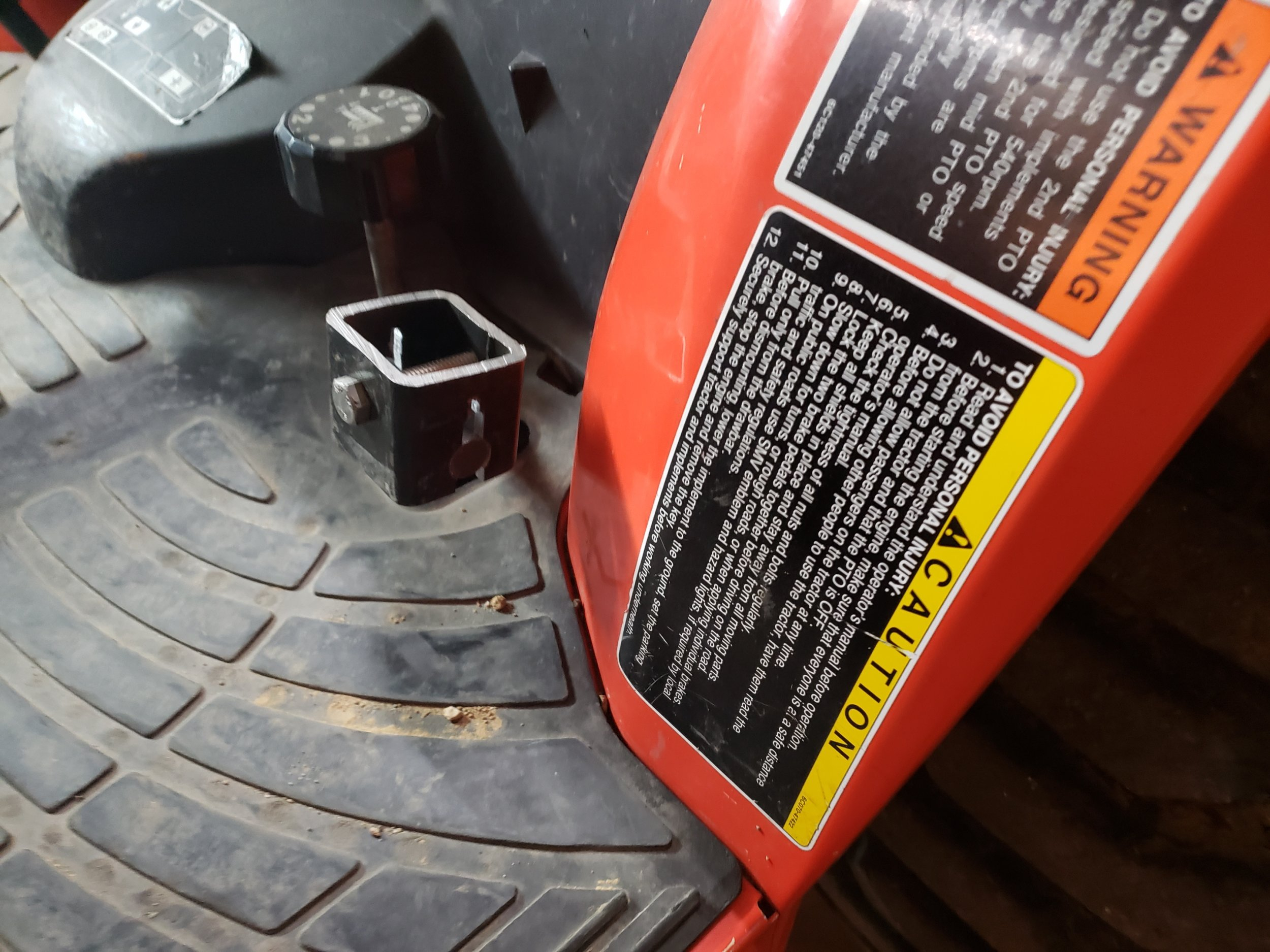

kubota / B2620

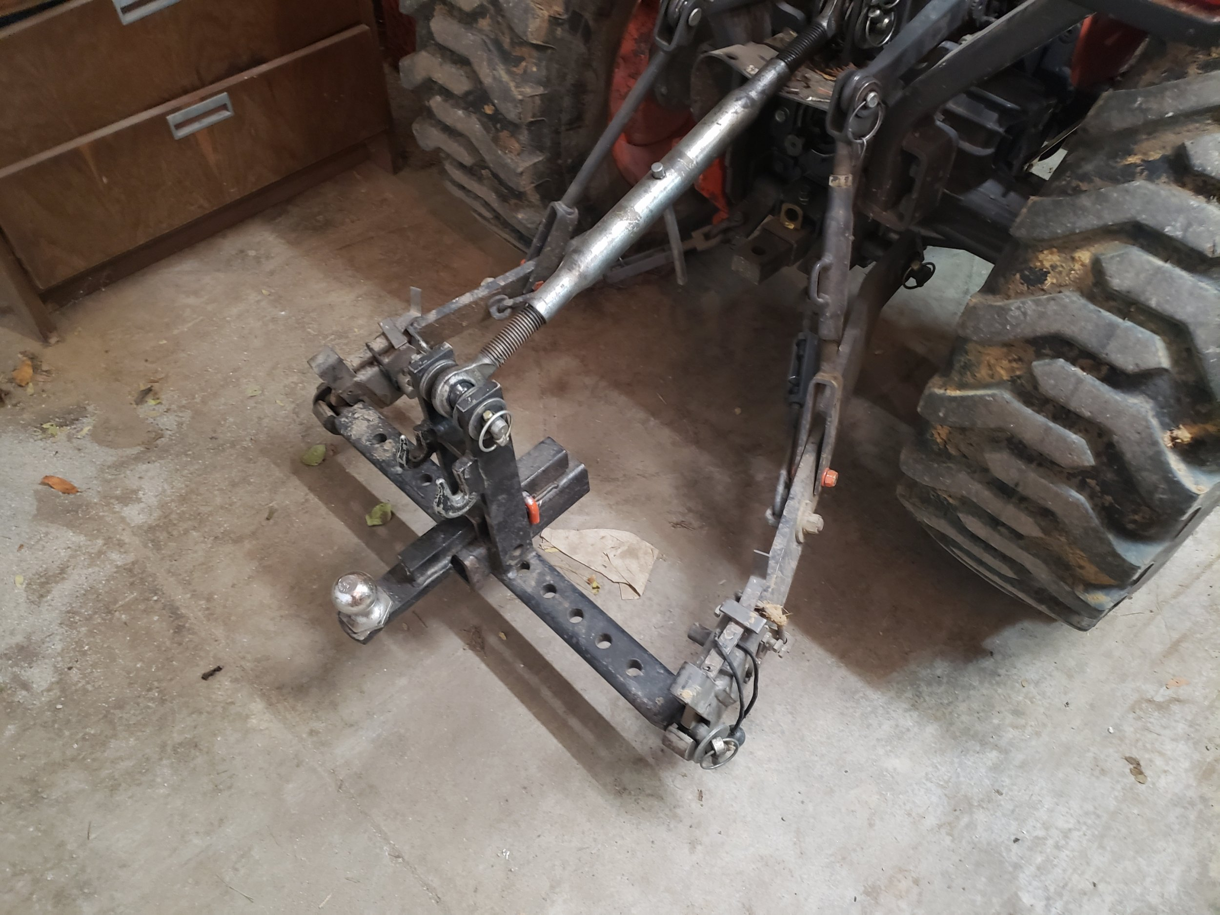

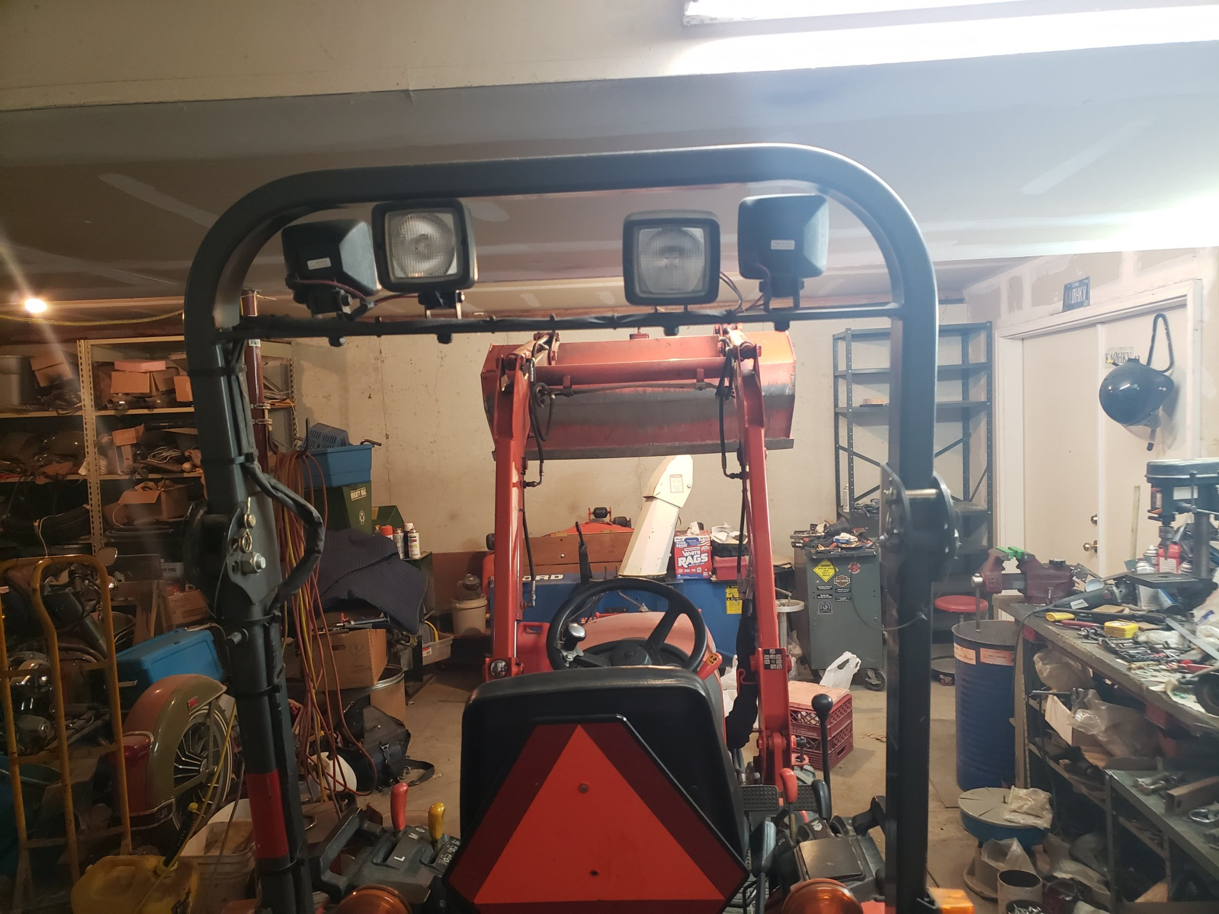

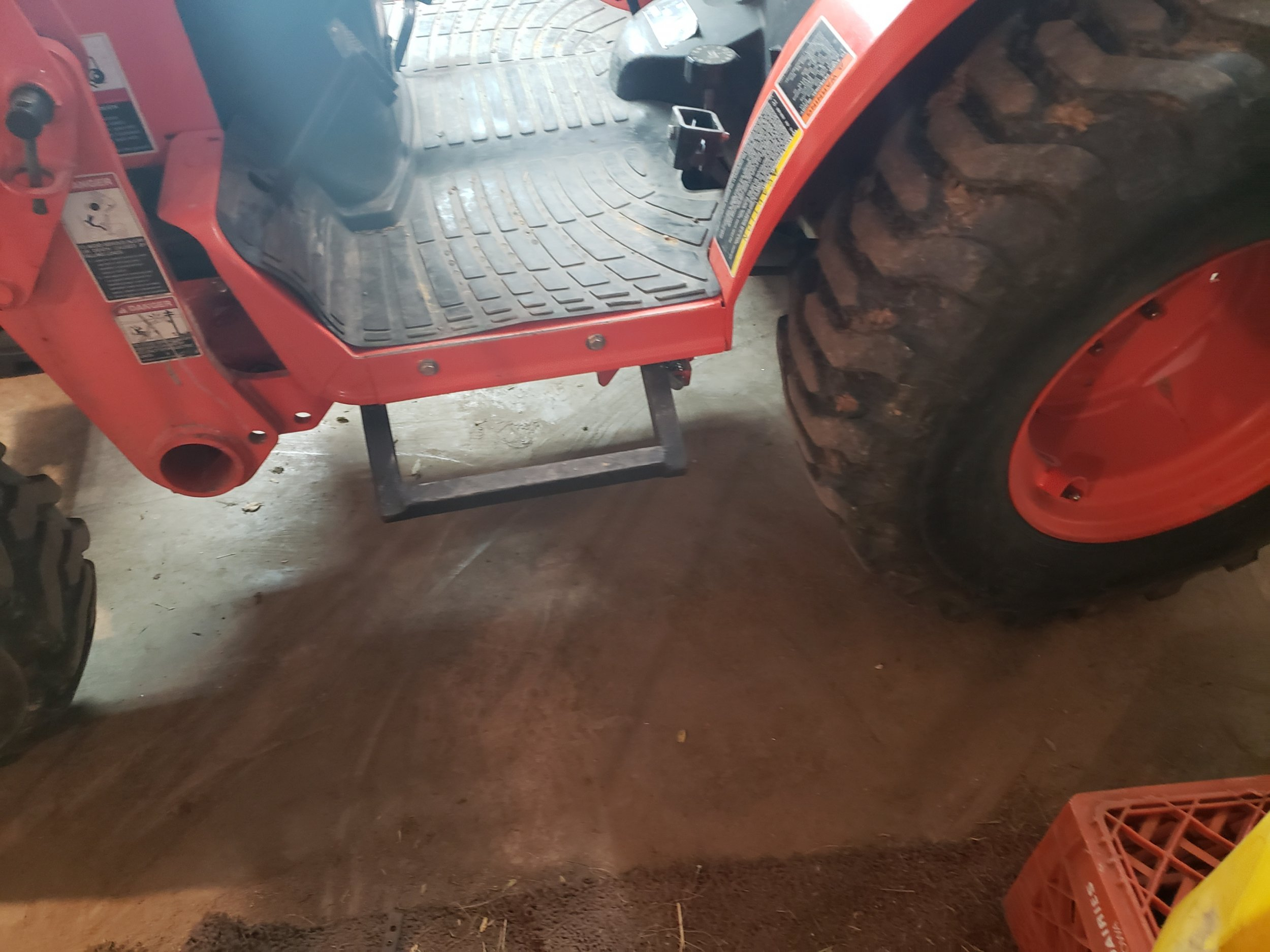

front hitch, side step, 3 point hitch, light bar and shorten 5 inch, pos tack step, seat cover, front weights, 1.5 wheel spacers weighted rear tires, spinner knob, snow skeds and lift points.

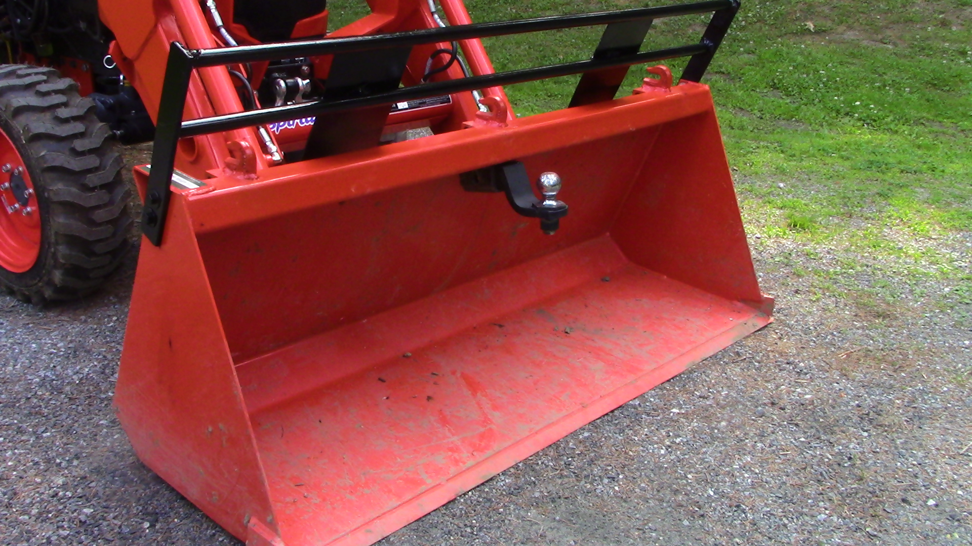

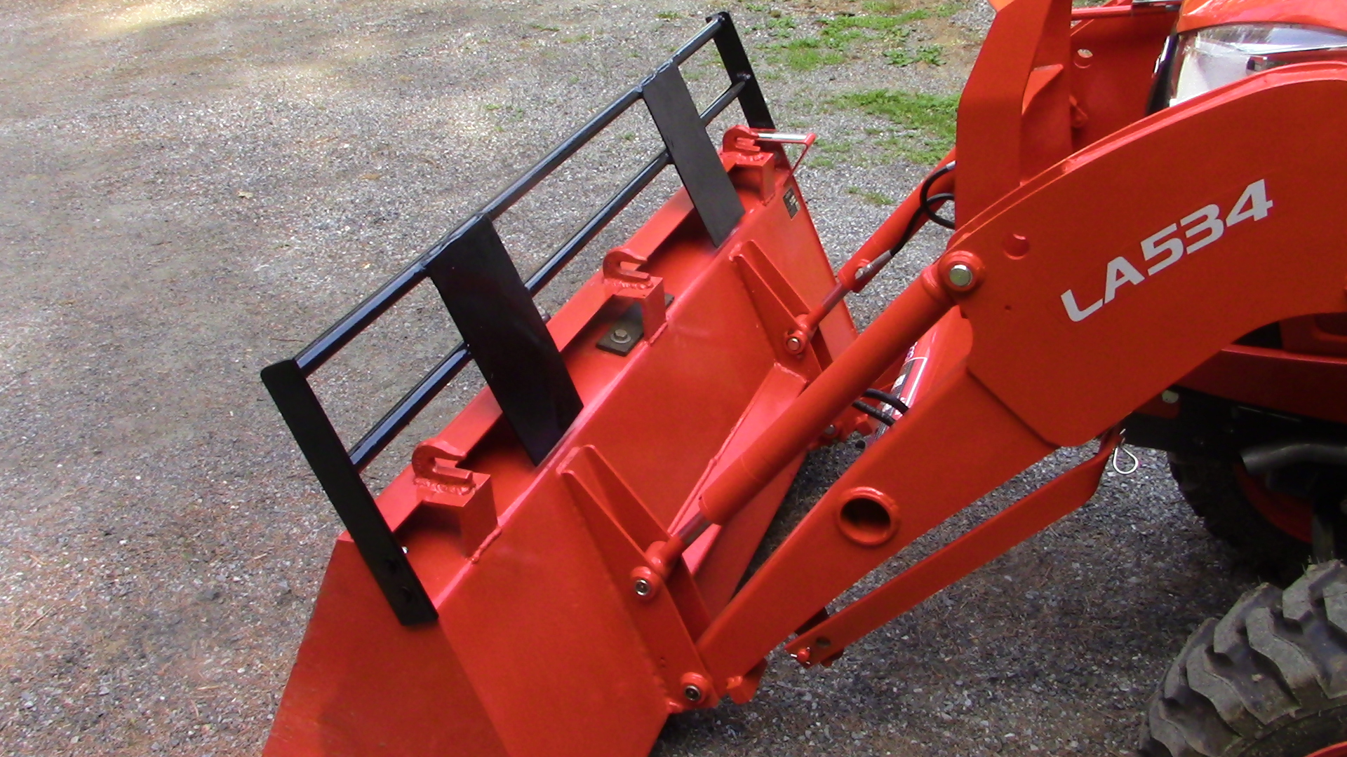

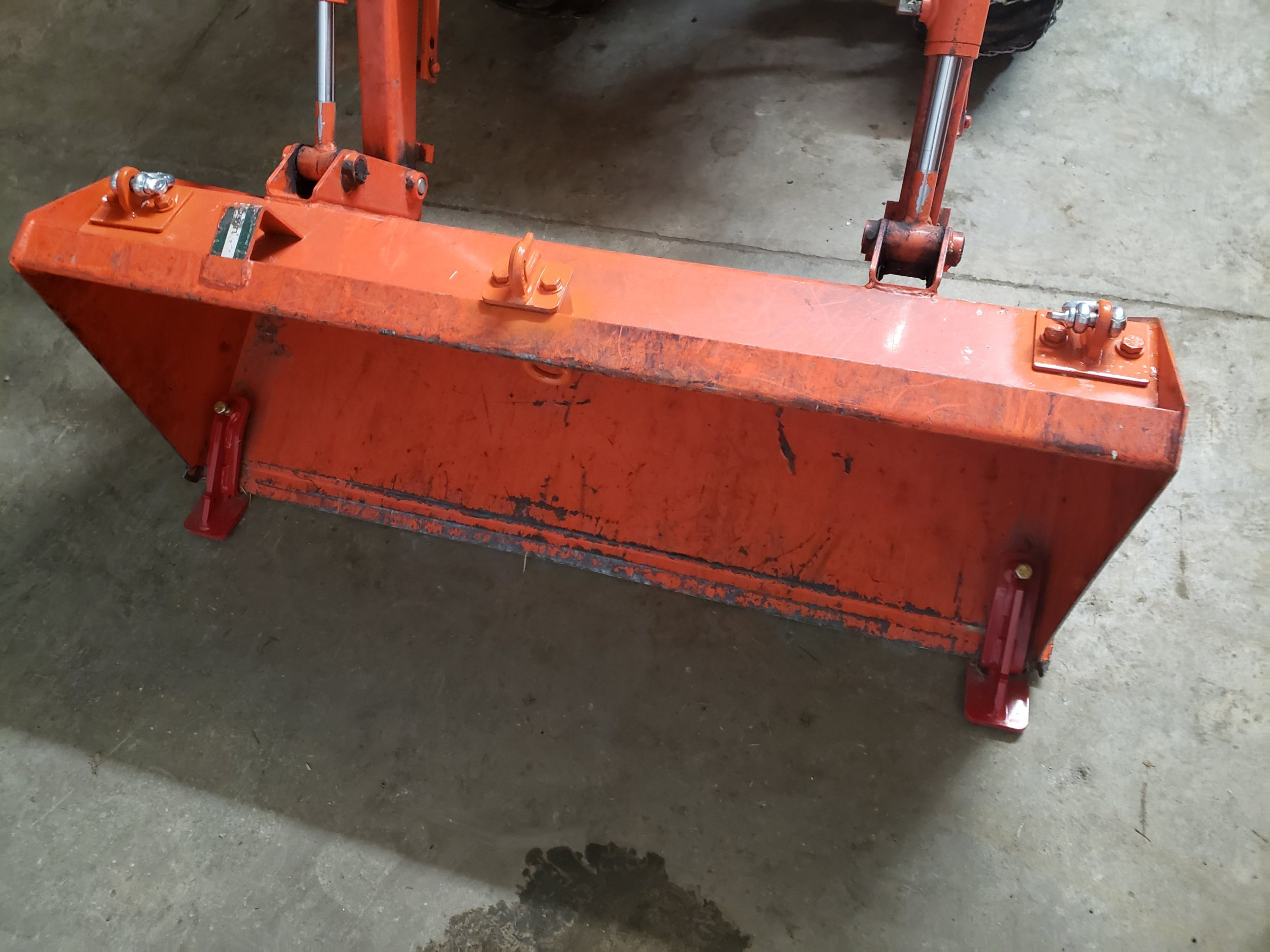

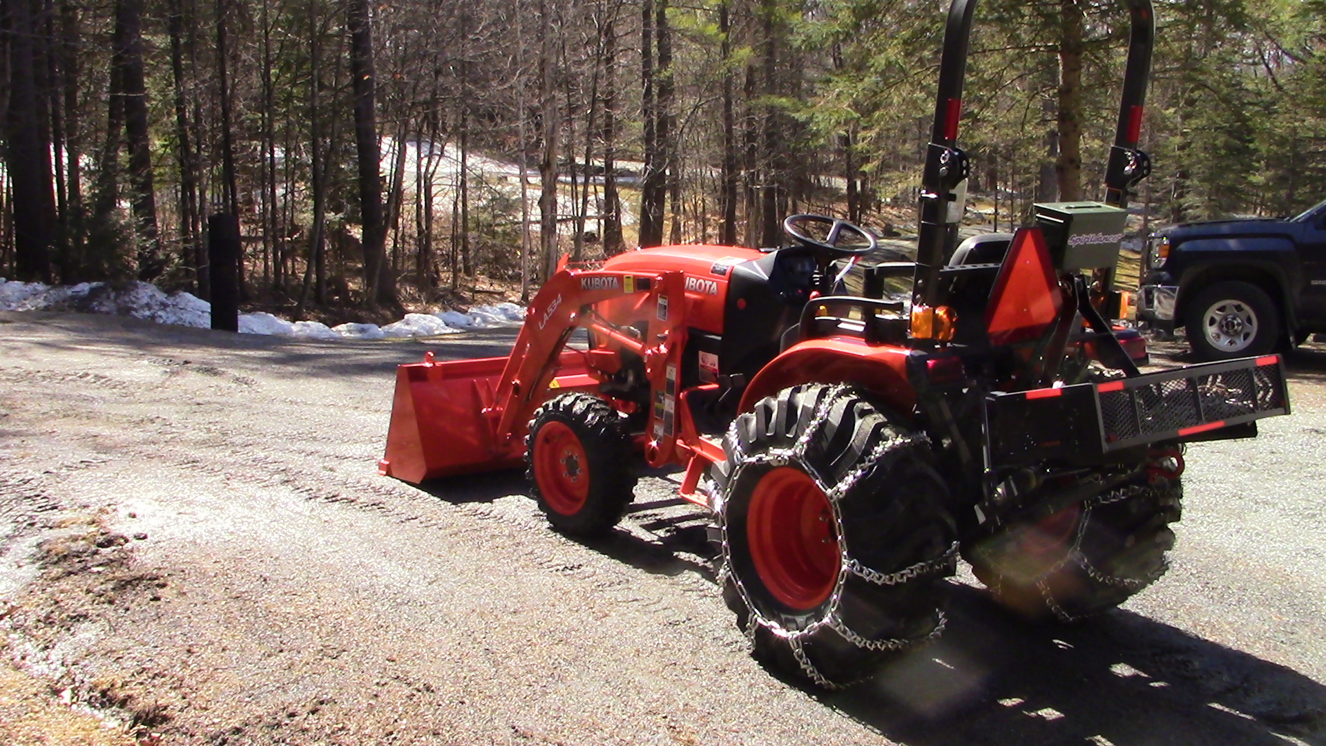

I also couple things on our B2650 this year.
Bucket guard has come in handy number times.

My NH is a bit higher than my Yanmar, so I've been thinking about adding a step as well. Along with a light bar. Winter is upon us, so I have all winter to plan.

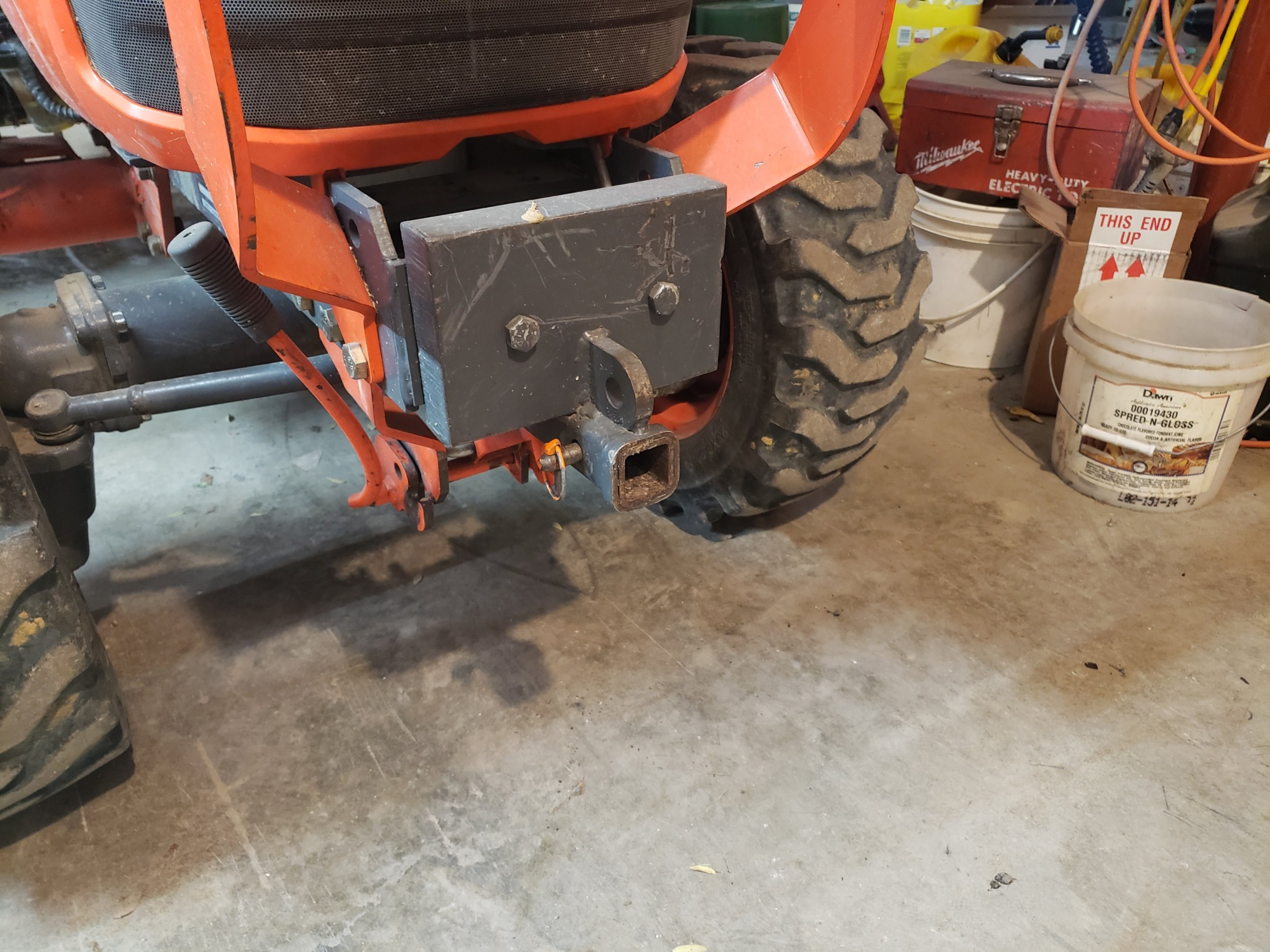

Oakglen is your 3point hitch thing welded to the drawbar ? Or maybe just bolted ?
After seeing so many tractors with damaged front grills I have been seriously considering modifying the grill guard on my LS

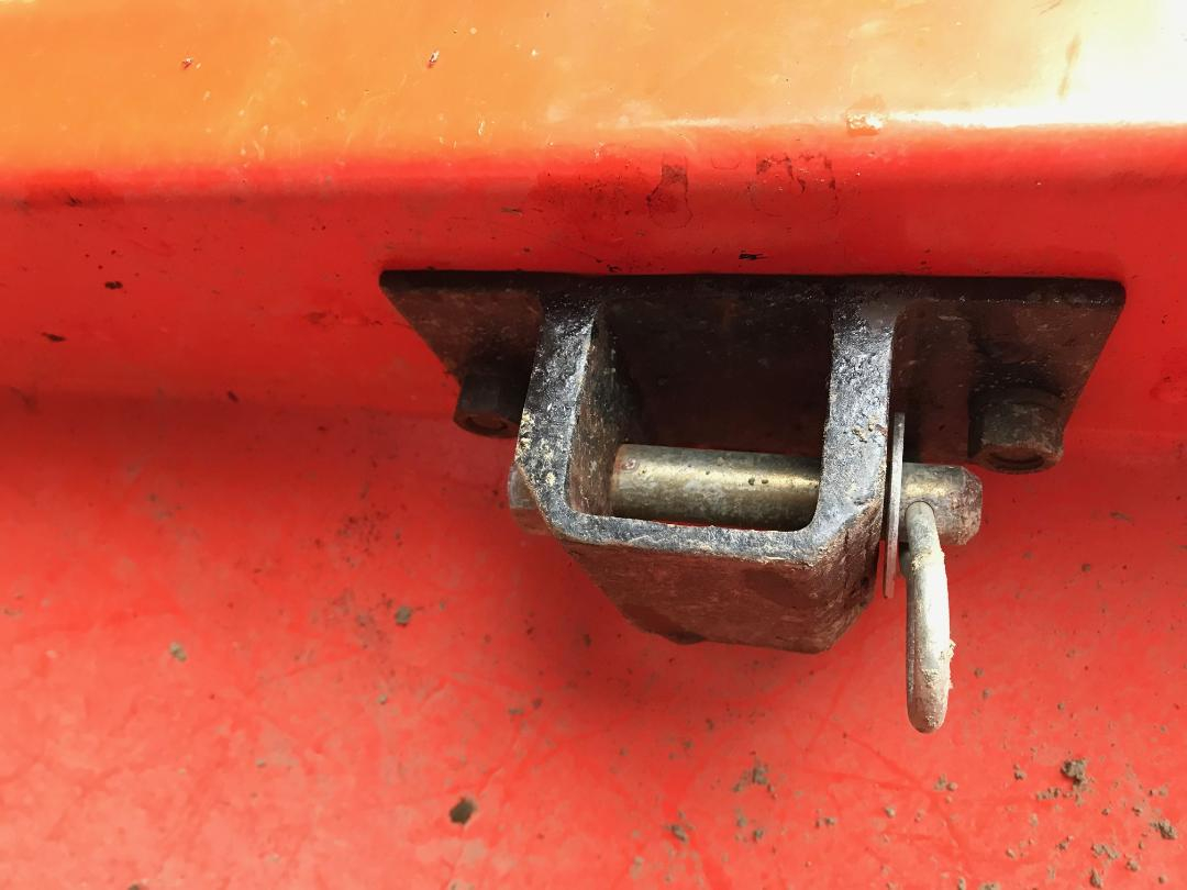

Making stuff is just as much fun as operating !
Thomas where do you have those receivers mounted ? What are they for - forks maybe ??
Yes sir it is.... I'm sure have come up some good to great ideas over the years...care to share some pics from over the years.
welded

I like your front wheel weights. I might have to look into doing that on my tractor. Are they factory or something you made work?
