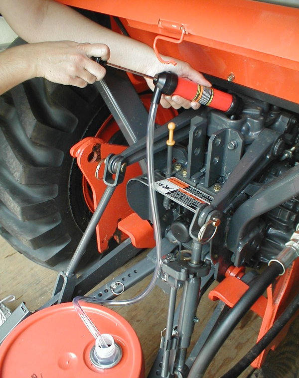

I put it off for a couple weeks 62 hrs now. I read the manual as I did the change and it took me an hour or so. 14.5 liters of fluid is capacity I measured so carefully. As I was patting myself on the back for a job well done I realized I was was over on the fluid. Hoses must hold quite a bit of fluid:eek: After draining some back out and making a mess on the floor I completed the fluid change:D . So when you do your 50 hr oil change check the dip stick as you fill . It really was easy other than the extra work I created for myself.

50-hr service is a walk in the park ... heck, on our B's you don't even have to jack anything up (unless you're also changing your front axle oil). Just be sure to find / remove all of the 37 various drainplugs required to drain everything :rolleyes:
One tip I can offer about filling the HST is first buy your SUDT in the 5 gallon pail (cheaper). Then get a siphon pump kit from Harbor Freight (#3878), they usually run about $9-10, but they're on sale alot for $5-6. Run your pickup hose down into the pail, stick pump outlet directly in your fill hole, and pump away. It took 5-10 mins to pump ~4 gallons into my trans. No fooling around with beer bongs and whatnot, taking a chance on making a mess and wasting that "liquid gold". When you're done just let the hose drain back into the pail.
Anyway, I got my lovely assistant/wife to demonstrate... see pic.

Noticed the same thing when I changed my oil. Now my stick reads about 1/4" over the full line. Made enough of a mess draining it the first time as it was WAY over. This is not engine oil so I doubt going over the full mark will do much harm. 1/4"? Close enough :D!
"Then get a siphon pump kit from Harbor Freight"
That is an AWESOME idea I'm gonna look into that!!!
