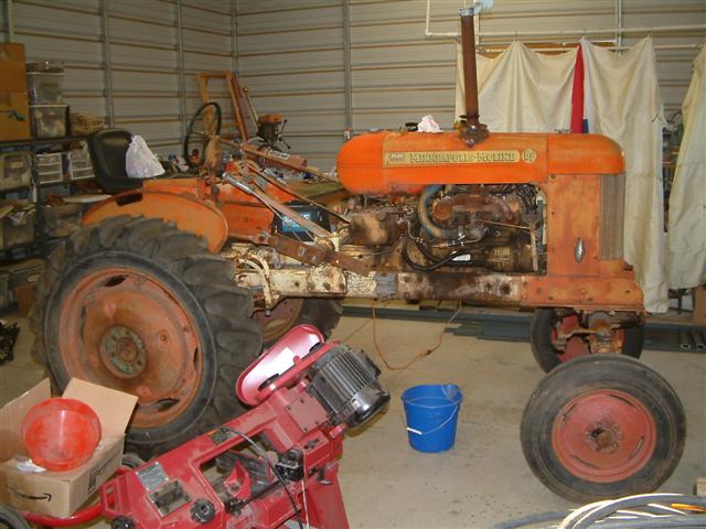

I'm getting around to the point in the restoration effort on my 1951 Minneapolis Moline BF tractor
http://www.tractorbynet.com/forums/...eapolis-moline-bf-restoration-continuing.html
where I need to get serious about the electrical system. Been wondering if I should convert from 6V generator-style to 12V alternator type. It's an easy conversion.
However, my concern is with the starter-- it's a 6 volt Delco Remy 1109609. I understand that you can run a 6V starter on 12V provided you limit the time you crank the thing. The concern is with the Bendix operating at 12V. From what I read, the Bendix will move faster at 12V than at 6V and might slap the ring gear on the flywheel hard enough to damage it.
Am I worried about nothing? Or is it a potential problem?
