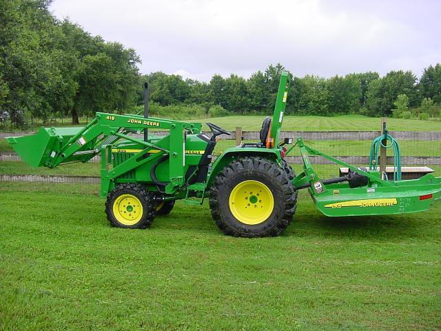

I own 3 acres and mow 5 acres, all is flat land without trees and my 790 does a great job. I also have a 3 bin compost system and the loader will pick up a wet load of the stuff easly.
For the money I don't think you can put your backside in a better "basic" tractor for small farms. Now what is it that you call "rolling" I'm not to sure about how sure footed it would be on hilly land.
The wet brakes and dry brakes have been nagged about on this site for a long time, I'll give you my outtake on it. Wet brakes last longer dry brakes wear out faster. Wet brakes I have to go to the dealer to fix, dry brakes I fix in the yard, oh and by the way.....my brakes are working just fine.
There is one little thing that pissed a couple of us new buyers off and it is the fact that when we shopped the tractor it was explained as a 30hp/25hp pto tractor and it's really a 27hp/24hp pto.
I gave 14,100 for mine with ind. tires / 419 loader / lx5 hog and yes I would buy another one in a heart beat.
Whiskey

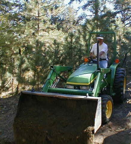

Kevin - Have a 2000 JD 790 with about 300 hours. Original brakes still hold very well. Weight distribution and sensible operation on hills are important with any CUT. I use wheel weights and carry something on the 3pt. Have a 5' Howse Brush Hog and a HD PHD which the tractor handles easily. Only problems have been a small injector pump leak (fixed with a new gasket) and battery corrosion caught early (new connectors and sealed battery). Otherwise regular maintenance. Always starts reliably. My local JD dealer is great about getting parts, however I do all the maintenance/upgrades myself. The tractor is much easier to work on than most cars today. Not quite sure about your concerns with the PTO gear drive (it has a 2 stage clutch if this is what you're looking for). Hope this helps. Here's a "working" picture...

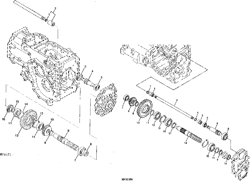

My concern with the PTO drive is that the 990 and other models use a planetary gear drive and the 790 uses a spur gear. Any inherent weaknesses with this design? From all the comments you guys have given me, there doesn't appear to be any. I was particularly concerned about the ability of the tractor to drive my 5 foot rotary mower, but if it will drive your LX5 it shouldn't be a problem either.

I'm certainly not a gearbox guru, but after looking at the pictures of the 790 vs. 990 rear PTO there doesn't seem to be a whole lot of difference (see attachment - 790 on left, 990 on right). Maybe someone can 'splain the difference...
I agree with Zuiko that the 990 is a more substantial work horse assuming the extra $'s are not a problem. However I prefer the smaller size for manuevability around the stable, and power for me is not an issue (even at 8000' where we lose 25-30% power for normally aspirated engines).
