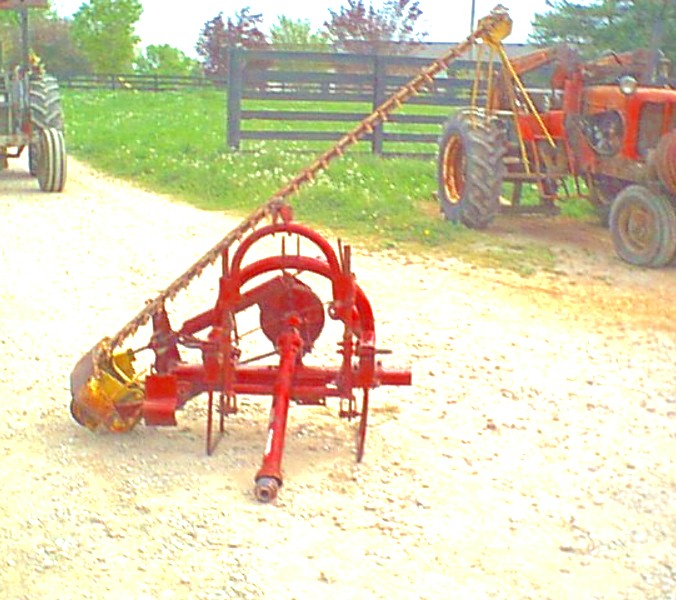

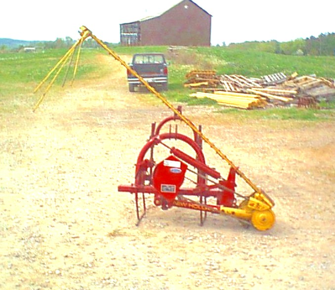

We have just took in on trade to a new disc mower a real late model 451 NH and can sell it for $2850 and I guesstimate the shipping to a business in your area to be around $125-$150. Also have 2 JD #350, 1 MF #41 and 1 IH #1300 and 10 Ford 501 and 1 JD #9. These mowers run from $795 to $1750. Ken Sweet
