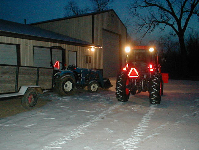

You can always do what I did, have one of each of the major three, however the JD is a full size TLB.
Each tractor has its place, each a different size, each dealer is different. Have not used the service of any of them. However the JD dealer jacks up his parts prices, the NH charges regular retail prices. Parts availability seems good at both of them. Have not had time to judge the Kubota dealer as parts yet as it was just delivered.
The cabs on the Kubota are great, only an hour on it, but I cannot say enough about the cab worklights, both front and back. It sure will be nice to operate the loader in the dark, including just driving down a trail, and seeing what is ahead of you without the bucket blocking the light.
