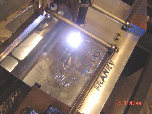

And I'm wondering if anybody has one - how do they like it - any problems - what are the different options on the system ?, etc.
Eventually I'd like to get a CNC plasma table - but in the short term I'm going to build a pantograph table. I've already ordered one of
the tracer/pantograph setups from Rotten Leonard's and I'll build a table to go under it.
The tracer is setup to use a hand torch - as are some of the tables like the Plasmacam. What I'm wondering is - can I upgrade the Hypertherm
later to use a machine torch , or - can I (and should I) - just order it initially with the CNC card installed - and they use it with the hand torch
until I'm ready to use a table.
Or -alternatively - is there a way to interface into it with the CNC card and just use a footpedal or something like that to activate the torch while
I'm using it on the tracer setup?

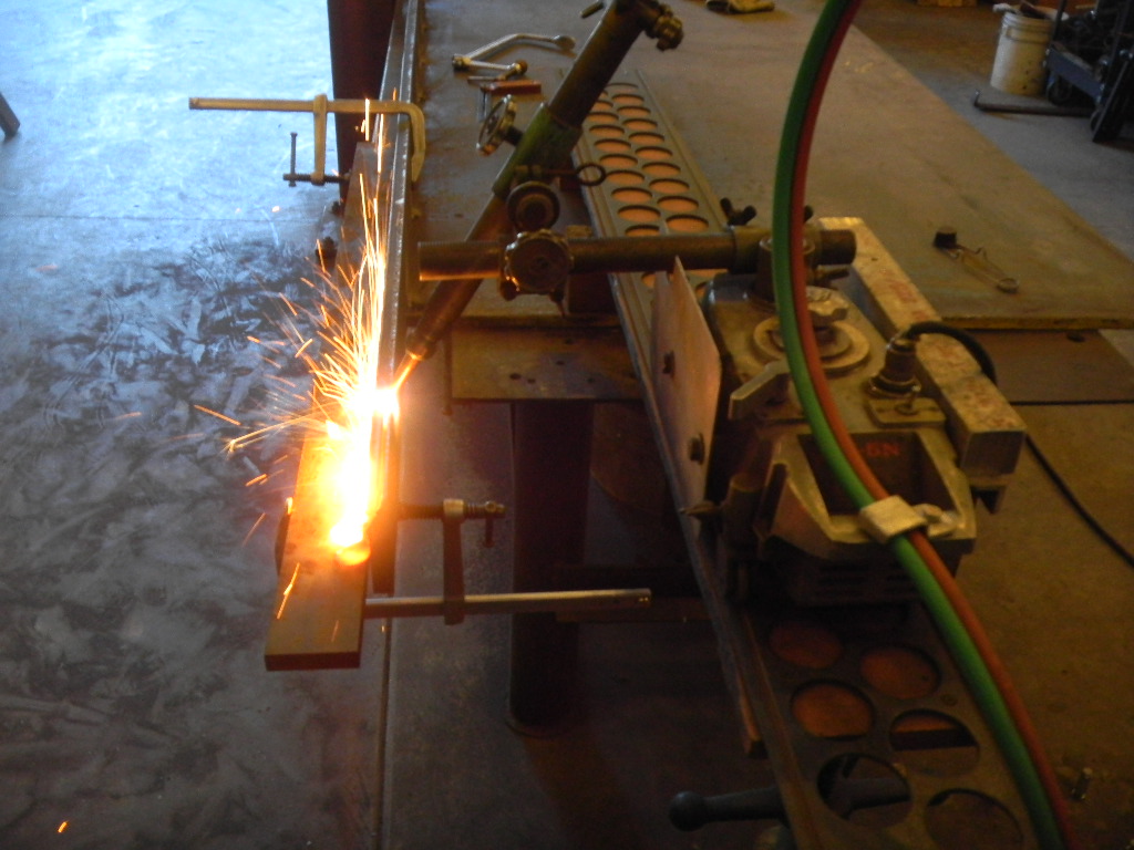

Unless you're doing a lot of thin, or non-ferrous metal work. I consider a plasma cutter a luxury. My CNC table has a set up for O&A but I've never used it.

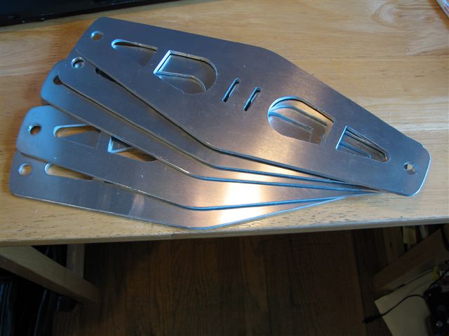

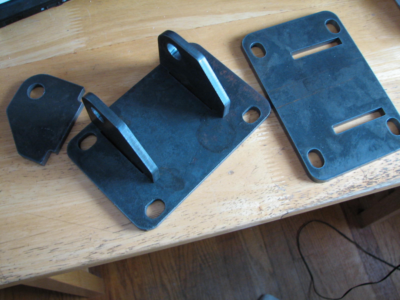

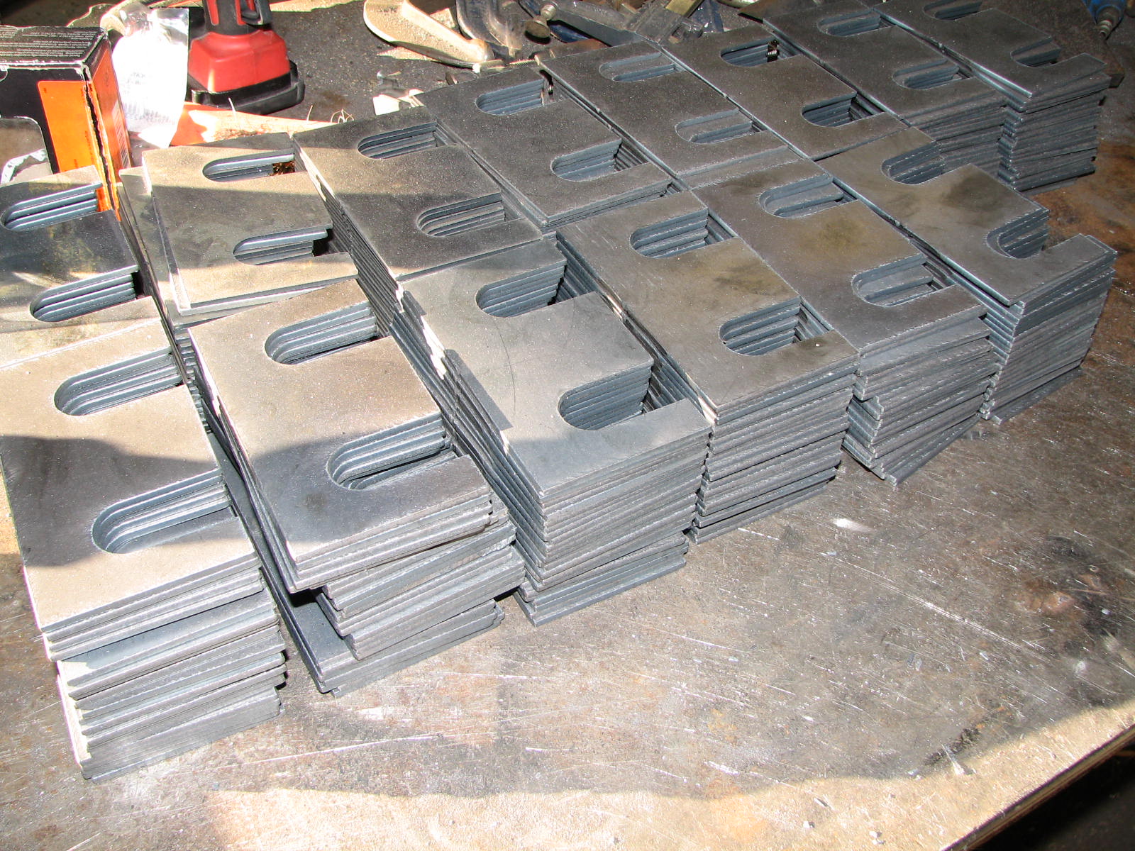

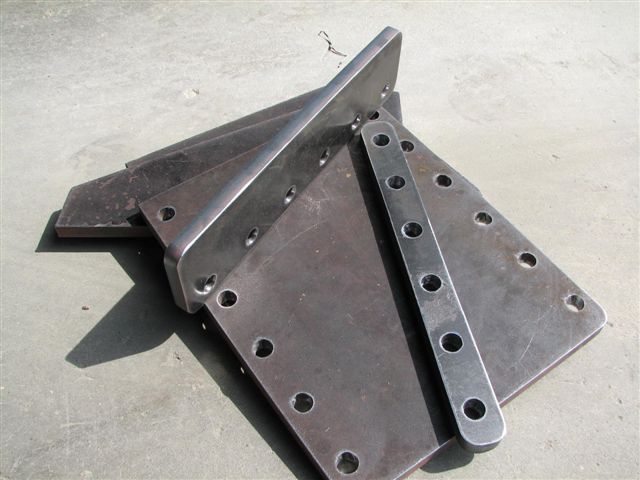

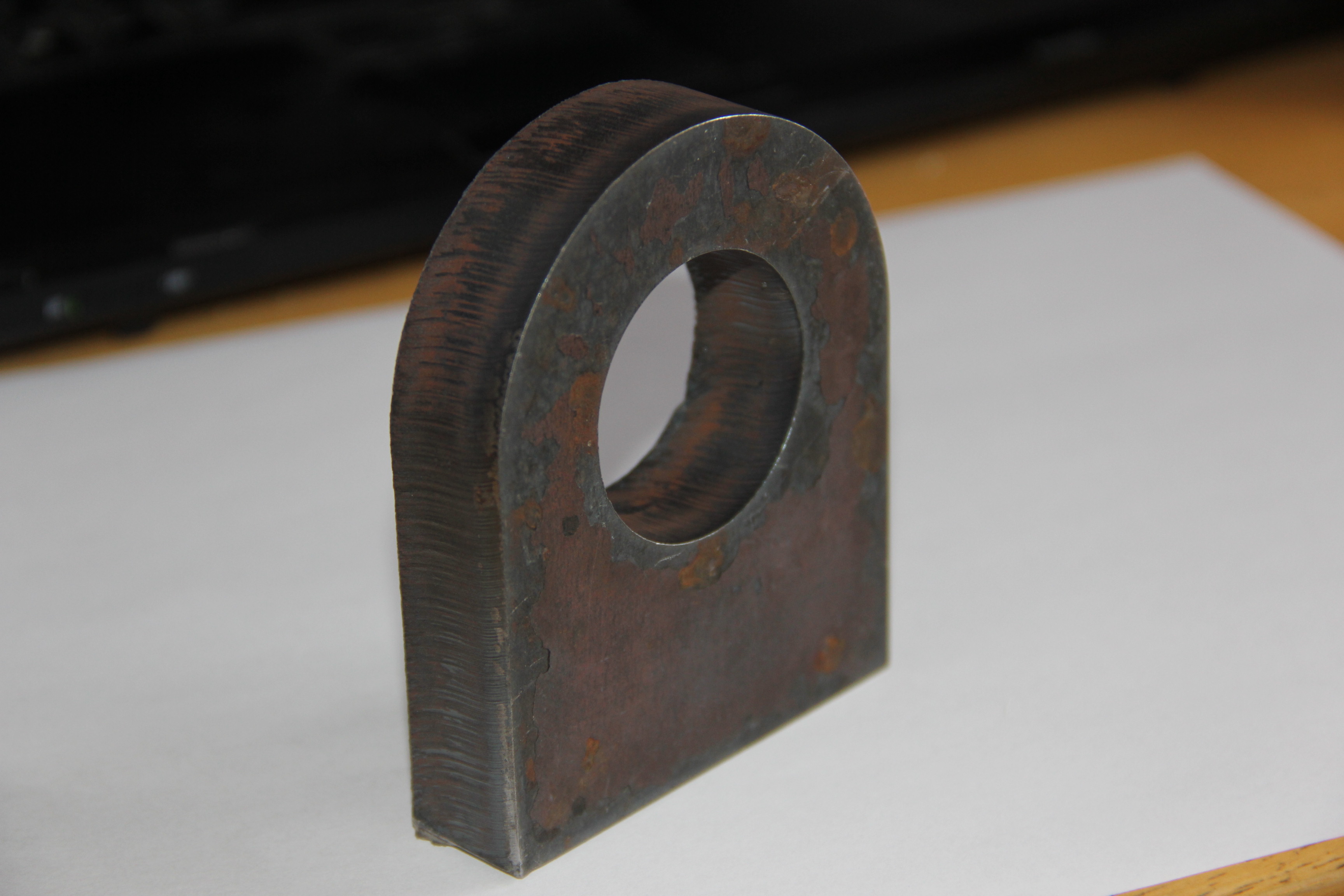

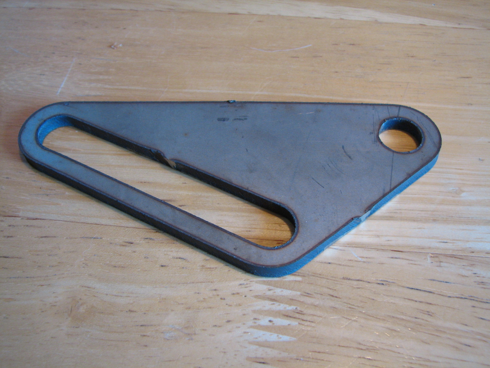

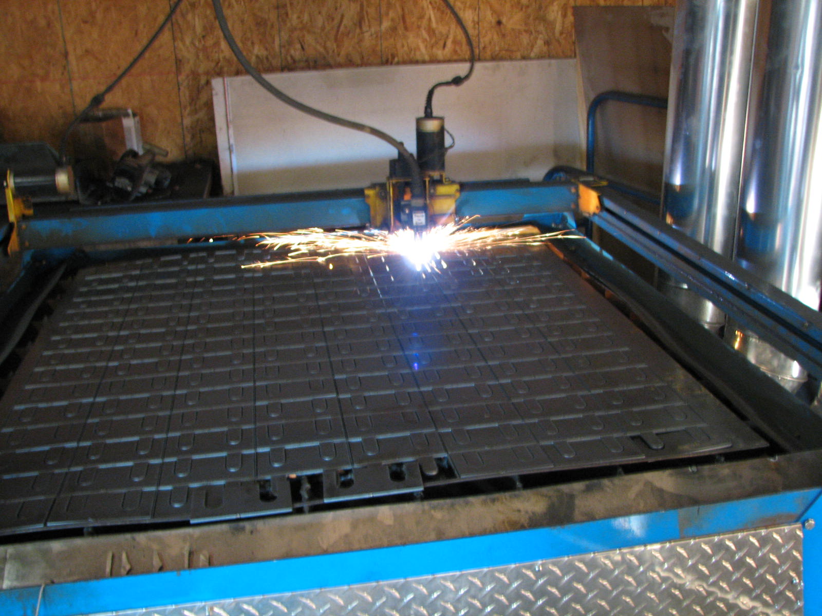

Not sure what you consider thin. My Powermax85 is used daily.....sometimes on my cnc table, sometimes with the hand torch. 95% of the cutting is steel....from 26 gauge up to an inch on the cnc, and up to 1-3/4" with the hand torch . I switch from hand torch to machine torch in 20 seconds with no tools, no gases to adjust. Consumable last for 600 to 1200 starts on the cnc and it seems like for months on the hand torch (not used quite as much). My oxyfuel torches are used only for loosening stuck, rusty bolts and for bending / heating.
I am showing some typical daily work....some steel, some aluminum, some stainless. The cuts are fast, use no compressed gases, cost pennies per foot of cut. Yes the plasma costs more to purchase, but the more you use it...the cheaper it is. The shim job (1/8" steel) in the pictures consisted of 800 shims, after material and overhead were paid it cleared $800 in 2-1/2 hours work. Typical cnc plasma with a Hypertherm afternoon! Not a luxury in my shop, its the major money maker!
Here are a few pics of plasma cuts:
IMG_2948.jpgIMG_0624.jpg.250 cuts 001.jpgpowermaxcutsamples 002.jpgIMG_2766.jpgshim job 004.jpgshim job 003.jpg
