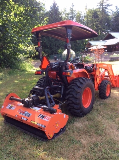

For many years I did everything manual, then I got old so spent $2700. for three function controls on my new 2501 when new and very happy. Yeah, it cost pleanty but so much more uses now than before and much easier to mount my impliments and run them! The side shift on the flail mower is very handy around trees, fencelines and rockeries. Tilt cylinder is great for the driveway edges when pulling gravel back over as well as having a fast hitch attachment.
