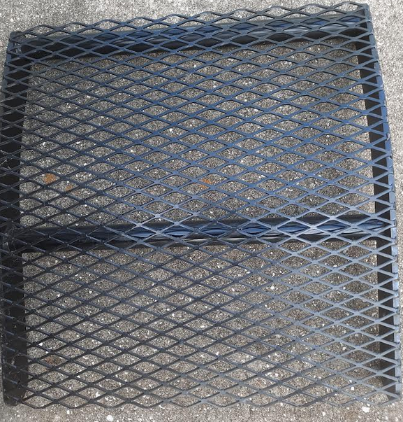

Beezz27, don't forget to protect your radiator when you get your grapple. The grill guard that's on there won't stop anything from going through unless it's over 12" in diameter. I took my grill guard to a local metal working shop locally and asked them to weld expanded metal over it They called me the next day that they had it ready and I was really happy with the work they did. I figured they would weld several spots on each side but they welded each spot where the expanded metal contacted the guard. That's about 25 welds on each side. All welds were ground smooth, cleaned up and the entire guard painted.
