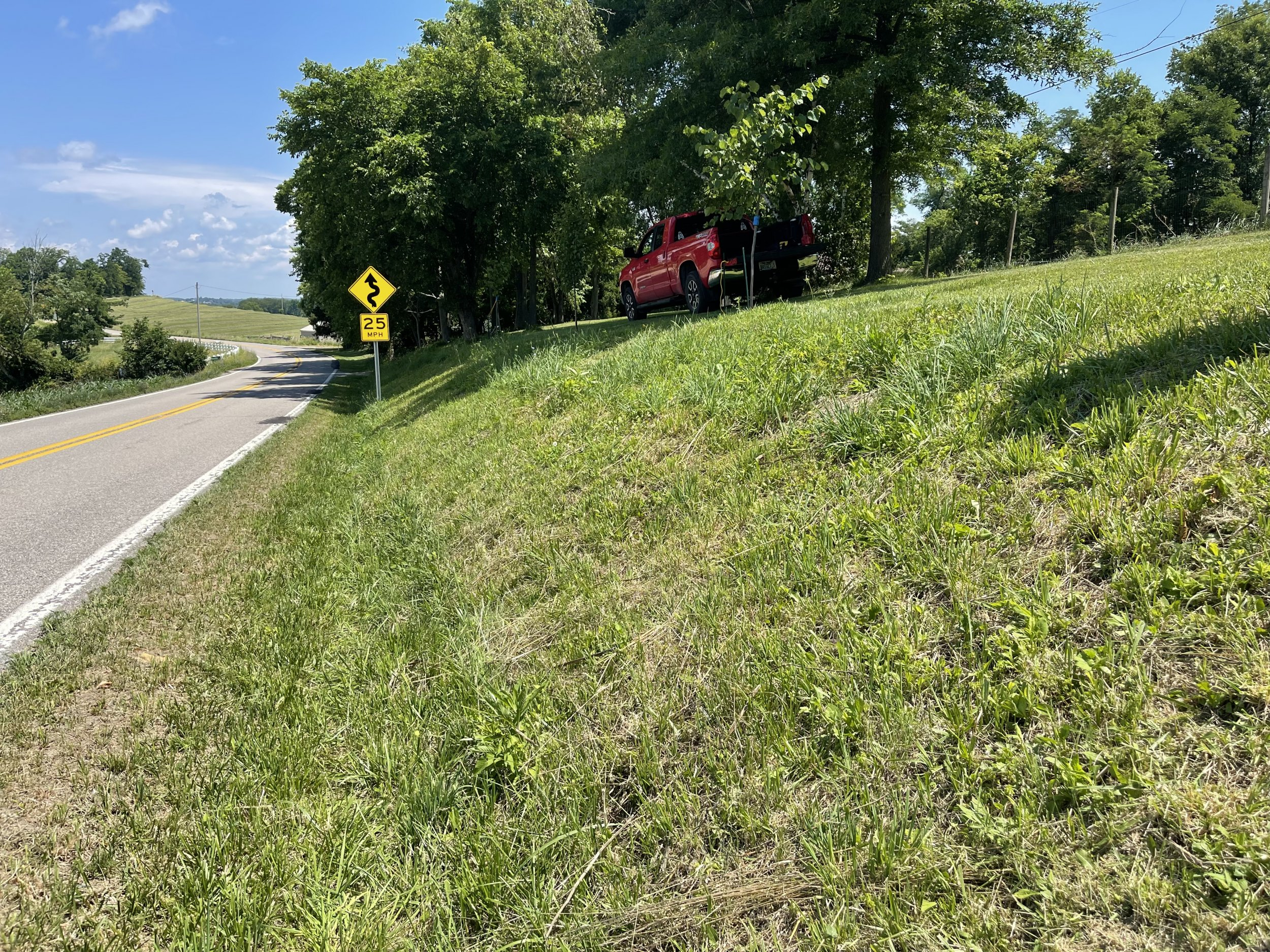

This hill is killing me. A little steeper than it looks. I have a JD 1023 - not enough juice for a boom mower or a flail. You can see I have easy access from the top. Been weedeating this mess for five years.
What if I took tow behind mower like you use with an ATV - hitched it to the back of the 1023 - and just backed up to the edge letting the mower drop down over the bank? Put a bit longer extension on it if I needed to. Then work my way across up and down. Is this a really smart idea or a really stupid one? I’ve been known to have both kinds.
I have mowed a slope that steep with my Deines front deck. I am not going to lie though - I did not like it. It was on a commercial lot I own and there was no good reason they left it so steep but they did and I chose not to change it - it was about three passes high and 100' long.
The thing i hated the worst was the feeling I was going to slide out of the seat so I got a high sided seat that I would not slide out of. The mower will not roll but will slide down the slope if it is too wet. I also changed mower tires to AT-101s versus the turf tread - they hold the sidehill much better. The third thing I did was lift the mower deck just slightly - not enough to actually lift the deck but to get a little more weight on the drive wheels or I would lose traction on the upper wheel and have to turn down the hill.
Another option that someone has mentioned is mowing at an angle. My mower may not climb the slope forward but it will back up anything i game to stay sitting on it for - so you can go backwards at an angle up the slope and forward down the slope. It definitely feels much better than mowing sideways but also takes longer.
Another option is a sickle bar mower that allows the bar to float up and down and then do one pass from the bottom and another from the top. The road sign will get in the way though.

I recently drove by a guy mowing a situation very very similar to this... He had a push mower with the handle removed, and a rope tied to the back somehow. He was lowering it down the slope and pulling it back up.
I didn't say it was a good idea, just something I saw, and me and the fellas in the car had a pretty good laugh.
