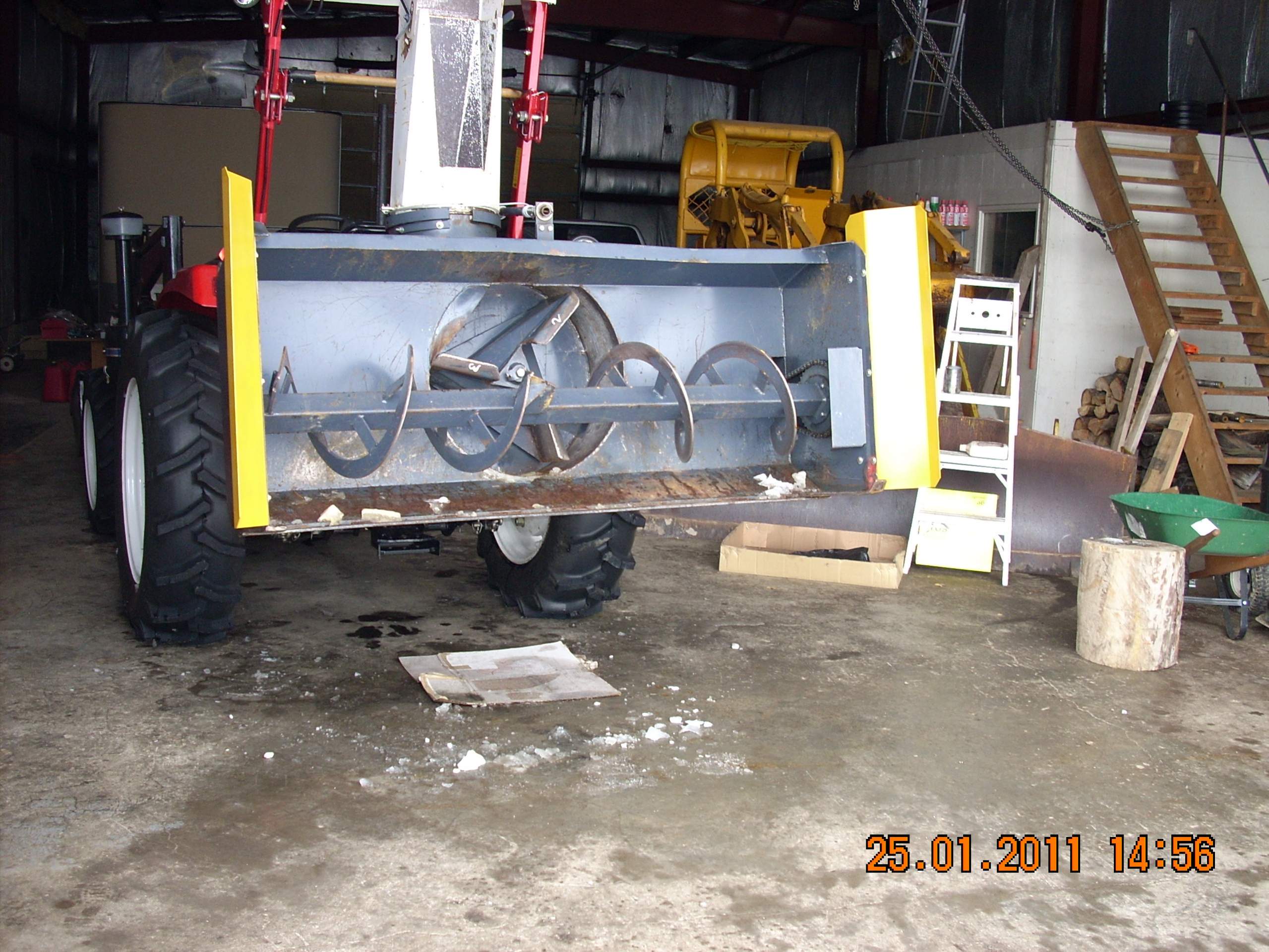

Here is what I did if it is of any help. My wings are three and half inch gain each side on the snow blower. I think any more than that will possibly too much - your call of course. For me my mods have worked quite well and the material was 11 or 12 gauge (0.110" thick) and cost $50 for the bent/trimmed blanks.
HTH

What you've done there is exactly what I have in mind. I have some 3/16th" plate that I can shear a couple pieces like that from. I'll have to find someone with a sturdy break to put the kinks in though. But first I'll have to get it and try it the way it is. It's that first pass through a hard drift like we often get around here that tests the mettle of your equipment.

I chose to go thinner than 3/16" so that the wings would be sacrificial - rather than the end plates on the snow blower.
I have bent two wings completely back when encountering something that didn't want to move - I suspect it was pieces of ice frozen to the ground (temps around -15C or lower).
Let us know how you make out at the auction and if you do buy, what the snow blower turns out like.
I would like to get a 7ft blower with a four bladed fan but good used blowers are at a premium around here. I would probably have to go to Edmonton to get a half decent deal :-( - some six hours drive each way !
