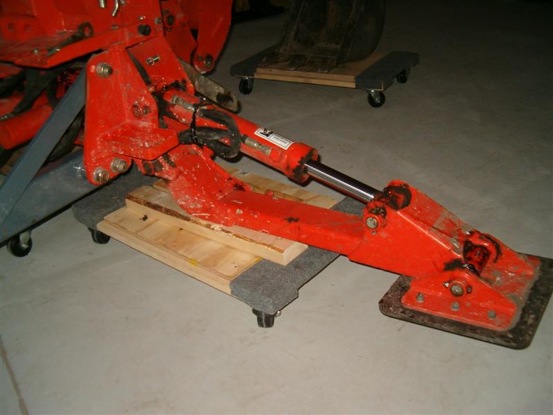

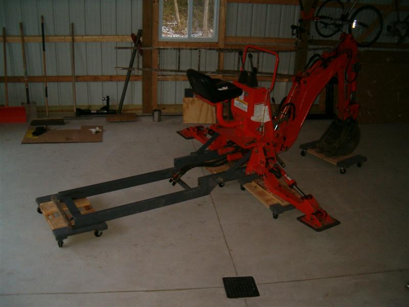

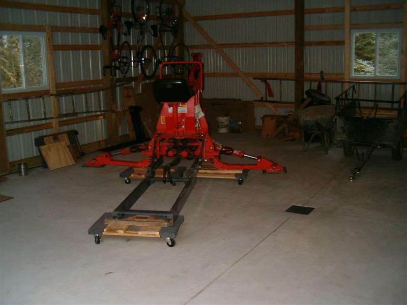

Good report. I took time to built a dolly to place under the main station area of the hoe so when I back the hoe onto the entrance of my shop bay I can drop it onto the dolly and move the entire hoe out of the way until I need to install it again. I am able to carefully move the entire unit by myself and that makes installation and removal/storage a fairly easy task.
Whatever one might use to move the hoe around CAUTION needs to be taken to not allow it to tip over - obviously, but that point cannot be over stressed enough!

Can you post a pic of your Dolly? Thanks
