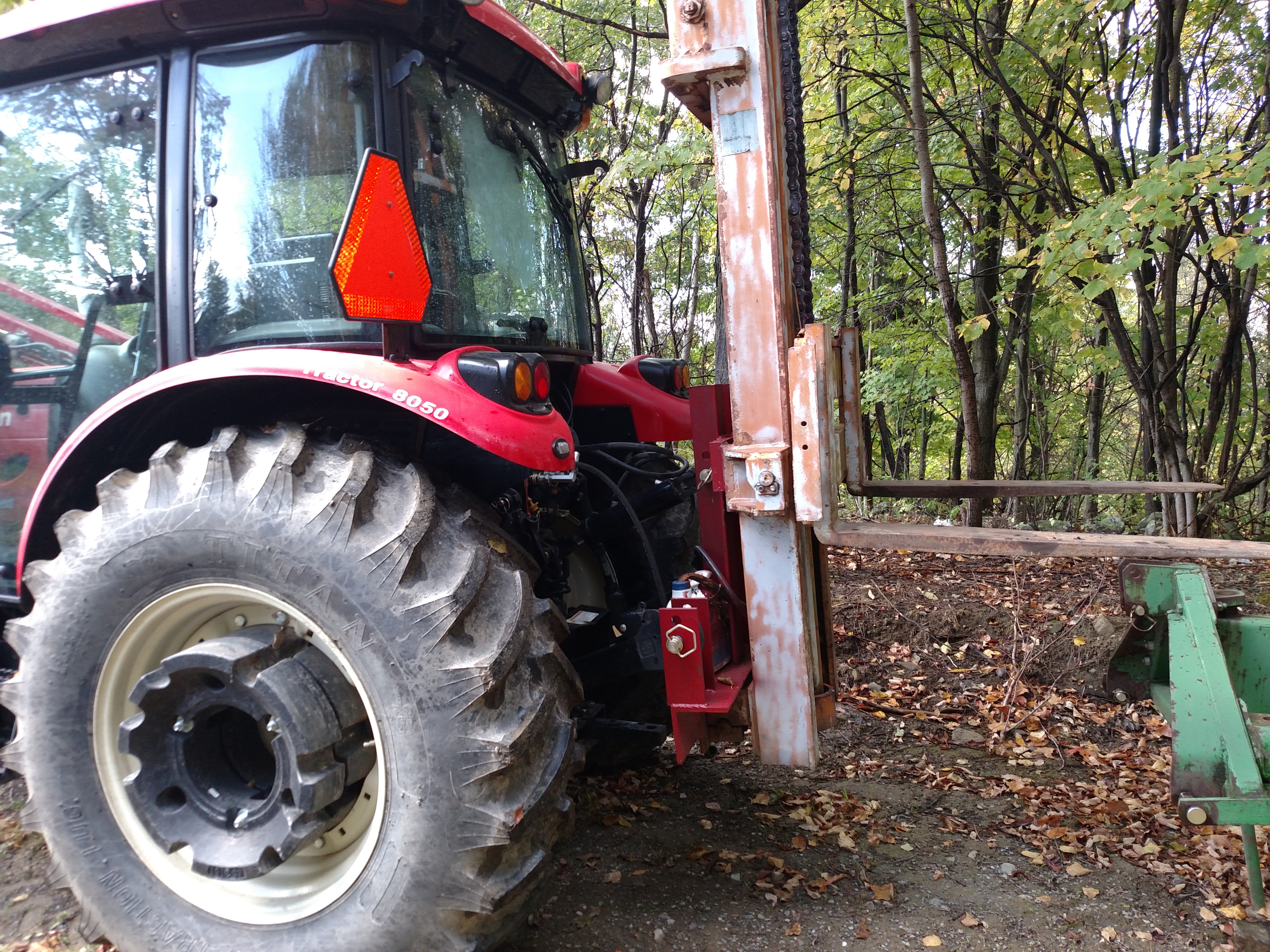

If you are using the clamp on forks on your bucket I believe that you will find the SSQD will be easier to see and work with
as your visibility should be greatly improved. That being said with the forks being out so far I have always found it much nicer to have someone
watching my forks and giving the correct hand signals for up down curl and uncurl as well as forward and whoops:confused2:
I use a set of front mounted often I also have a rear set that sometimes are nicer but not always.
