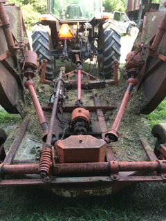

Found a Bush Hog 315. Called the company last week and he laughed.... saying they stopped making it nearly 50 years ago.
There is a twisted spline, current owner is in process of fixing it right now (I saw the new spline inserted, he had just not finished putting it in because I got there early)
The rubber "shock absorbers" are shot and he's got replacements for those too.
One of the wings had two TINY drips of oil, presumably coming from the bottom of the gear box. Looked like someone took an eyedropper full of oil and placed it there. It "ran down" about 10" and was stopped. No other visible wetness or accumulation of fresh oil there.
Anyway, it's for sale and he's asking $4,000 BUT, it's negotiable if it is sold along with their Allis Chalmers 6080...
The guy at Bushhog laughed again when I asked if it would be considered light/medium or heavy duty.... he said (paraphrased a bit)
"Son... back then everything was made out of real steel...... I'd consider that heavy duty....but realize some parts are going to be hard or expensive to come by...so if you buy it, I hope you buy it for a song & a dance"
He never clarified if he thought $4,000 was a song & dance...
Thoughts?

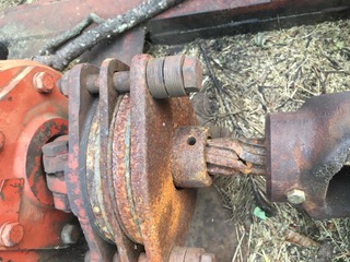

I think that you're going to want to loosen up the bolts on that slip clutch in picture 7 and make sure it can slip so as to avoid breaking another splined shaft.
Aaron Z
   / Thoughts on Bush Hog 315 (which I believe is 50 years old)
Yeah... I asked what they might have hit to twist the shaft. He said he didn't think they hit anything...but rather, forgot to loosen the clutch one spring and when PTO was engaged....
