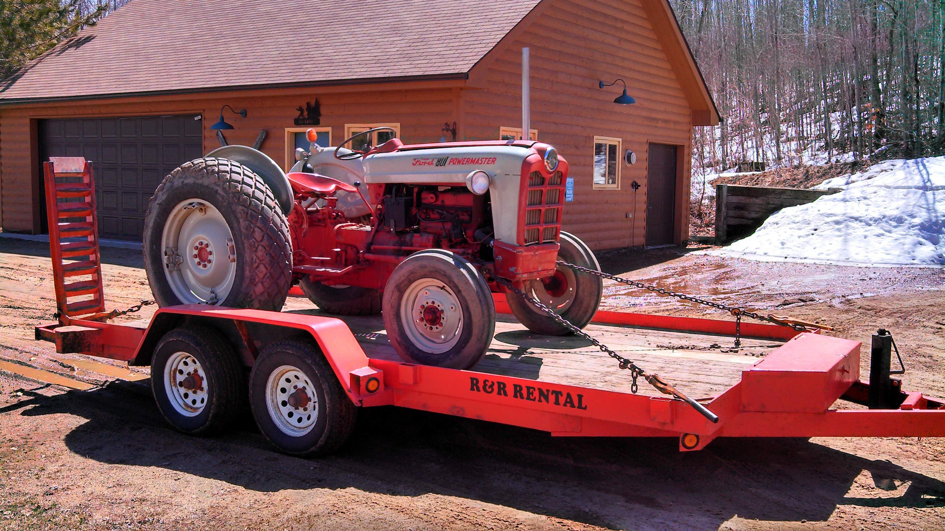

Hi!
Have been looking for a while and just picked up a Ford 861. Seems to be in nice shape.
I have ordered reprints of the owners manual, shop manual and parts manual. Is the IT manual better than the Ford reprint?
The owners manual lists straight weight oils. What do you guys recommend? 5-30?
The exhaust elbow off the manifold is cracked. New elbow on order. When I replace it should I used ss bolts with anti seize? Looks like it is going to be a real job to get the bolts off the elbow and elbow off the muffler.
Do you think it is a good idea to change out all the fluids? Any recommends on modern equivilants to the old lubes?
The old dear is in pretty good shape for being a '58. Proof meter works and reads 1300 hours.
Thanks!

the it fo-20 is a decent manual to have. IMHO.. not better than the ford factor shop manual.. however cheap enough to have both.
i run 15w40 s/c rated oil in most of my tractors. while 10w30 is likely fine on a decent red tiger.. the 15w40 is a superior oil.
for the rear sumps.. hyds, diffy and trans. you can run an 80w90 gear oil in the trans and diffy.. and a utf meeting m2c134 spec in the hyds. or run utf in all 3. many times the seal between the diffy and hyds leaks anyway ( pto shaft goes thru it. so you get co-mingled oil there anyway.
ALWAYS change fluids out of a new-to-you machine.
get some antifreeze.. green stuff is ok.. mix for your location. good time to change the thermostat as well.
I would not use SS bolts.. they gall and are harder to cut than a gr5. ( gr5 is what I'd use.. AND the NS )
points gap at .025, fire order is 1-2-4-3 plugs gap at .025 prefered plug among collectors is al437 though a 216 works..as do the champion H12 ( 512 ) and the oe heat range H10.
don't need any special gas addatives.. 87 octane is way higher than it got when new... and 'lead' tetra ethyl lead was primarily an octane mod anyway. ( ethanol happens to be an octane mod too... )

ps.. don't forget to remove and clean the oil bath air filter. it likes a diesel bath.. and crankcase weight oil in the cup. genny and dizzy have an oil dropper port on them.. and the steering box would love some lube. i reccomend 0 or 00 ep grease. jd cornhead grease is a 0 ep.. comes in a tube for your grease gun. cnh dealers sell an ep00 as well, pourable.. and manyy lawn equip dealers.. especially snapper.. sell a snapper or stens pourable ep 00 greease in a squeezy bottle.
pump in till it extrudes under the steering wheel, then you know the top bearing is happy.
check the pto shaft immediatly for thrust play in/out.. or side play.. if it has either.. pull it duiring oil change. 4 bolts..e tc. and renew the bearing and seal and check the bearing carrier to see if it lost snap rings or is damaged. liekly need a wear ring too. easy 30m job

Excellent info. Next time I am at the Lake (where we keep the 861) I am going to do a fluid change. I am kind of thinking just put utf in everything (except the crankcase of course), and some 15-40 for the engine.
Any thoughts on how to get that cracked elbow off the muffler? Penetrating oil?

penetrant oil helps. if it fights too much.. sacrafice the fastener. nuts and bolts are cheap.
nuts can be split and heads can be cut off.. grinder or even hack saw.
heads can be drileld.. etc.. etc..

I've run the tractor to get the motor hot then spray the penetrating oil. Heavy gloves keep the hands safe while its hot. They come out easier when hot.

Used the old girl yesterday for road grading and all is well. Could tell climbing the hills the governor opened the throttle, but it never opened it all the way. So power in reserve!
Got a new 5' rotary mower and got that all set up. Had some trouble getting the 3 point to carry the mower where we wanted until we moved the top link to the upper hole on the tractor.
The fuel gauge does not work, broken wire. When I hooked a wire from the sender to the gauge, it pegged the gauge on stop on the empty side. Bad sender?
The temp gauge does not work. Should I replace the gauge and bulb assembly? Or just the bulb?
Soundguy...there was no side to side play in the pto, and just the slightest bit of in and out play.maybe 1/32"?
The rest-o-ride must be done resting...pretty soft. Think I will have to get new bushings for that.
All in all, I am very pleased with the old dear. Some things to fix and maintain, but nothing major.
Your thoughts on the fuel gauge and temp gauge would be appreciated!

Ok...now I did it...went to put the new exhaust elbow on because old one was cracked all around. Got it off and put the new one one. Someone had converted the exhaust to a vertical. The muffler and stack pipe were fused together, so took off the bracket from the block, and took the assembly off. Got the broken part of the elbow off the muffler and new elbow bolted on the manifold. Went to put the muffler/stack assembly on and would not go on elbow. Inlet on muffler was deformed. Tried to straighten it out the inlet and flare it a bit. Got it started on elbow, but could not get the stack to clear the headlight. About 2" shy of being fully seated on elbow. Thought, "no problem, I can tap it on with a little help from a hammer".
You know where this is going...
Now I need a new manifold. Gonna get a new muffler also.
Got any places you guys recommend to buy parts? There a quite a few, but though I would see what you guys usually use for a source.
Anything I should be aware of when replacing the manifold? I know to use brass nuts, but anything else?

New elbows are actually a slightly larger diameter for some reason. Same thing a 2000 my son is working on.
   / Thoughts on Ford 861 #20
temp gauge and buld is an assy. can't replace them individually. at least not the mechanical ones. keep an eye on that thrust play. it should have 0 ideally. if it hit 1/16 i'd pull the pto..
