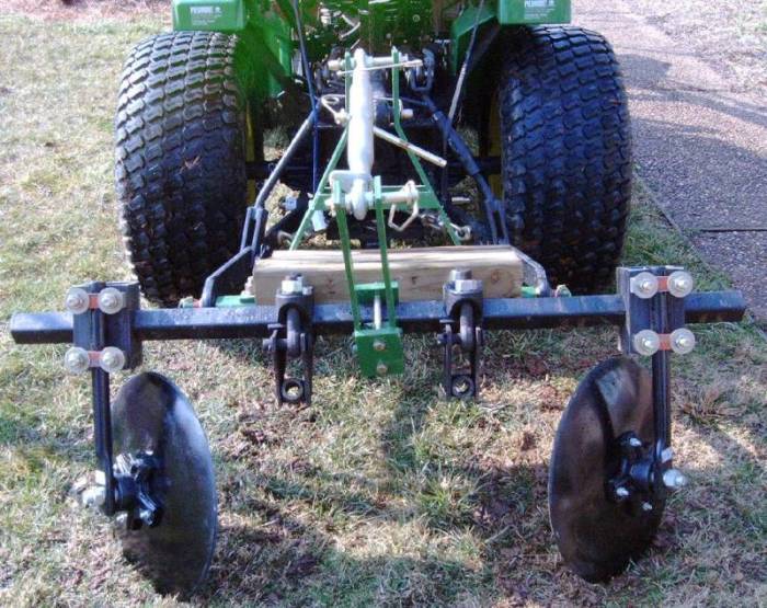

If you want to make raised rows, here's a picture of what I used on my JD 4010.
With the raised rows, I just mulch them and don't till them any more. I'm using buckwheat for a cover. It's easy to pull out.
You'll have plenty of trouble with weeds your first year or two.

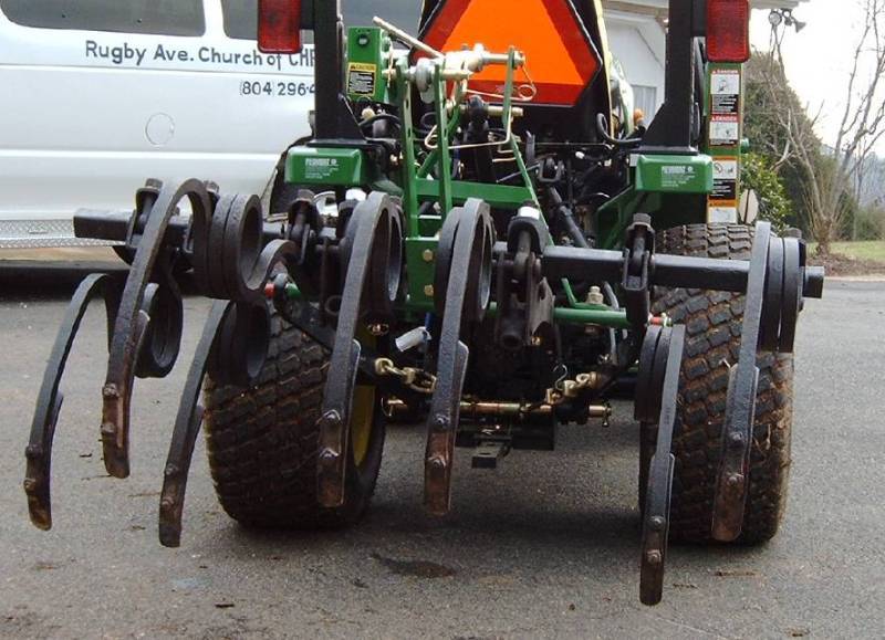

Oh, for when I tilled before doing the raised rows, here's a picture of my soil ripper from an old (18 hp) JD M converted to 3 ph. When I converted the fescue to garden, I used a Gravely rotary plow. Used it to make the initial raised rows.
